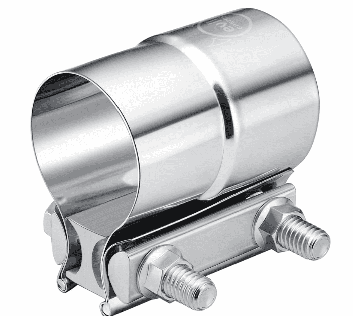

Also on TTI kits; I'm a fan getting stainless sleeve-type joint clamps for the straight joint sections and using them instead of the U-bolt clamps. They look 100x better with the clamp positioned on the inboard side of the pipe

Thx 4 reminding me of these! I need to trim up both of my tailpipes, and these sorts of coupler-clamps will do VERY nicely for that. See, my pipes were originally meant for a '67, but somehow got slightly botched in their bending, so I got 'em for a tidy discount. They worked OK on our '66, and excepting the left exhaust manifold-exhaust pipe flange on our '68 would have worked VERY well. Alas, owing to minor bending while on that '66 body, I tweaked the tailpipes out of their proper planes, and must cut and rotate them. Easy enough, but I then must replace the bent length, and couple things back together. These sleeve-joint clamps combine the two functions I will need.

I have those in a couple of Magnaflow exhaust systems for other vehicles. Those clamps are very nice.

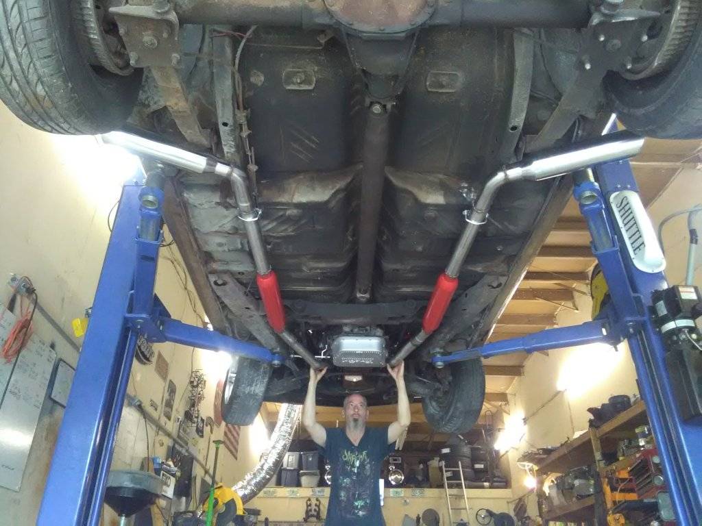

I personally bought a "Universal" STAINLESS exhaust kit off of Amazon, cut & trimmed it to my liking, hung it myself with clamps, spot welded them in place, THEN I went to a professional exhaust shop & had them thoroughly weld everything up. I have one of those cheap Harbor Freight 110v gasless wire feed welders but I am in no way, shape or form a "welder". My attempts at welding are scabby looking, lumpy and tend to be bubbly & crusty looking. I can do a quick tack weld to hold stuff in place, (which is why I got it) but my skills are nothing to brag about.
Six years later and there's no rust. Didn't cost me much and I'm pleased with the results. My setup isn't stock. I run shorty headers, glass packs and side exits angled out before the rear tires. My motor has a muscle car cam in it & I want to her it gurgle at idle, and that raspy sound at speed sounds SOOoo nice to my ears. It's not a traditional exhaust but neither is the car it's hung from. Purists be damned, it's MY car.

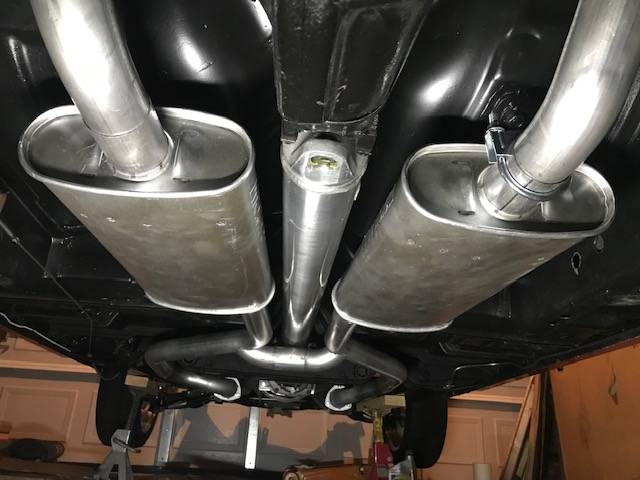

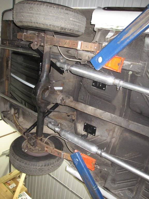

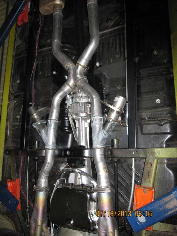

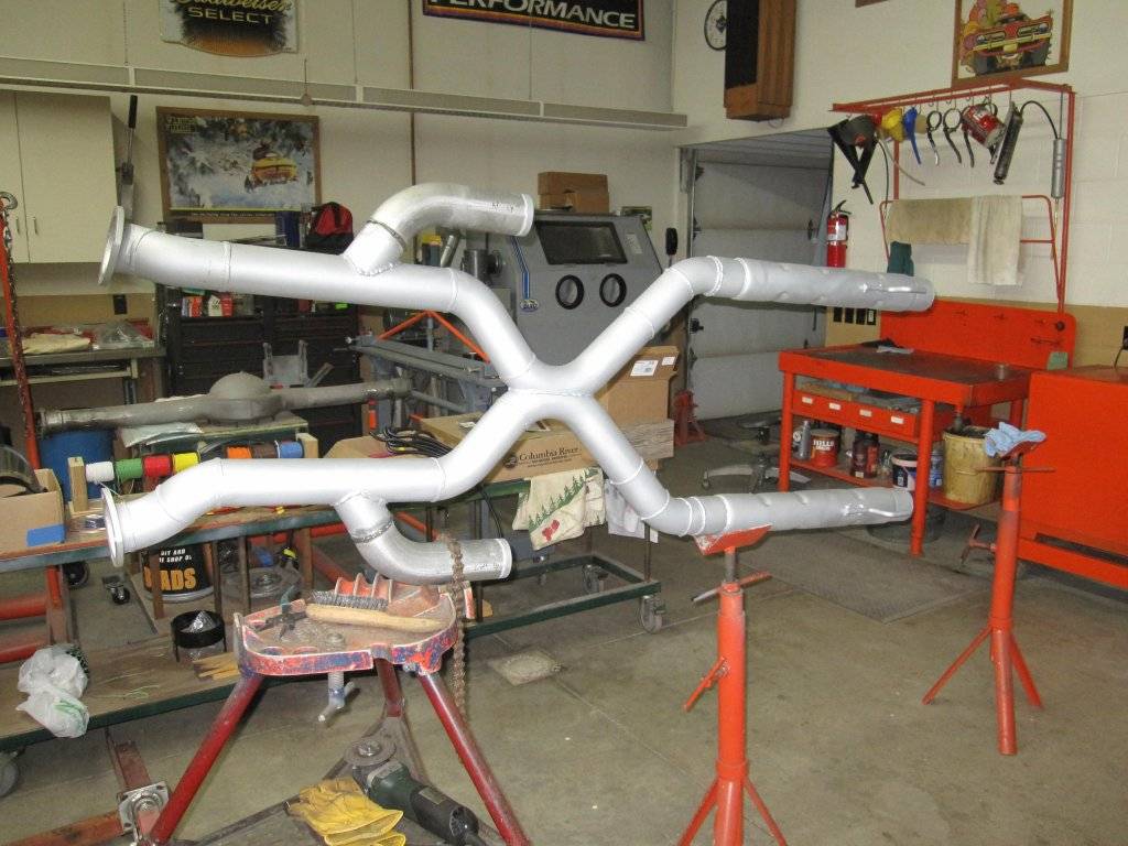

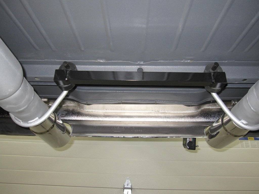

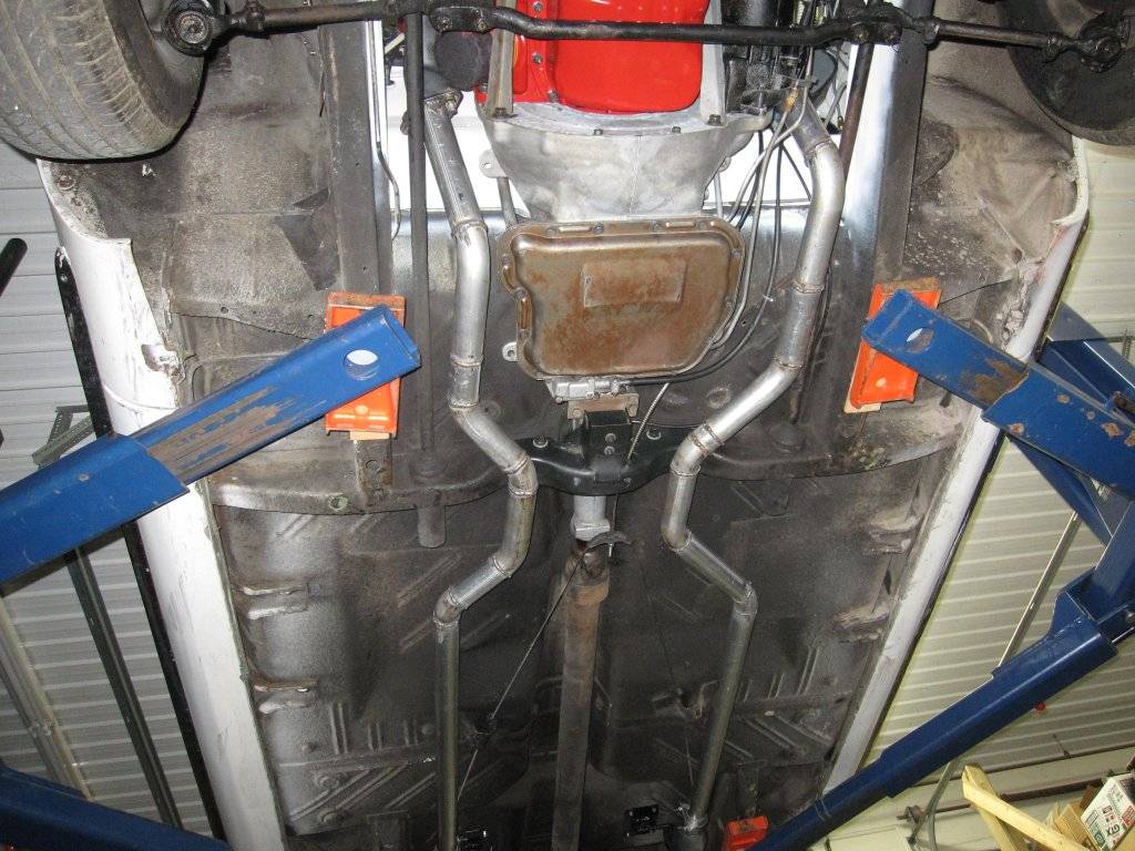

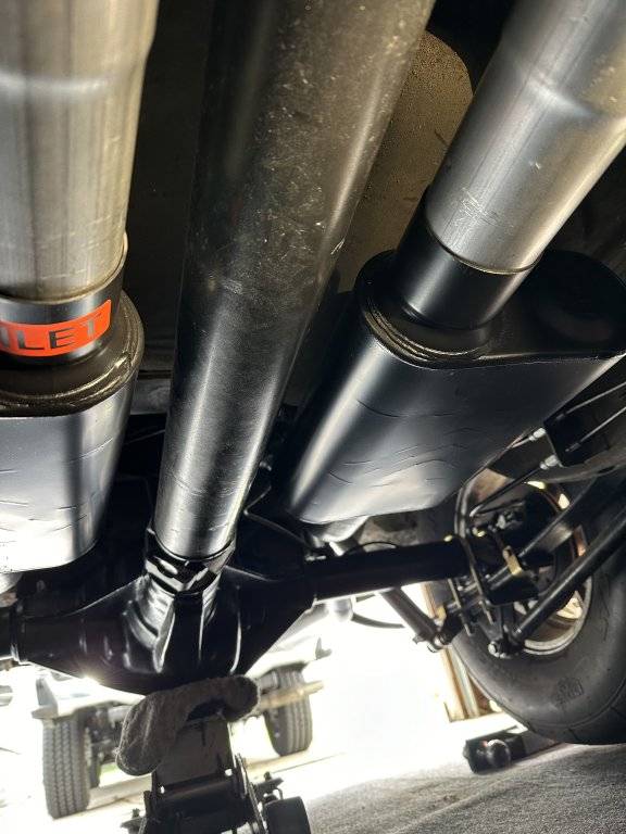

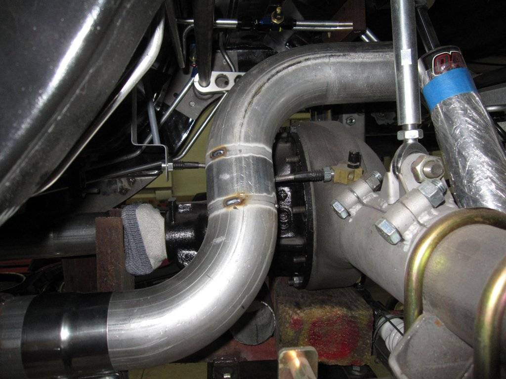

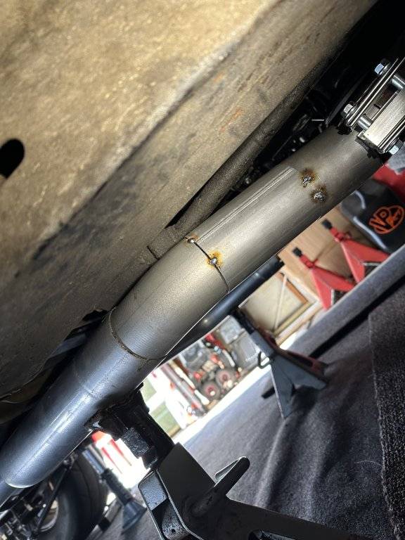

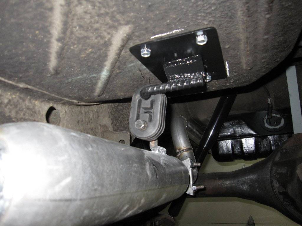

I prefer to build my own systems. Just purchase alumized pipe and bends. The only challenging part is cutting the bends correctly. These attached systems are 3" and 2".View attachment 714063View attachment 714064View attachment 714065View attachment 714066View attachment 714067View attachment 714068View attachment 714069

I'm assuming those are electronic cutouts you have added there? How well do they work and for how long? Does rust start to keep the motors from allowing the ports to open?
I prefer to build my own systems. Just purchase alumized pipe and bends. The only challenging part is cutting the bends correctly. These attached systems are 3" and 2".View attachment 714066

Is that a Gear Vendors overdrive? What has been your experience with it? Would you do it again? And what car is this beautiful exhaust mounted on?
