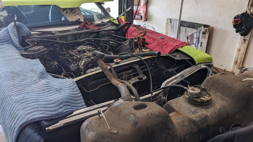

Thanks just got a 5.9 magnum installed in the fury and running on the factory EFI yesterday. Have the truck tank sitting in front of the car to make sure I wired it correctly.

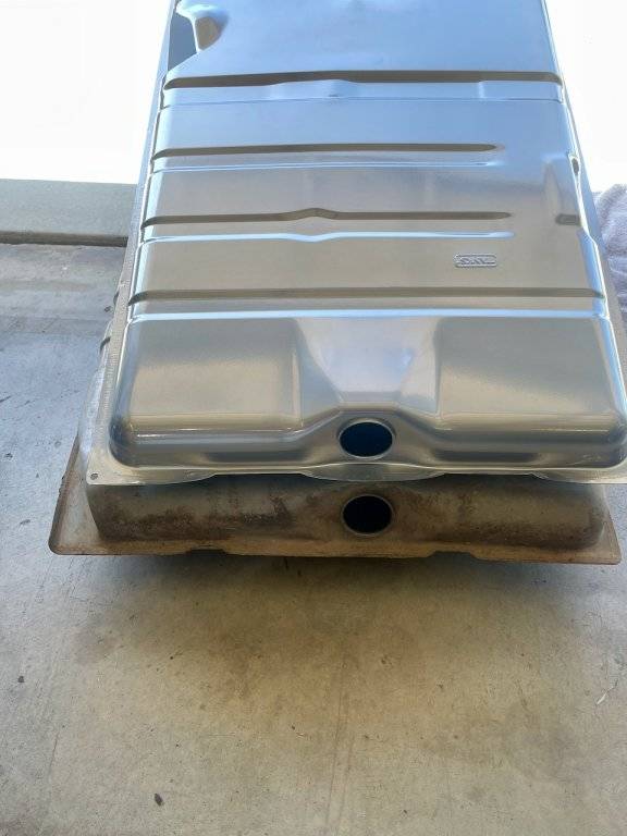

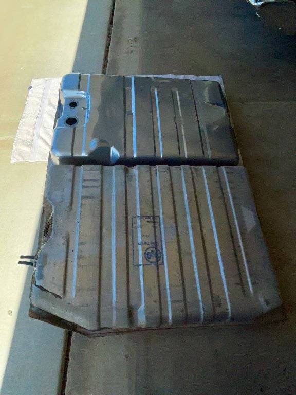

The tanks inc B-body fuel injection ready tank just showed up. First glance next to another 66 fury tank I have it looks very very promising that I will be able to directly swap the B body tank in with it being a little narrower. I will have some more free time tomorrow to take some closer measurements and set them side by side before going through the trouble of draining the gas out of my current tank and attempting to bolt it up for a final check. :thumbsup:
looking at the tanks next to each other I'm about 99% sure I can make this B-body tank work great. As I was hoping the filler neck location in proximity to the driver side of the tank is where the narrower width is made up which appears to be almost exactly the front factory tank corner cutout area for exhaust routing(should provide slightly more room for exhaust routing on driver side along the frame). Filler neck angle into the tank looks to be almost exactly the same as well. The depth of the new tank is just slightly less so I can place a thicker rubber mat between the tank and the underside of the trunk where it mounts to if needed to drop it down to the same mounting height for filler neck positioning. See pics for reference next to a factory 66 fury tank. It will be a few weeks until installed as I have to get the internal fuel pump, sending unit, and parts to plumb everything in to have ready once I get the tank in place. I will upload pics of the finished install once done
