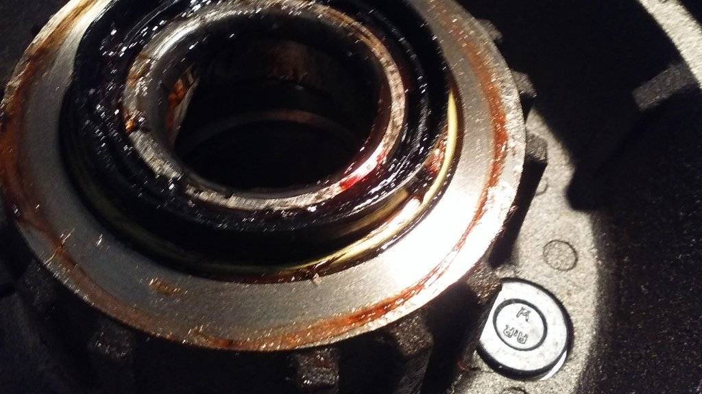

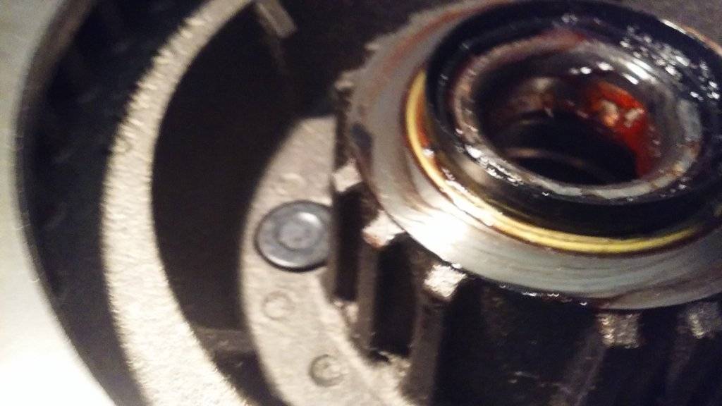

all the way in.....via BFA hammer and 2x4 piece of woodView attachment 76675 View attachment 76676
Here's a closer pic of inner bearings..I don't see them...sticking out of the race part?The bearing doesn't look like it's in there right in the lower pic. It doesn't look like it's in the race.

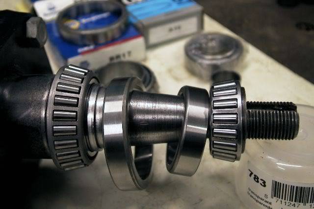

Yeah...I got what was on the parts list on the pdfYou do have inner bearing for 73 c body it is a one year only.
Now you've got it.
For future reference whenever seating a seal, I always use a section of pvc pipe of the proper diameter of the outer edge of the seal. I'm uncomfortable with using force on the inner edge. It seats evenly that way. You'll need to remember that when you replace your transmission seal...![]()
You can see the race, so the bearing isn't seated down against it.Here's a closer pic of inner bearings..I don't see them...sticking out of the race part?View attachment 76683
No...it cant go in backwards...it has an angle to it..Is that inner bearing in backwards???
an individual race came with each bearing. The rotor already has a race machined into cause the outer bearings would not fit in it.The inner race came pre-installed, right? Like the outter?
