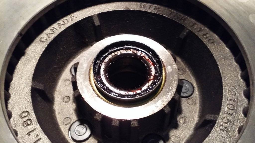

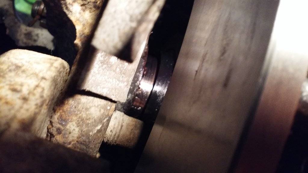

In the first picture, the bearing is not all the way into the race. It's hard to tell from the pic, but I think you have it in backwards.Seal installed w/ inner bearings behind it ...(and no race).....the outer bearing isn't on yet, but it doesn't look as if there is enough spindle length left for the outer bearing and castle nut to be situate behind the cotter pin
And you should not even see the bearing with the seal in placeIn the first picture, the bearing is not all the way into the race. It's hard to tell from the pic, but I think you have it in backwards.
There ya go...Give me your number...
that's exactly how they went in...the bearings will not fit reversed.![]()
Note how the taper in the inner wheel bearing faces.
Then something else is very wrong. The bearing should seat down in the race and from that picture, it shows that it's not.that's exactly how they went in...the bearings will not fit reversed.
