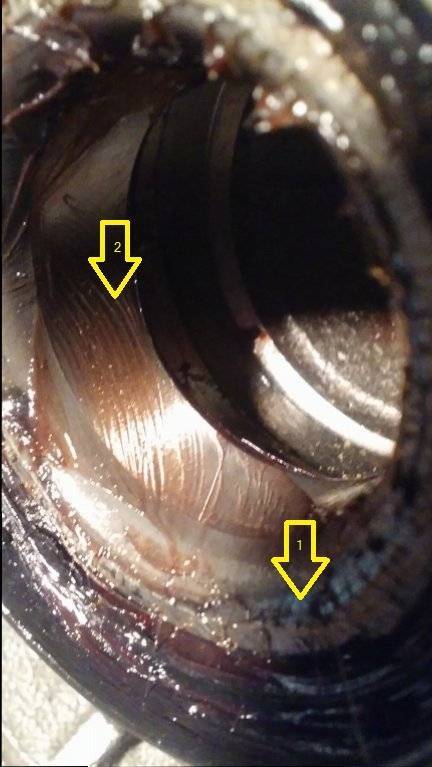

It seems the rotors came with the race for the outer bearings already machined into them. The race that came with the outer bears (smaller diameter bearings) wont fit with the bearings into the hole.
And the inner?
And when you say "rotors came with the race for the outer bearings already machined into them", are you saying it's only machined smooth or there is a hardened race pressed into it already. Like said above, the races have to be separate pieces from the rotor.
It still looks like you've put another race in on top of the inner race that was already in the hub. Have you???
You really need to answer that question.
BTW, the races are pressed in... not machined in.
an individual race came with each bearing. The rotor already has a race machined into cause the outer bearings would not fit in it.
I don't believe mfgs machine race's or cups into rotors. You say the race did not fit? They don't just slip in, they're a pretty tight fit. Did you have to install the race for the INNER (rear) bearing? From what it looks like in the photo in #415, it appears the race is NOT SEATED 100% all the way down flush. If that's the case then the rotor is NOT installed all the way back and also the reason why your OUTER bearing is sticking out so far.
You have not done the other side yet, correct?
Show us CLEAR PHOTOS of both sides of the rotors hubs - CLEAR LIKE YOUR #417 photo.
Sharp, focussed, well lit, no shadows, grease free close ups please of the other rotor hubs, inner and outer.
Remove the rotor, wipe off all the grease so we can see clearly...
BTW, did you install the INNER bearing B4 you installed the seal?
Perhaps you installed the seal then just put the bearing on top. If that's the case the bearing is not even resting on the race...
It either came with BOTH inner and outer races INSTALLED or without BOTH races installed.
It can't be one without the other.
1. Rotor w/ "inner" bearings removed (race part is still inside the rotor)
2. w/ bearings installed in rotor w/ race.
3. Position "inner" bearing will be in on spindle when installed.
Yes/No??
Are the "outer" bearings (along with its race piece) dropped through the hole into the rotor? and THEN rotor slides onto spindle???
It looks to me like you've put a second race in on top of the race that was already pressed in the rotor.
The race you put in there will have to come out.
Yep. One race stacked onto the other which was already there preinstalled.
Good thing we caught that.
You should be good to go after that, Gary. :thumbsup:
