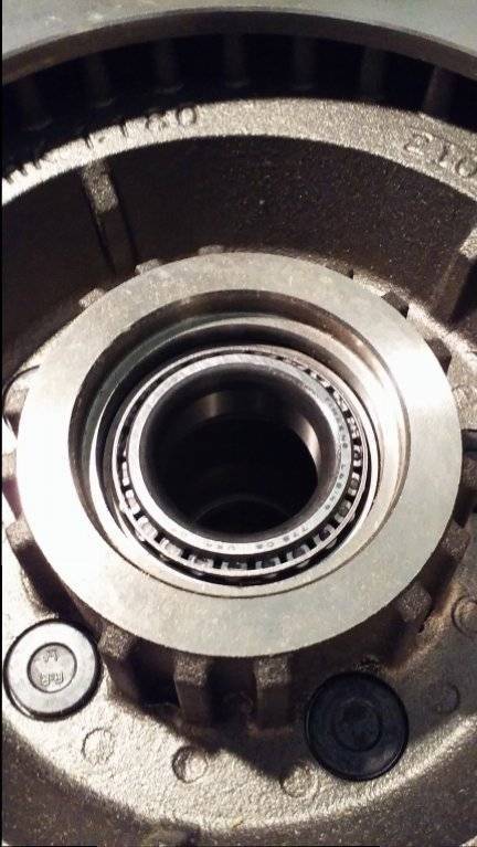

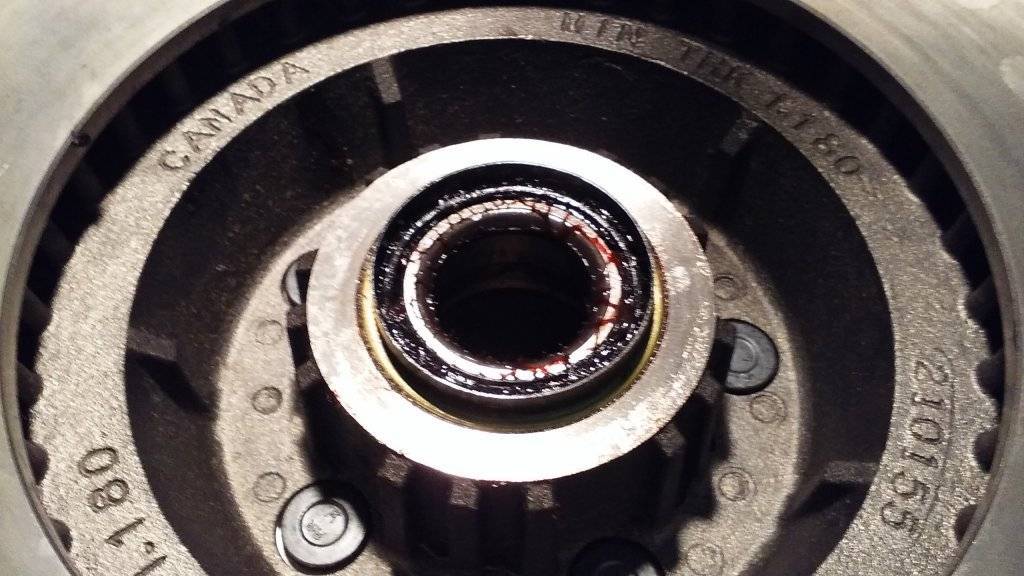

See the difference in heights?
Quite honestly, the top still looks to me like it's in upside down.

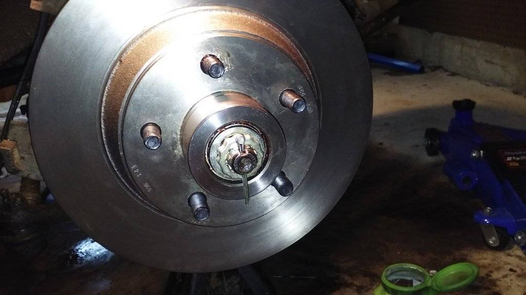

Done. Pulled out one of the races that came with the inner bearings that I had put in when I initially started this.....I didn't realize it wasn't needed until after I already had put it in. Good to go.

  7. I then had him take the questionable rotor and install it on the mock-up. Rotor would NOT slide all the way down completely.
  8. Asked him to take the questionable rotor, lay it face down, remove the seal, remove the bearing, wipe off all the grease and lay both rotors side by side and text me a photo.
  9. I called him back and asked .... what do you see different?
  10. Hey says, "O-O something doesn't look right"
  11. After adamantly saying he did not install race upon race.... it ended up he did Big_John LOL!
  12. Told him to remove the 2nd race and check if the original race was still in good condition. He removed it texted me a photo and all looked good. Called him and asked to run his finger along the surface to see if he could feel any imperfections. NONE!!! No replacement needed..
  13. Told him to lay the bearing back in the questionable rotor, take the remaining new seal and install everything like the mock-up.
  14. The next post we should hear is.....
Yeh thanks once again Steven (and all)........not doing this drum to disc conversion job ever before I had no clue I wouldn't need the races that came with the bearings...but its all good now. Drivers side should be a breeze now.
