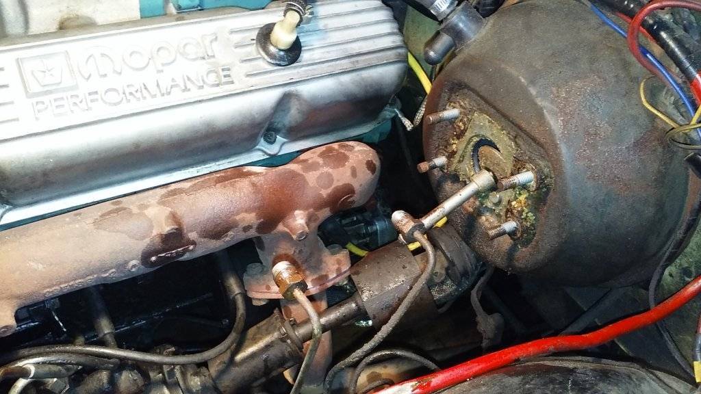

New MC is about maybe a little over a 1/3 larger than the old one.......(one hundred percent cleaner tho)
TRUE! good idea! Ive all but squeezed half my body under the freakn hood trying to get to that sumbitch.
Ugh...wut a nasty mess that was in there.....View attachment 76967
With the way the inlet of your booster looks hopefully none of the fluid leaked into the diaphragm. My booster began leaking just prior to my doing the disc brake conversion and when I took the master off it looked very much like yours. Unless you're going for the dual diaphragm booster, IMO I'd get that one rebuilt. Besides, if it's the original it's 46 years old.... just sayin'
I could get a new one...no problem.....BUT from what I hear its a REAL ***** to install one of those. Don't know if I'm up to it...might be getting in over my head with that.
Compared to what you just went thru with the spindles, the booster and master is a piece of cake. Do it, do it.
I may have scared you off earlier, Gary.
It's only 4 nuts you have to get at under the dash. The hardest part is finding the right combo of flex sockets, extensions, flex joints, and ratchet to get at them.
Personally, if you have the money, and the time, absolutely go for a new booster. It's a simple process. 4 nuts. Getting at them nuts is a *****.
Fuggit. Do it.
"The hardest part is finding the right combo of flex sockets,extensions, flex joints, and ratchet to get at them"....
THIS is the part that scares me
If you take the front seat out, the job will become much easier.
