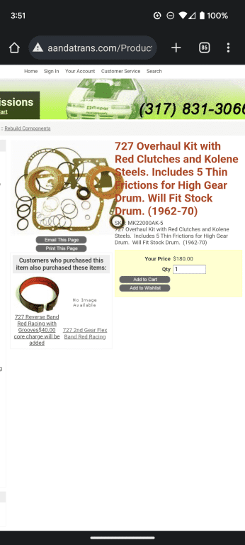

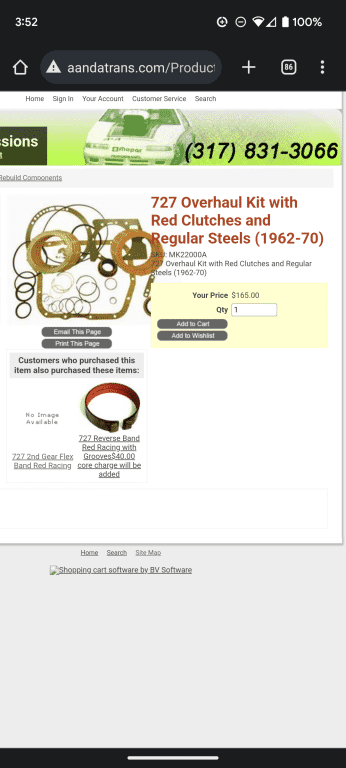

Ok, so I took a look at A & A transmission website, there seems to be a rebuild kit with kolene steels, would you consider getting individual transmission parts or an overhaul kit?

I would recommend that you call A&A.
Yes, rebuilding a transmission is a lot like rebuilding an engine. However, you want to leverage from their tribal knowledge, which can’t be captured (ok, rarely) on a website.
Yes sir I'll give them a call.
Hard to get a "kit" out of A&A. Their kits are race transmission refresh kits. Do not use Kolene steels in a stock rebuild.

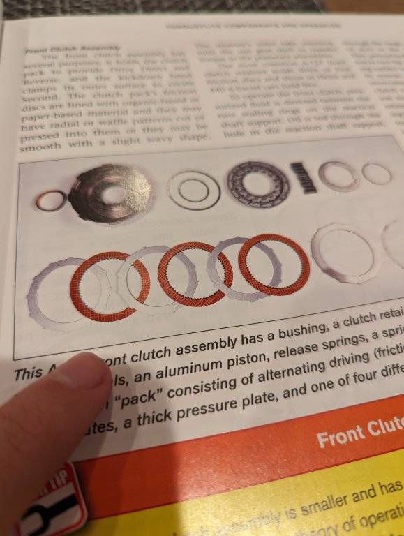

Were these the "waffle" clutches you were referring to?
They are pretty much all waffle, factory design. There are smooth clutches that work with the Kolene steels, ideally more friction surface on the steel because you eliminate the waffle grooves, you need more pressure to engage them with no grooves. Do not use smooth clutches, you would have to look for them.
I can't remember exactly what Kolene salt bath does to the steel, you can probably Google it. I know Kolene flake is hazardous material to haul, and pretty nasty stuff according to the guys at the mill.
In a word yes those are waffle clutches.
