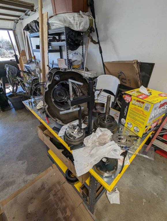

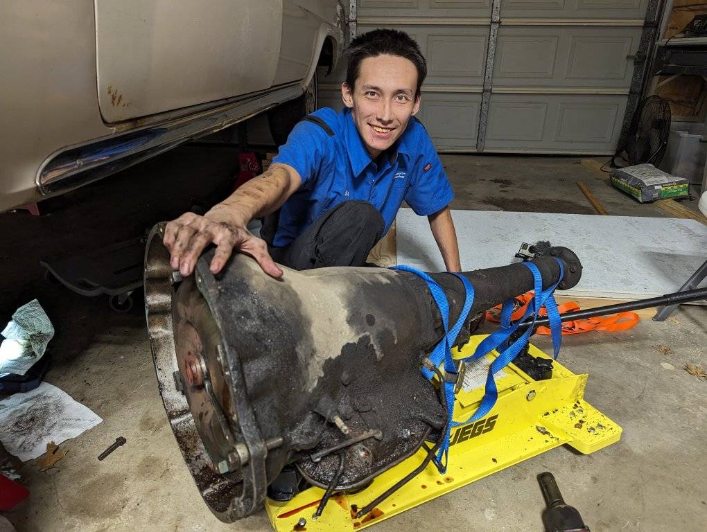

So I've got around to partially disassembling the transmission. To my untrained eye, Things don't look good in here.

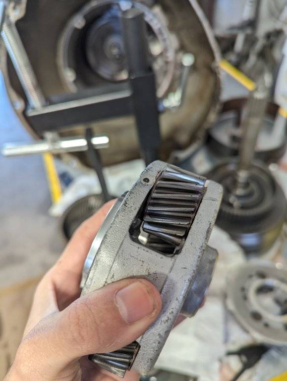

Both front & rear planetaries have nicks and a consistent scratches on the gears.

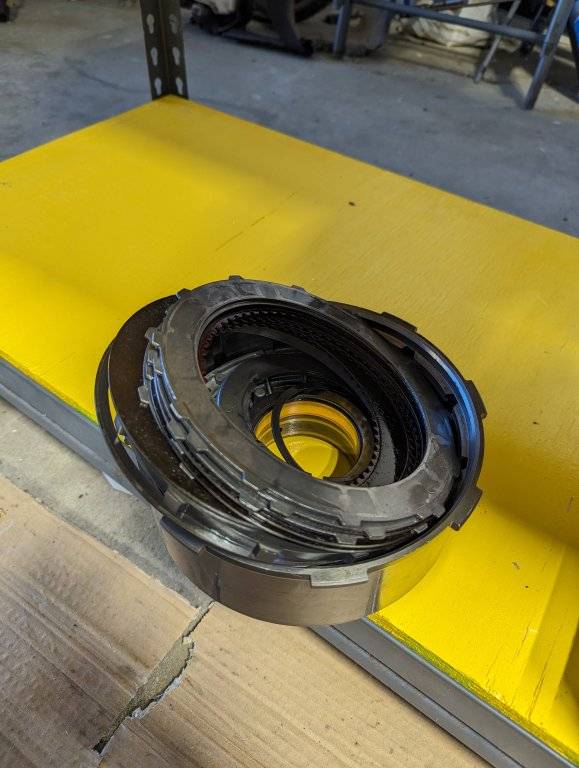

There was a thrust washer missing, and someone has stacked a steel driving disc against another driving disc, not the clutches but the steels. To my knowledge, there's an extra clutch steel discs in the front clutch pack.
5 instead of 4.

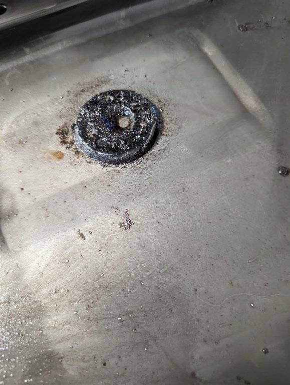

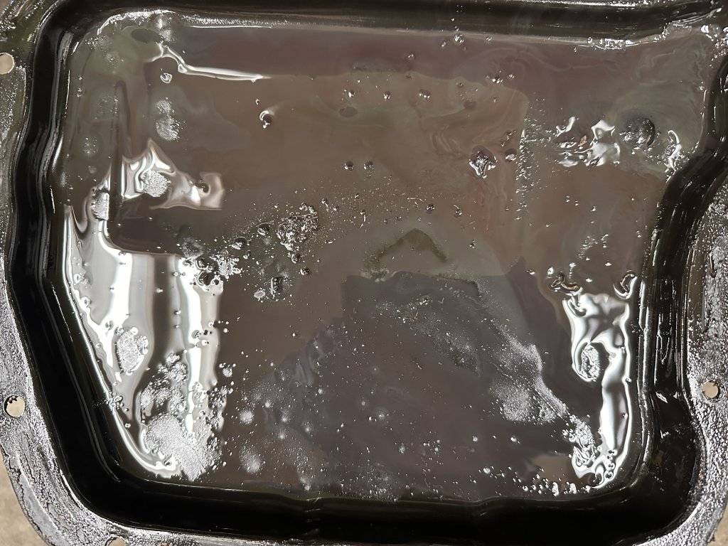

The pan magnet I had installed has a lot of goop on it, and the pan has small metal shavings.

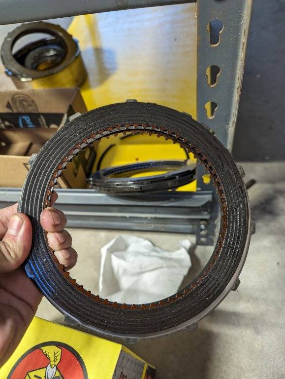

The rear clutch drum clutches had different clutch patterns, circular! I've never seen that before.
Still plenty of life in the rear clutch drum clutches.
Nasty gash in the front planetary, pointed by the finger.

Those planetraries should be easy to source if you need to replace them. I probably got good used ones.
Yes I considered salvaging what I can reuse, but according to the rebuild book by: Tom hand
*If the planetary gears are damaged, the sun gear is damaged also*
I might just do a bare minimum upgrade to a 4 pinion planetary from Cope transmissions.

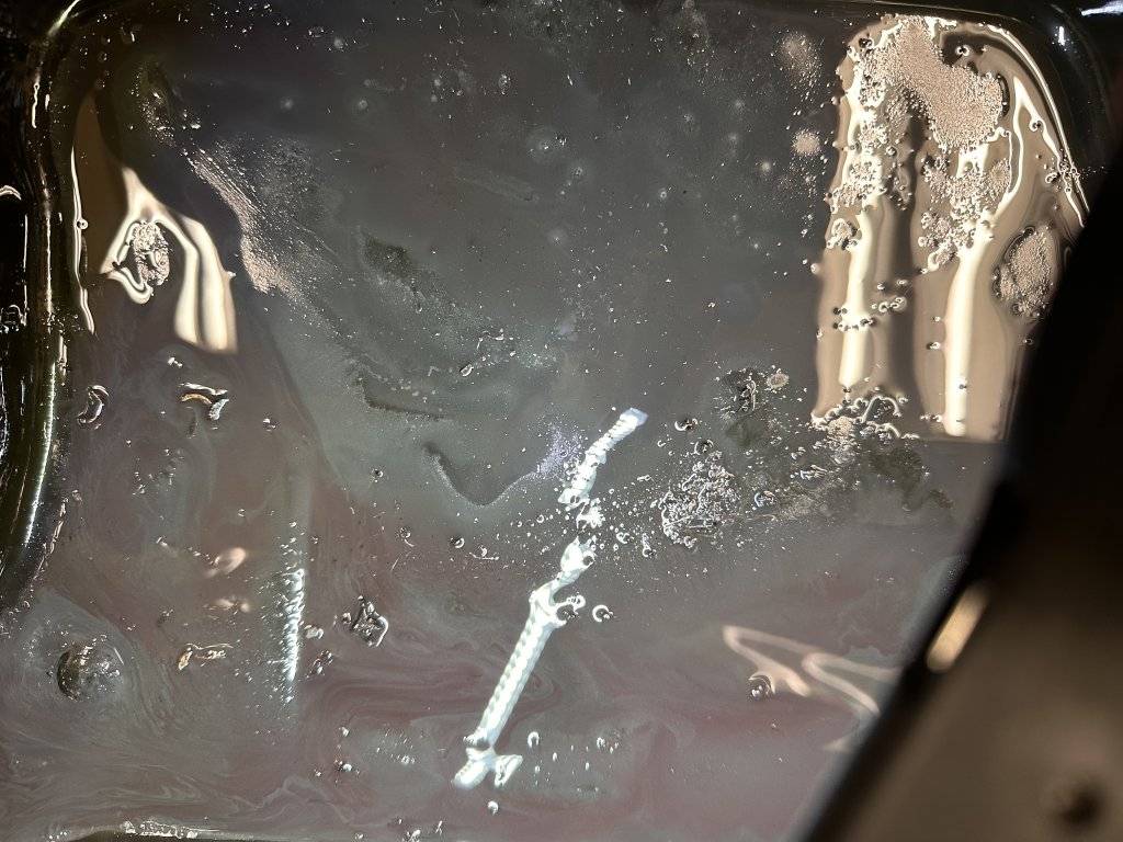

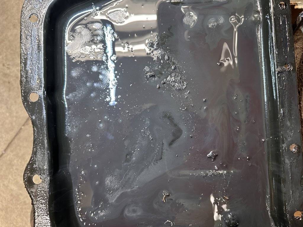

Have you had that pan off before? If so how many miles since the pan was cleaned out? I have opened plenty worse transmission pans.
Regarding the how many miles ago the pan was dropped, I can't say for sure since my Speedo is busted, along with the odometer.
I was daily driving to college back and forth maybe 2 times a week, 1 way 16 miles, so 64 miles per week, but I had other errands I was doing
(groceries and visiting friends and whatnot)
So maybe 11K miles per year?
And I've been going to college for about 5 years so it comes to around 55K miles, yup I think I got good miles out of this transmission.
55k on that pan, looks like it has dropped all it was going to. Thats pretty good looking.

You know I'd tell you what, I think the trans would have dropped "everything" without my intervention. The trans was making a horrible noise. Glad I did that before it got to that point.
