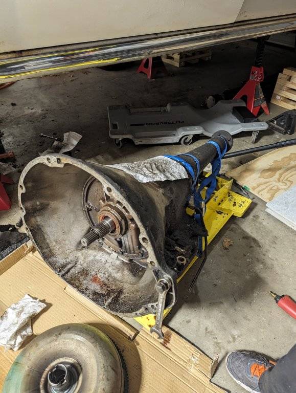

Gearvendors won't work with a pushbutton TF unless you were to go with a divorced unit which I don't think would be practical to do in a unibody car. On a truck or full frame car you can hang one aft of the trans like a hanger bearing and use a 2 piece drive shaft.Thanks to all who have chipped in, will go about things once the ball starts rolling!
Also I did forget to mention.
I'll read through the books and get aquatinted with the various parts that reside below the transmission tunnel, I was considering Carl munroe's book a while back. I'll just get it, since more information can't possibly hurt.
I did consider getting a 2.92 or 3.23 gears and add an Gear Vendor overdrive, but unfortunately it might not be in the budget, but we'll see.
Consensus is the 2000 RPM converter is the "neighborhoody" choice to go with.
More on later if able, appreciate the information so far gentleman.
Hello there.Gearvendors won't work with a pushbutton TF unless you were to go with a divorced unit which I don't think would be practical to do in a unibody car. On a truck or full frame car you can hang one aft of the trans like a hanger bearing and use a 2 piece drive shaft.
Rick Allison does offer a conversion kit to adapt your typewriter shifter to a 66 and up trans if you did want to do the unitized GV.
As to your torque converter choices, swapping in the 67 and up input shaft and front pump assembly into your transmission opens up a world of more economic choices. There are choices for the 19 spline trans but they are $$$$ compared to the later trans and good luck finding one in stock anywhere.
