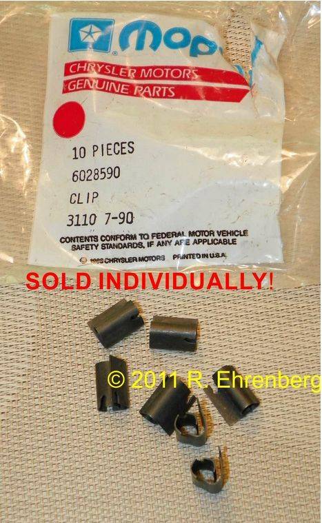

Anybody know where i can get that little tab for the heater cable? It's made to adjust the heater cable and slips over the post on the valve or damper. It's black and made of spring steel. Seems I didn't get it with the cable
Can't figure out what you are referring to.
Can you draw an arrow to what you are looking for?
Are you talking about this little fella?:
If you are, I don't have an extra, BUT, they are also on many of the heater controls which are super cheap on ebay. There are different styles so make sure the seller shows you a pic of the clip. Lance sold his NYB so he's selling off all his NYB hoard. I pretty much picked him clean but he still has.a bunch of heater controls. I won't have to deal with Murray Park for a long time, I hope.
OR just get one of these at the hardware store:

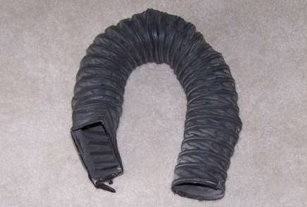

Does the drivers side duct go under the steering column or over?
Over.
When in doubt, EVERYTHING goes over. Royal PITA !!!!!!!
That one single $%#@-ing duct prevents you from accessing everything under the dash on the driver's side. I'd leave it off, block off where it attaches from, and it will allow higher flow from the center outlets. You'll thank me in the future. You've been warned.

None of those clips. It goes on the end of the cable on the flapper door. It's the cable connector to that little lever on top of the box. You fine tune the cable there
I still don't know WTF you are referring to. :BangHead:
A:
Or B:
Or C: None of the above. point an arrow at where you are talking about:

Yeah I figured that;s where you meant Stan. I can slip a piece of fles over that.
To answer your question Drawing A
I thought there was a little spring steel clip on the cable to adjust it. That little loop won't slip over the post on the door lever, I thought the same thing you are. The cable can be adjusted in 2 places. I have a solution for it, but if you sat nothing is there than maybe I am full of it. (Shad app You!)

If you can dig up a B-body distribution hose, uou can elliminate that fixed molded plastic duct permanently.
Using this flex hose, you can easily slip it on and off when you need to work under the dash.

That hose is kinda what I was thinking of.
