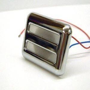

Why Sortinly! Tomorrow I put the lower valance in after I connect a couple ofthings like the seats, tach, Air fuel meter, and run power to the window switches. The valance will take little time to do.

Last major item is the window switches, some gauges and the warning lamps I am installing for the pooter system.
