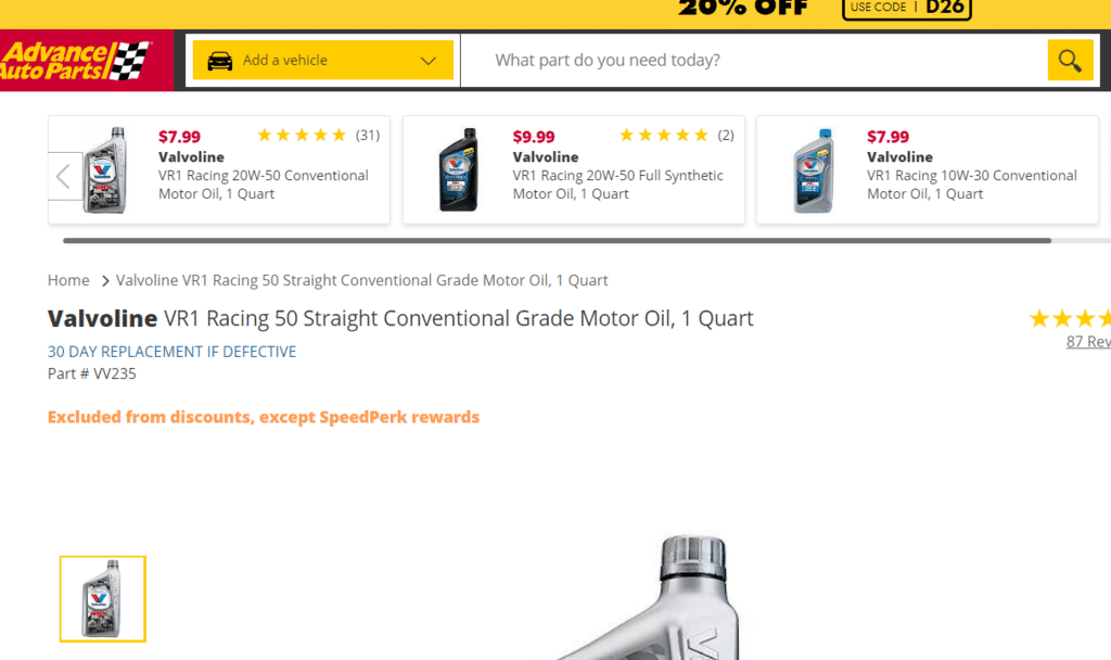

I thought so too, but I think the 50W had the highest zinc content. It also was the only stuff on the shelf WITH Zn when I went looking about 6 weeks back.
https://shop.advanceautoparts.com/p...zpvI40JZNK9OAOEPdksaAkWvEALw_wcB&gclsrc=aw.ds
I wouldn't mind using the 10-30W stuff, if the Zn content is still over 1200 ppm.

Your link has it available through advance. I get mine at Oreillys but they rarely have a full case so I just get them to order a case for me.
Unless something has changed all of the VR1 oils are ~1400 ppm.
