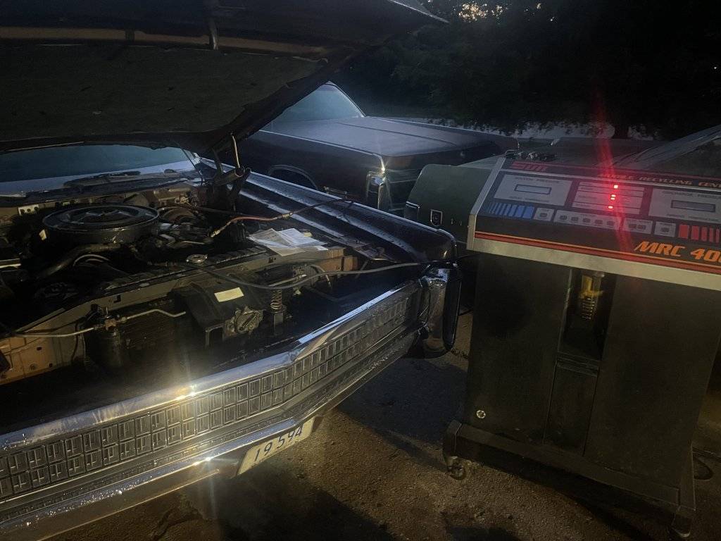

So the original compressor was long since replaced. The new one that was previously installed leaks like a sieve. I guess that makes another compressor to rebuild…
Well . . . in addition to the 5-cyl Sandens which everybody seems to use, even in OEM, there are also 7-cyl Sandens that look similar to them AND have a displacement of just over 9CID. The GM A-6 is a 10CID compressor.
Consider that almost every newer car on the road is cooled with a 8CID compressor, with a massive condenser, and a much-better insulated cabin (as to temperature), which can also make it quieter.
Chrysler went to a Denso axial compressor in 1980, still with R-12, I believe. On my '80 Newport, it chunks ice cubes after a few minutes of running in TX July heat. After sitting on a parking lot, in the sun, all day. Works better than it should. Never know with it cycles, either.
Get the full Sanden kit. Sandens, individually, might be higher when purchased from an "a/c parts vendor that deals in "old cars", BUT can be less expensive when purchased from other places. Check out the thread from "TXDon" on converting his '66 Monaco wagon over to R-134a and a Sanden.
As great as the old RV-2 compressor was, it IS heavy and loads the motor more than a newer compressor that can cool just as well. The key is a smaller pulley on the new compressor, to spin it faster to compensate for the smaller CID number.
There are abot 15 "backs" for the Sandens, although almost everybody uses the "bug antenna" fittings. I never liked those fittings either, but there is also a "GM back" that has the piping coming in horizontally, too. Mist some satin black on the compressor/pulley and it can easily "hide".

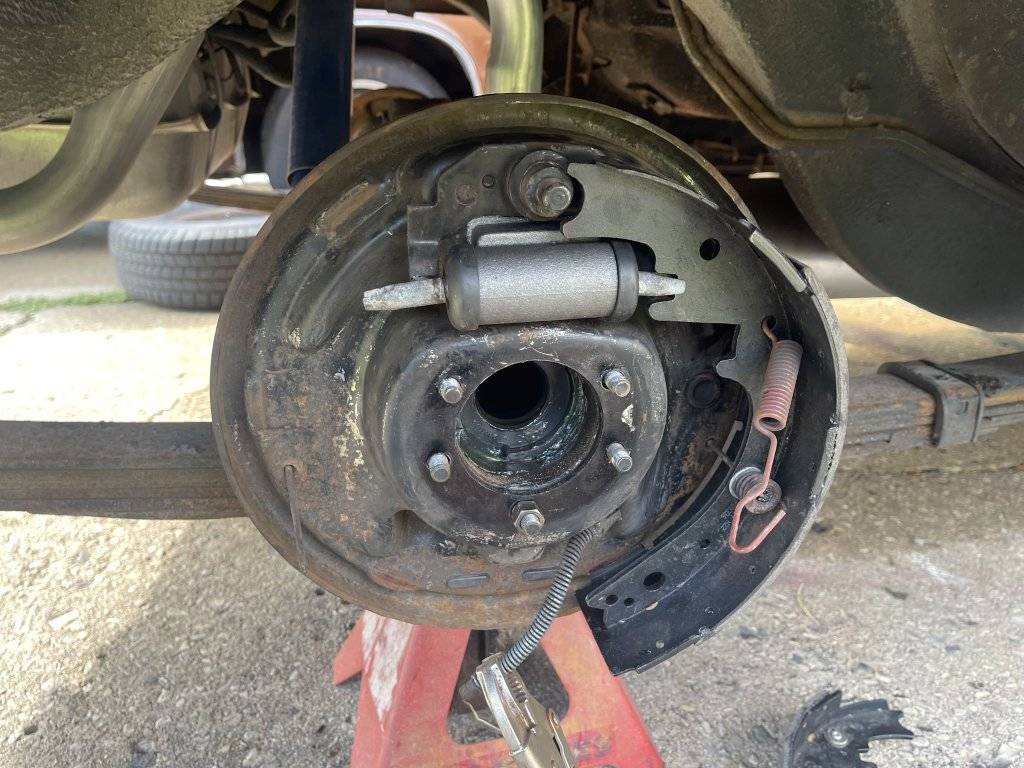

The new master cylinder is in. Now I am getting the rear brakes done, axle shafts will get new wheel bearings on Monday. Then to reassemble and on to the next thing…

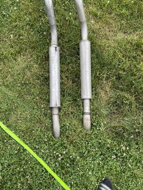

So the parts Waldron remade and hand delivered did not fix my concern. I compared it to the NOS muffler and NOS tailpipe and you can see theirs (left) is longer than the NOS Chrysler parts (right). Sadly they were informed of this and still remade the exhaust incorrectly.

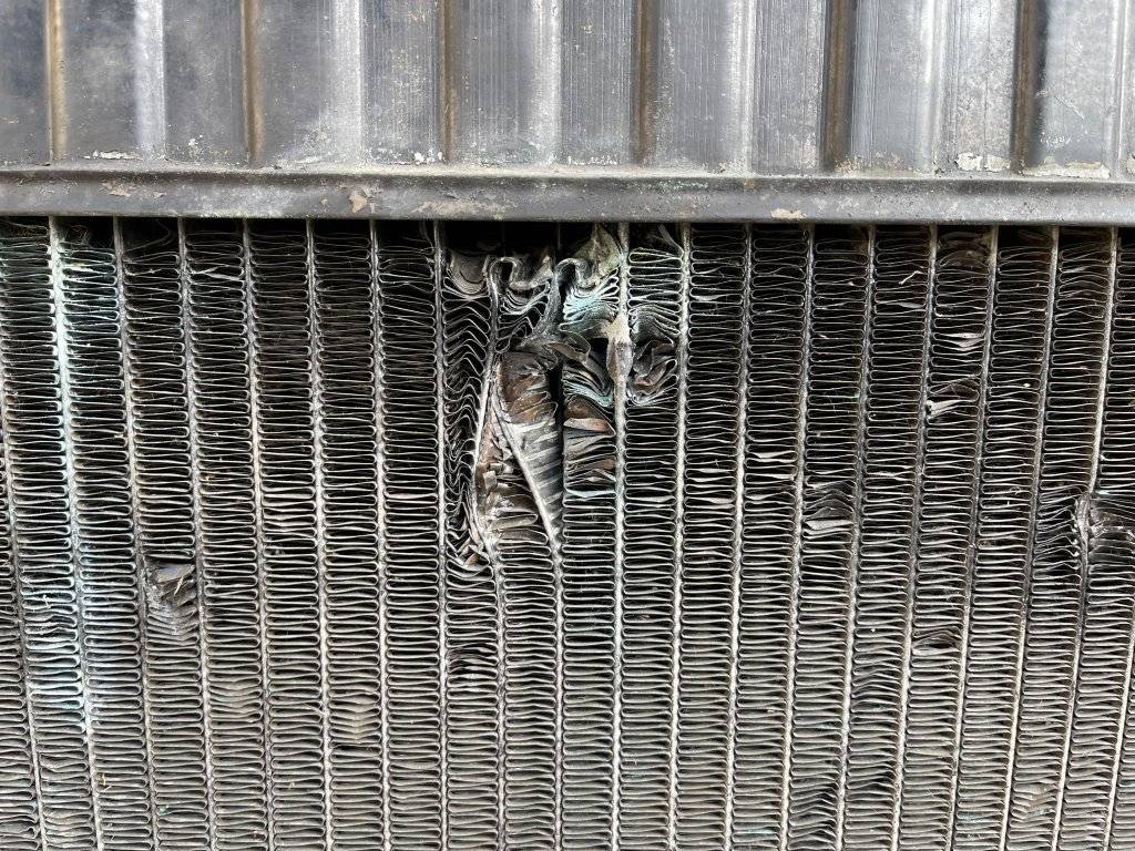

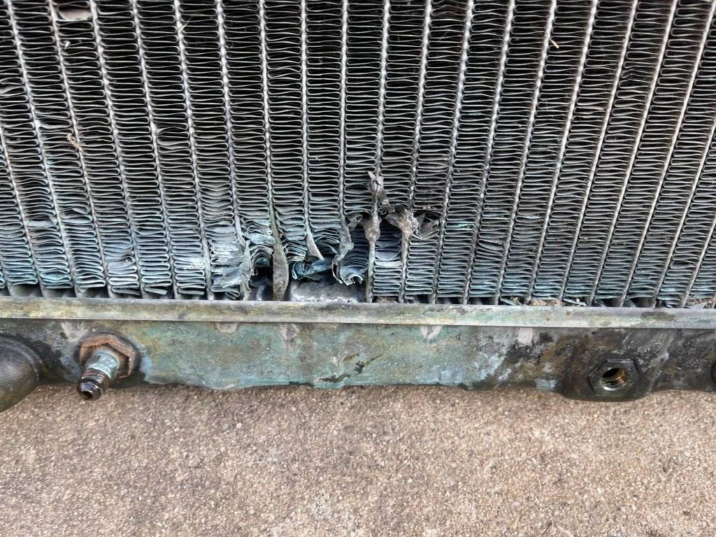

I had to swap out the radiator and I swapped the cracked fan shroud while I was in there. This is probably partly why the car overheats in stop-and-go traffic. I will be recoring this radiator and reinstalling it eventually.

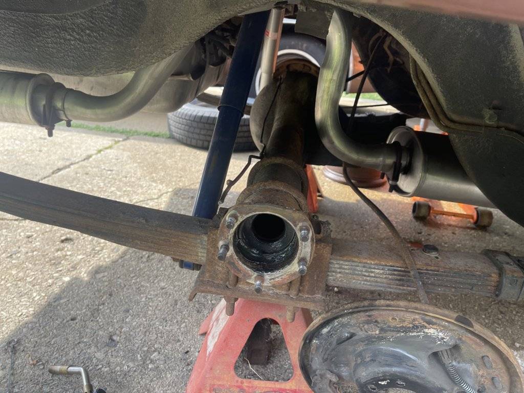

Sadly the axle retainers from Dr. Diff were not great. The driver side was machined incorrectly and one of the holes for the studs was machined like 1/32” of an inch off, and the axle retainer got wedged. Then when I went to go take it back off… one of the nuts I had started got galled and will not tighten or loosen…perfect. It looks like I will be working on the car into the 11th hour…
