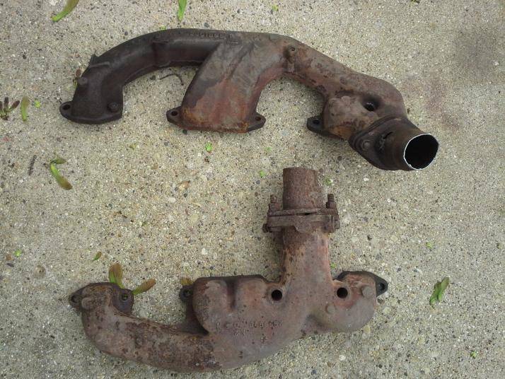

I'd try to locate a nice set of Hi-po big block exhaust manifolds in addition to all the above stuff. Your 383 will breath better with those than the stock logs which are nothing but sharp angles. The big block hi-po manifolds are beautifully designed and act almost like headers.
Or
stick with the 2bbl and be happy.
Find those 440/383 BB hp manifolds....
Gary, what are the part numbers for those HP manifolds?
I dont know why all you guys get a hard on for HP manifolds. They arent worth the effort. Leave them for the numbers matching resto guys.

Expensive, hard to find, pain in the *** to install and then you gotta redo the headpipes since the outlets are different than your stock log manifolds. All so you can gain 4hp?
And you will probably break at least 1 rusty old heat cycled brittle exhaust manifold stud off in the head in the process.
