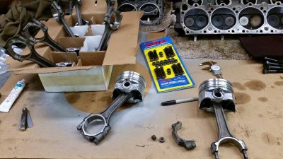

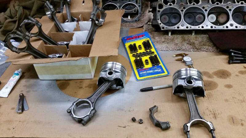

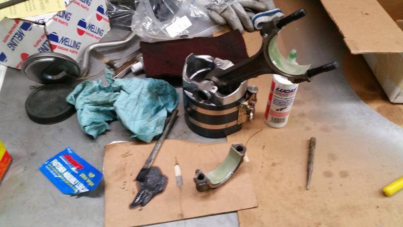

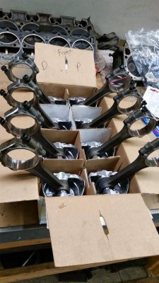

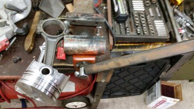

Got the pistons in and took some measurements. Order cam kit. Little by little I am getting there.
20150222_110221.jpg20150222_115239.jpg20150222_115446.jpg20150222_135430.jpg20150222_142329.jpg
The hypereutitic pistons call for a wider gap then normal forged or cast.
That's ring clearance in the lands. The rings are usually .0035-.004 per inch of bore and.the second ring is usually more loose like .004-.005 per inch. Larger gap on the second ring let's any trapped pressure out between so top ring can stay against the cyl wall and not flutter or be pushed off wall by trapped pressure, losing the seal. Always error looser than tighter, above numbers would be a minimum .028 is out at the far end okay if engine has 100,000 miles on it but to start that loose and when initial break in wear settles, I would think it would end up too big.

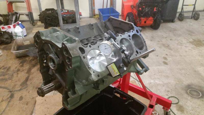

Correct, .025 down. With gasket .039 and 73.5cc heads, I should be running around 9.3 to 1.
If your deck clearance is .025" you should be at 9.4:1.
If your deck was a true 9.98" I show .0265" below deck you would still have 9.37:1
Most posted piston compression specs in the past were way off and I still don't trust them, so I always do the math and always check my combustion chamber volume.
For a reference to others here's how to calculate your deck clearance before you buy pistons....
383 B engine specs
Bore 4.25"
Stroke 3.375"
1/2 Stroke 1.6875"
Deck height 9.98"
Rod length 6.358"
Keith Black piston specs
Comp height 1.908" (from wrist pin center)
Valve reliefs -5cc
9.98 Deck
- 6.358 Rod length
- 1.6875 1/2 Stroke
- 1.908__ Comp height
.0265 Deck clearance

I thought valve relief adds ccs?
If you want to add them, you can just add the valve relief CCs to your chamber CCs; I subtracted them from the piston... A solid vs. your void.
