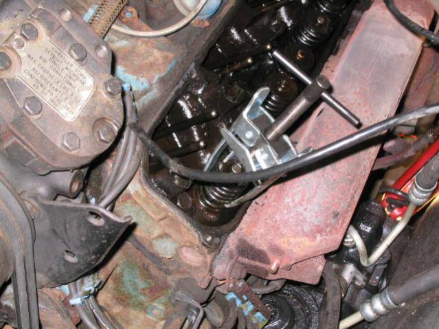

Has anyone used this tool to remove the springs on the head while it is on the car along with compressed air. I have dual valve springs and I have to break in the cam with the inner spring removed and install it after. I do not want to remove the heads once I put the motor in the car. Thanks.
Its an okay tool lot of screwing and unscrewing. That can kit you mentioned is a lot like 383-440 magnum cam and does not need double springs sure your not talking about the dampener, a flat spiral inside the spring itself, it has no appreciable spring rate and would be okay to leave. Usually don't go to double vavle springs until a solid cam.
That is exactly what it is. What is the purpose of the dampener spring? You just saved me a ton of time and energy, I owe you a beer!!!

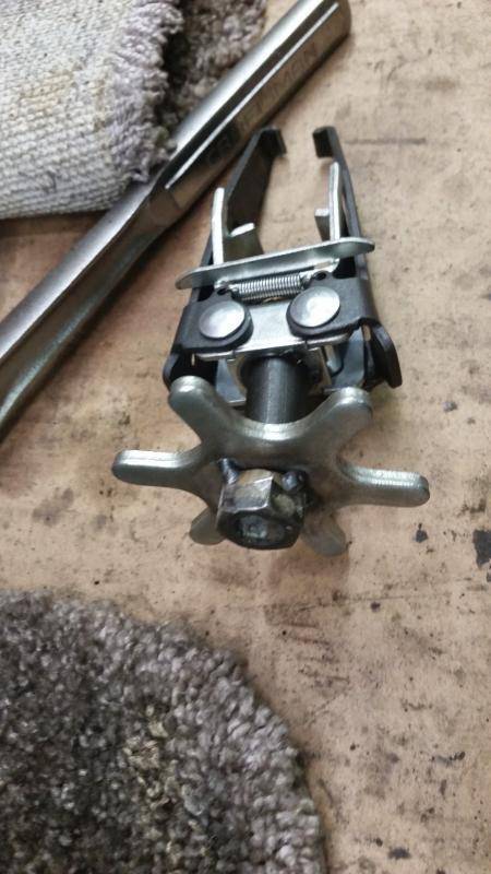

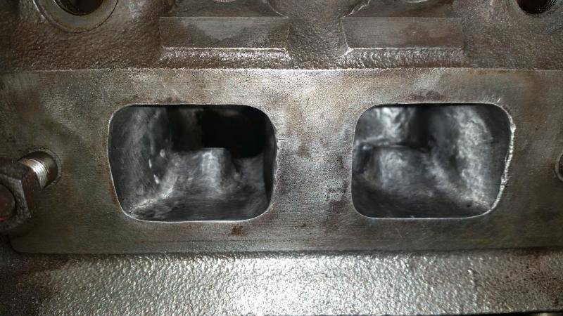

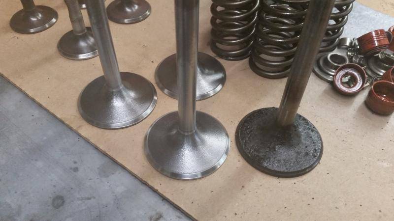

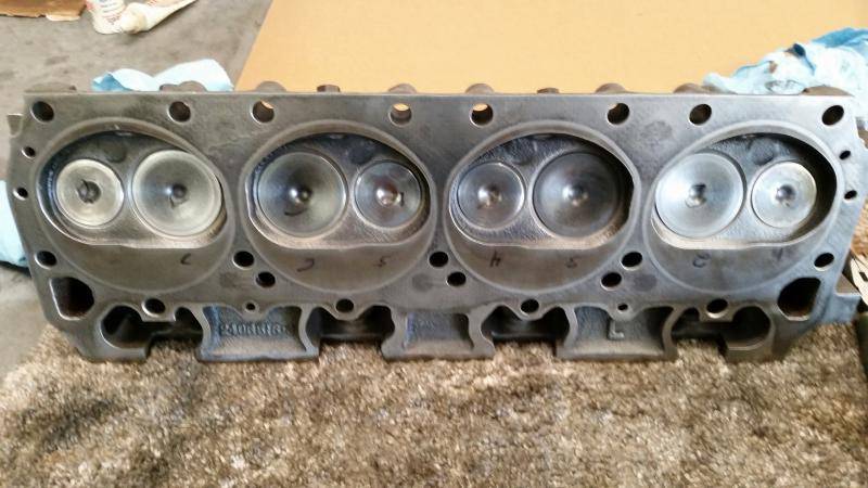

Did some exhaust porting, since I am going to keep the 1.60 valves. Turned out ok. Picked up the valve spring compressor for 10 bucks and welded a nut onto it. Very happy with it, because I can use a drill with it now. Cleaned up the heads and should be able to piece them together sometime this week.

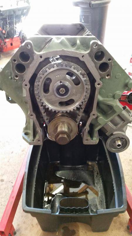

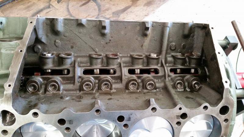

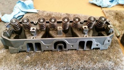

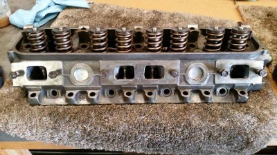

Well I was able to lap the valves and put the heads together today. Got the cam and timing chain in. Went to go have my exhaust manifolds sandblasted but the shop does not do individual customers, just companies, so I will have to come up with something.20150313_114058.jpg20150313_114112.jpg20150313_114124.jpg20150313_143944.jpg20150313_150326.jpg
