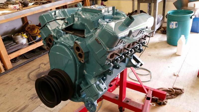

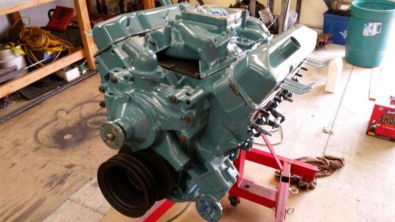

Nice work Jake!!!
How did you prep the valve covers....they look like NOS.
Nice work Jake!!!

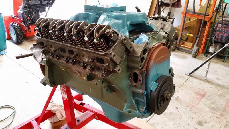

Wire wheel and elbow grease, mineral spirits and etching primer and paint. I had to re-weld one of the spark plug wire holders.
Nice job, intake looks great. What grit and what size flex hone did you use for honing the cylinders. I'll be taking on the same job soon. Looking forward to seeing this one finished. Thanks.
I lied, 240 grit on the flex hone.

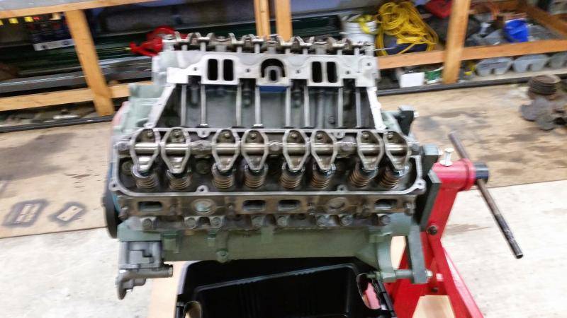

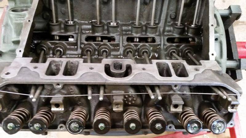

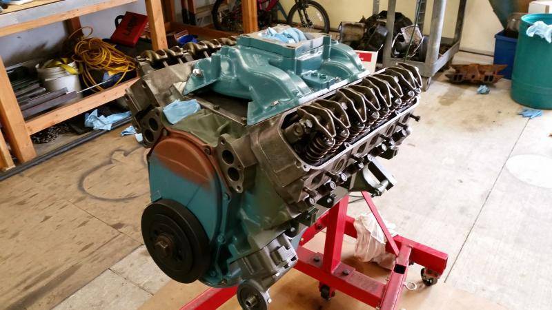

Mineral spirits on the heads and block for some cleaning. Thin film of anti-seize on the the mating surfaces. Torqued the heads down to specs with anti-seize on the threads and washer and bottom of the bolt head. Dropped pushrods in and torqued down valve train nice and slow! Getting there.

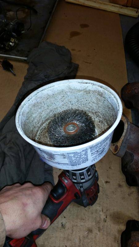

Got the valley pan and intake along with the oil pan on today. Found a easy way to clean small bolts and washers.
For your manifolds try 1 part molasses to 9-10 parts water in a tub, works better in warmer climates, takes a while, but it dose work, they will come out like they were just cast, blasting is way quicker
