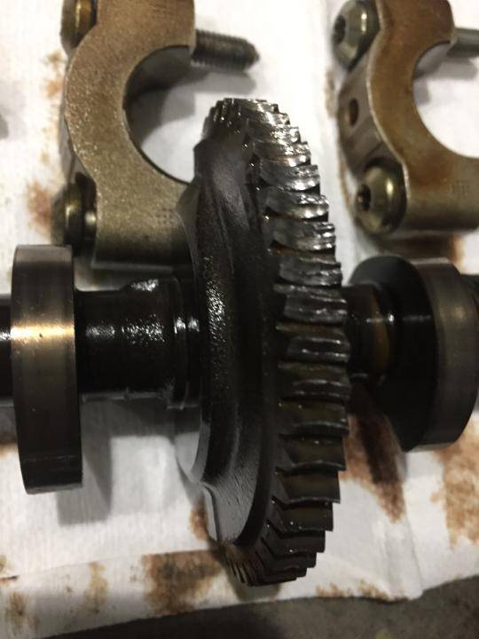

Shades of the 318-4, huh? But you're fooling yourself if you think other companies don't do the same thing (or worse). Please find the attached photo of a BMW "wear item", the worm drive for a valvetronic (VVT) engine. My buddy just did this job after the cost exceeded the value of the car (so being a mechanic, he bought it from a neighbor).
N55 eccentric shaft,valvetronic motor
I've actually never changed Gen 3 hemi plugs in a car, but in a lab setting, I could do it in about 3 minutes. 5 with a blindfold. BTW, the newest hemi's also have VVT, but it's done without any wormgears!
The worm gear is providing variable lift... lots of different ways have been used to get there... IIRC BMW went with a different design after a couple of years...
For those who don't keep up with this technology, the valve lift is used to control the engine... the throttle plate is now used primarily to control vacuum almost like a late model EGR diesel.
