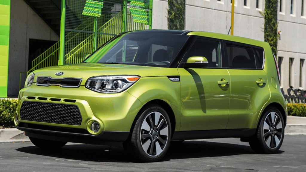

Are we talking about this color? That is a 2014, though, not 2025.
Hamster car!
Alien II Pearl Metallic, a specific factory paint color with code AE2 used on Kia vehicle.
Note that Alien Pearl in 2013 looks to be significantly duller.

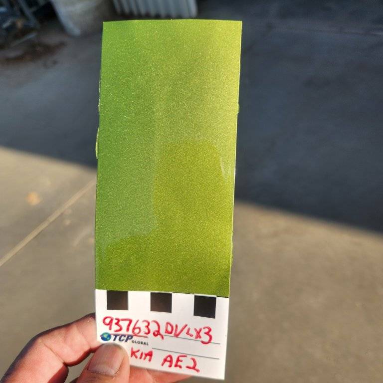

Just to clarify this Kia color is a starting point not an exact match to the Chrysler color. It needs to be tinted to be an acceptable match. The toners and tints that are used today are very different than the ones used in old technology paint that was used at the factory so even a perfect color match is going to be more vibrant and maybe more brilliant.

For Medina, it took a number of tries to get the GY9 to match. Luckily @azblackhemi found several unblemished and non-faded color parts on Medina that could be matched. Luckily @saforwardlook is in similar shoes and plans to proceed accordingly.

I had my paint guy mix a sample of the Kia color and I did a spray out. I'm going to mail it to Steve so he can compare it to his color selector chip and to the car itself. Then we can go from there depending how it compares. The metallic is very fine so that's encouraging.

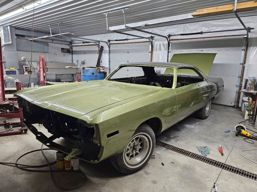

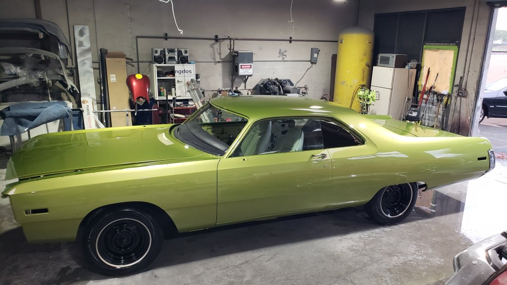

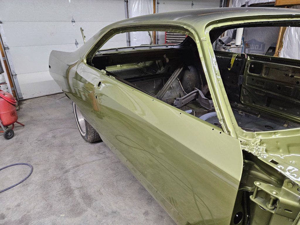

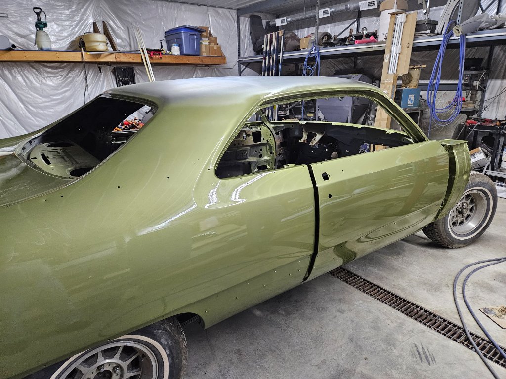

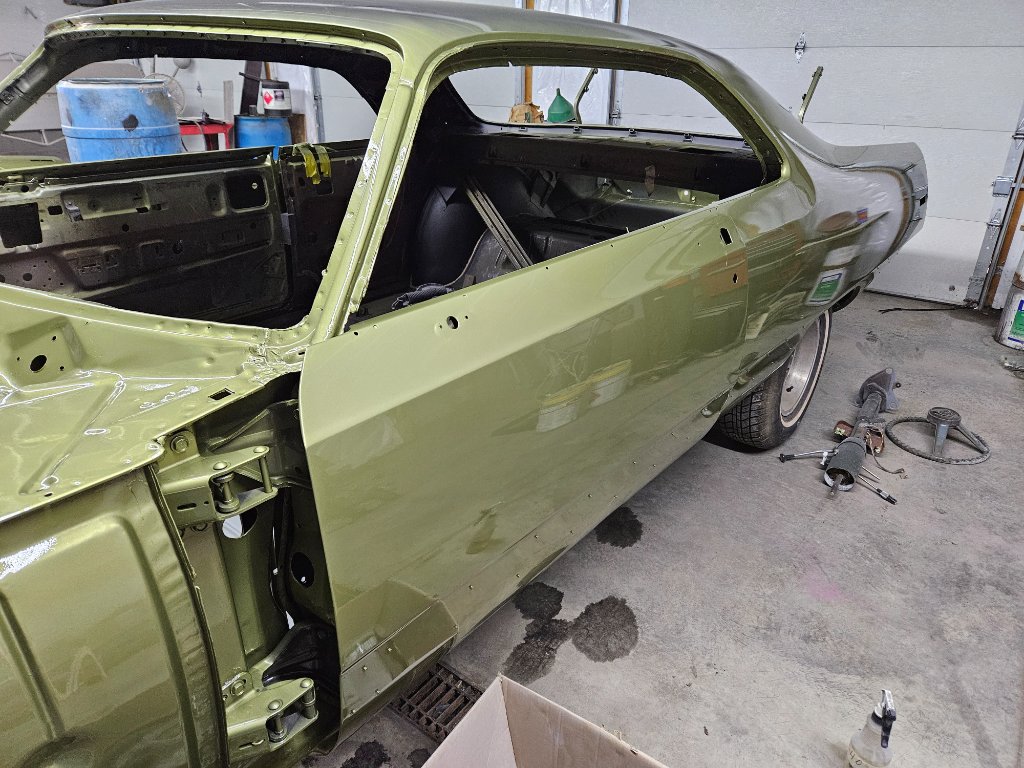

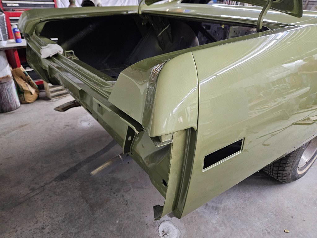

I just wanted to provide an update of what is going on with restoring my 1971 Chrysler 300. The spray out of Chris' (@azblackhemi) paint chip matched extremely well the original Chrysler color and trim selector paint chip, so I had my body shop go ahead with the body and paint work. The shop I am now using normally is just a collision repair shop but once and awhile they will also do body and paint work on "classic" cars because the guys working in the shop are mostly Hispanic and they really enjoy working on the older cars more than the usual newer cars so the owner likes to slip in an older car once each month to keep their skills at a high level. Before I used this shop for the first time on my car, I looked at some of their newer cars after the collision body and paint work had been done and I was very impressed with how straight the damaged cars came out and the quality of the paint applications etc. before I decided to give them my car to do the relatively little body work needed and the paint. The attached photo shows the excellent work they performed and the gloss and straightness of sighting down the bodyside is better than just about any of the cars I have had done before using this shop that is only a few miles from my residence. Maybe around mid-year I should have this car completed.
After this one is done, I should be ready for my triple black 71 300 to come to this shop once my rust repair guy is done with his work.

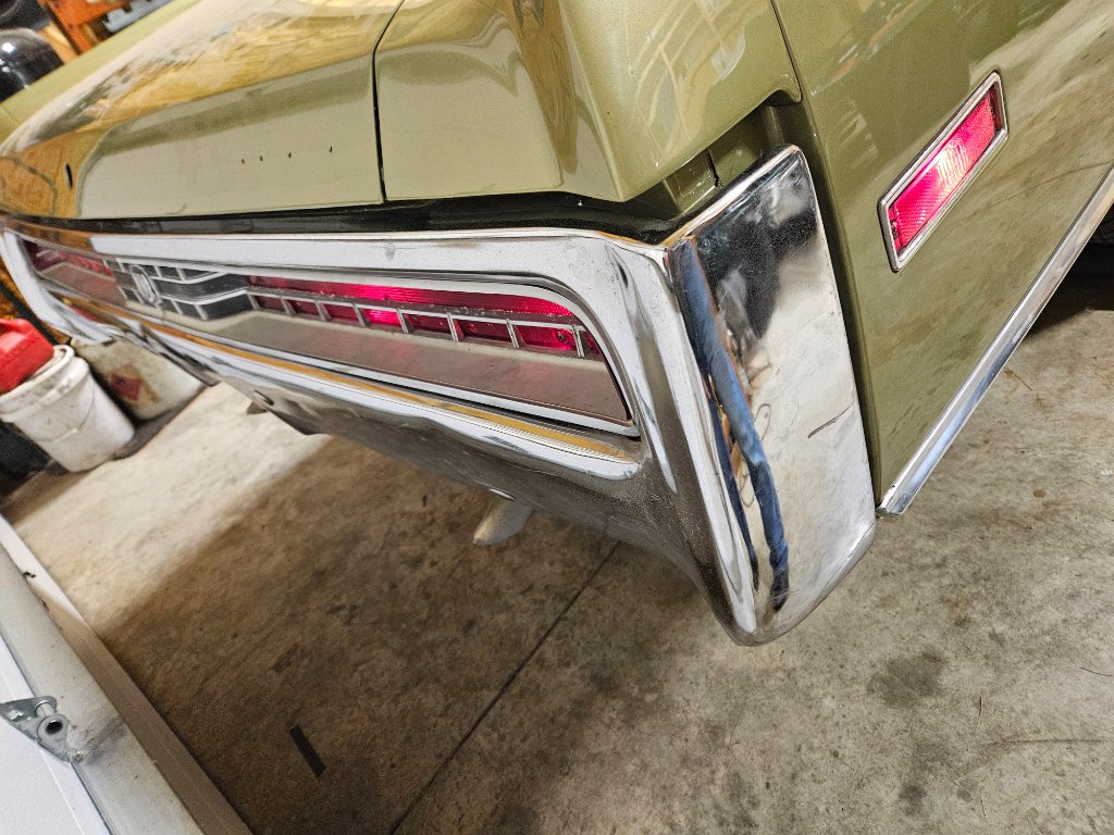

In the next few months, I will have a new original white boar grain vinyl top, seat covers and an original headliner (all provided by Legendary Auto Interiors) installed by a trim shop I have used many times before and I will install a new carpet set as well. I will install the recently rechromed front bumper and grille assembly soon and the shop already installed the previously rechromed rear bumper when doing all the other work. Then installing the polished side trim on the car will be the last step.
Glad that worked out so well. Looks amazing. Will be a total stunner with the white. Which wheels/covers will finish it? Will it have the pinstripes along the lower body line?
The picture of the Soul with the rodents is actually a different, earlier color, a more bronze green. When they restyled the Soul for 2014, that must’ve been when the Mopar clone color came out. Those designers had to have been going through some old literature or color chips making old new again.

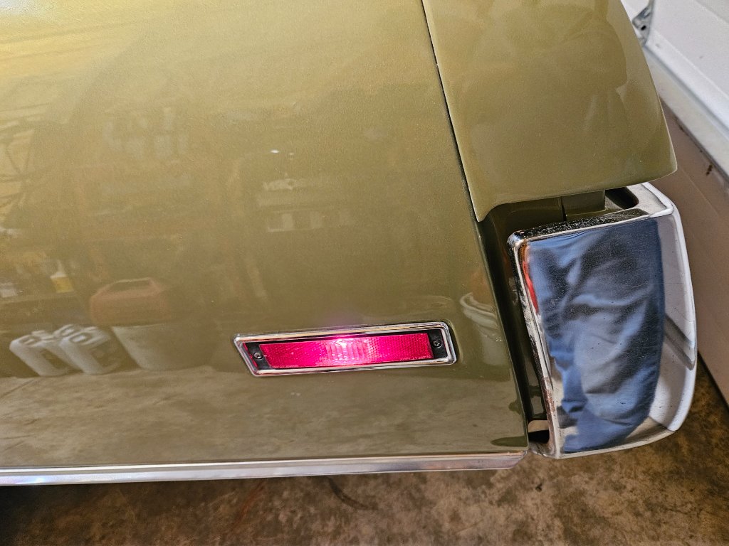

Damn that looks good. Will you bring this to Carlisle this year? Cerium oxide will polish out any scratches in your side and rear glass. My hats off to your painter.

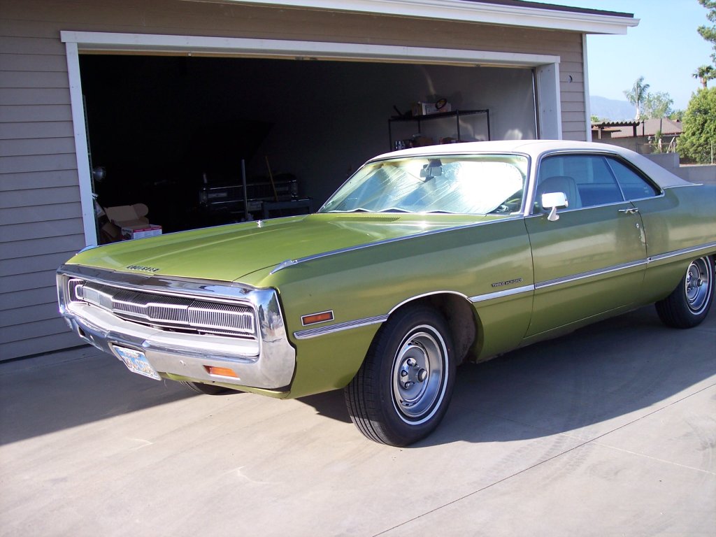

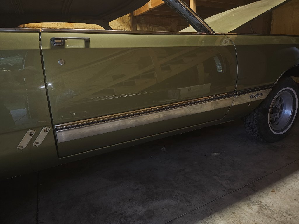

Here is a photo of the car before it went to the body/paint shop. This is the way it will look generally when I am finished and it will include a set of road wheels on it as well to set off the sporty image of the car. By the way, this photo is with the car's original paint shown in the sunlight except for some touch up around the rear of the front driver door done by an amateur.
Probably won't make Carlisle since that is almost a cross country drive from California in a hot time of the year usually. I am just 6 months away from being 79, so I like keeping more active than doing all that driving. But folks on this site are always welcome to look over my asylum. I get a bunch of visits from overseas quite a bit still each year.
