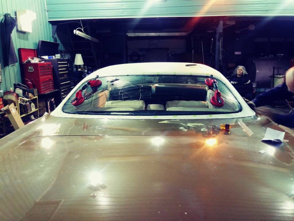

Well the rear glass is back in the car!!

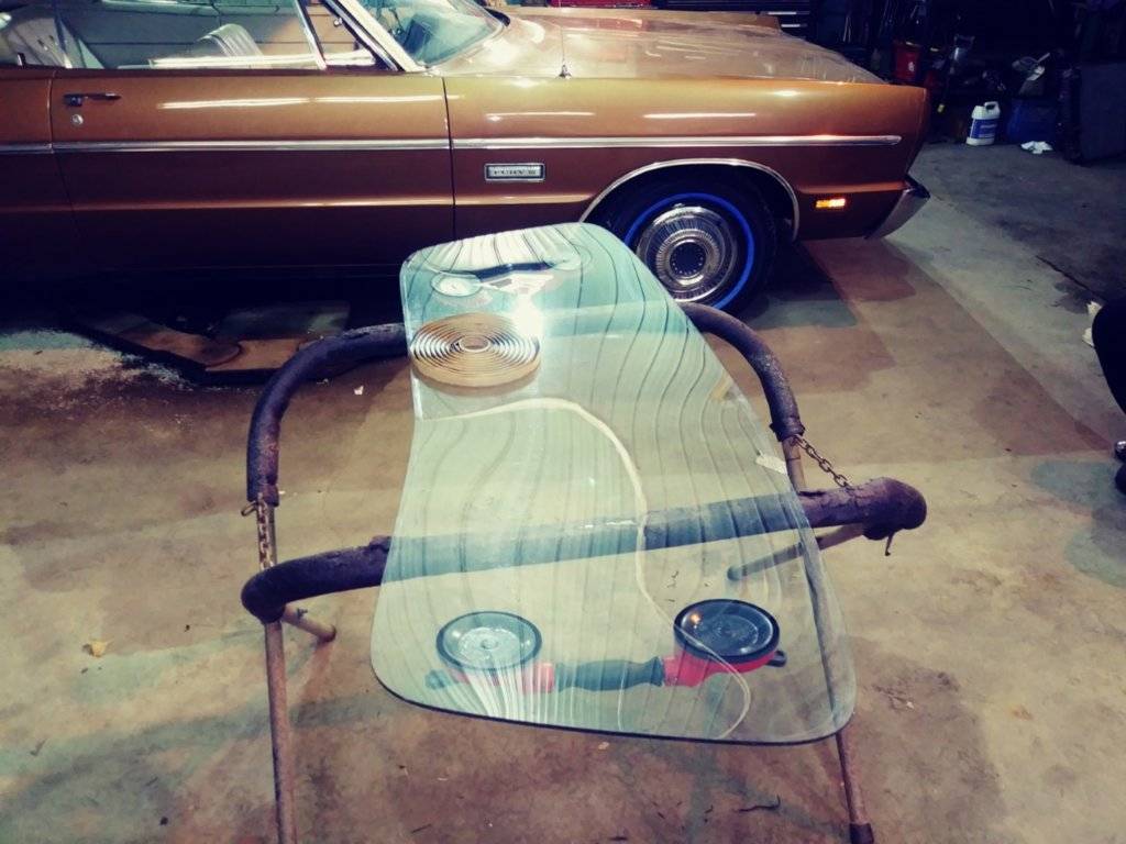

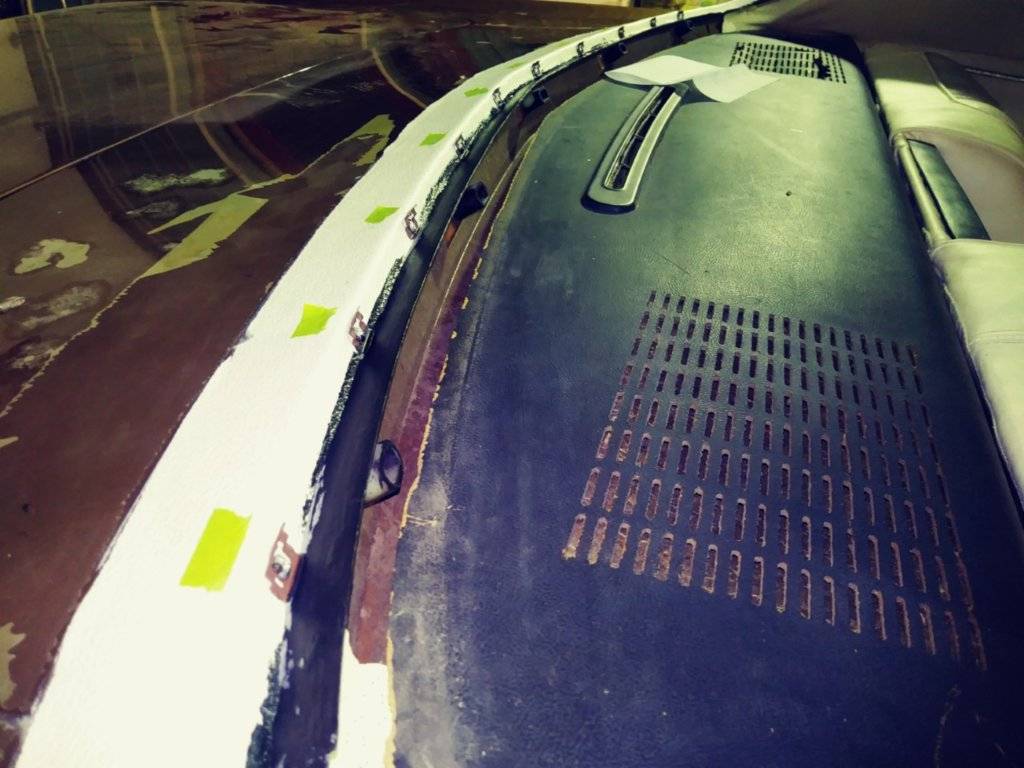

New trim clips and Bill prepped thee mating surface for the good old fashioned buytl on waxed paper.

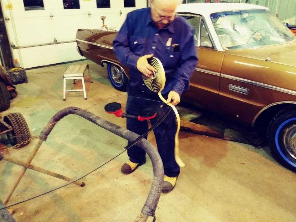

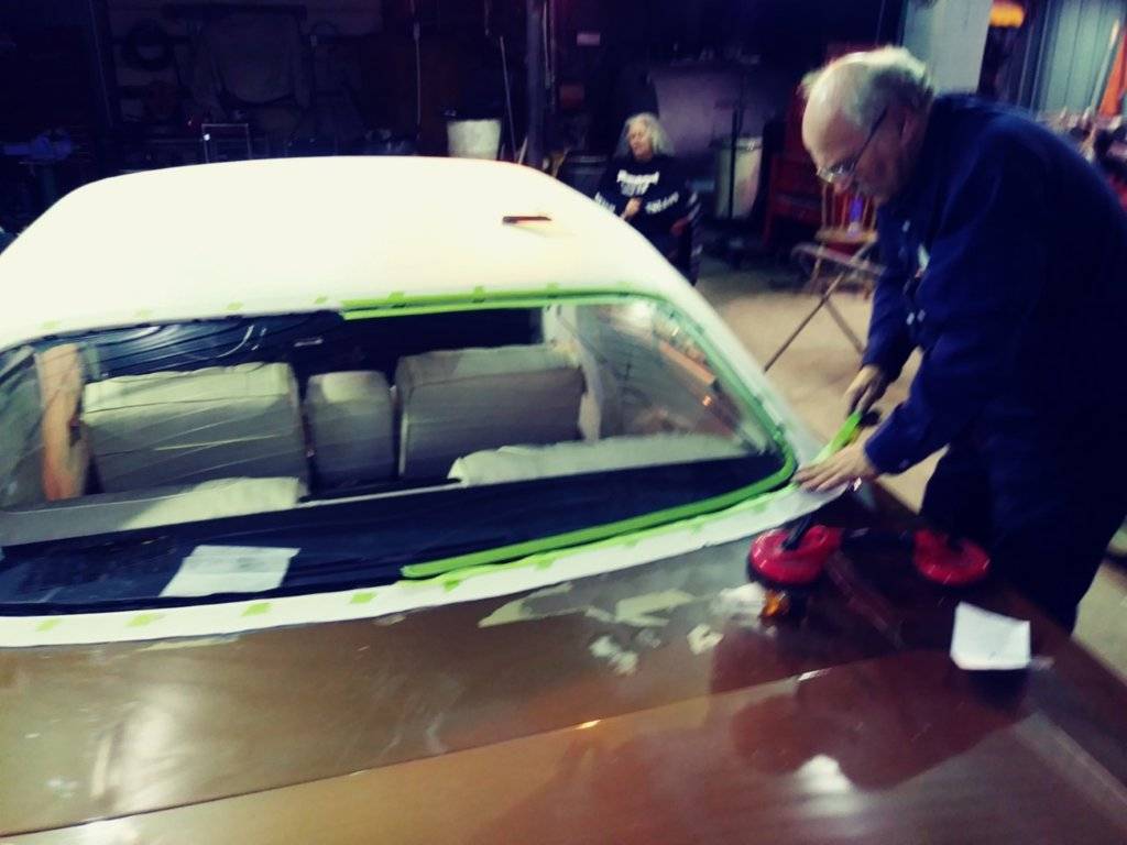

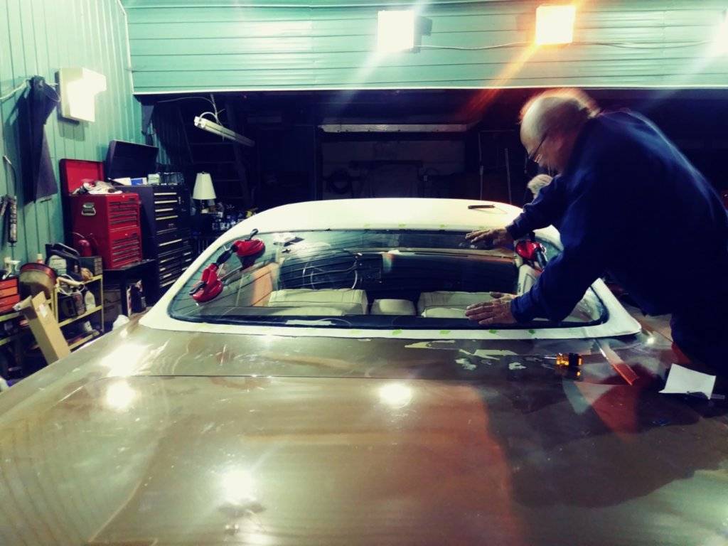

Rear window got cleaned up and old butyl removed and suction cups put on for the installation..Using a heat gun,Bill softened the roll of butyl and applied it to the glass..
Got a lot done the past two days!
Trim is last to get polished and installed.

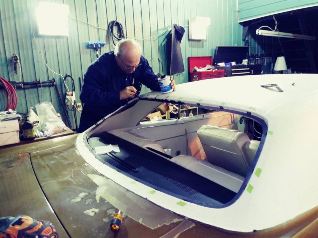

Thanks for the updates and details, going to do this on my 69 300 soon. What did Bill use for adhesive on the top?
Not exactly sure and I will ask him. All I know it takes 30 minutes for it to get tacky and set quickly after that. Once both the roof and top was sprayed time was of the essence..
