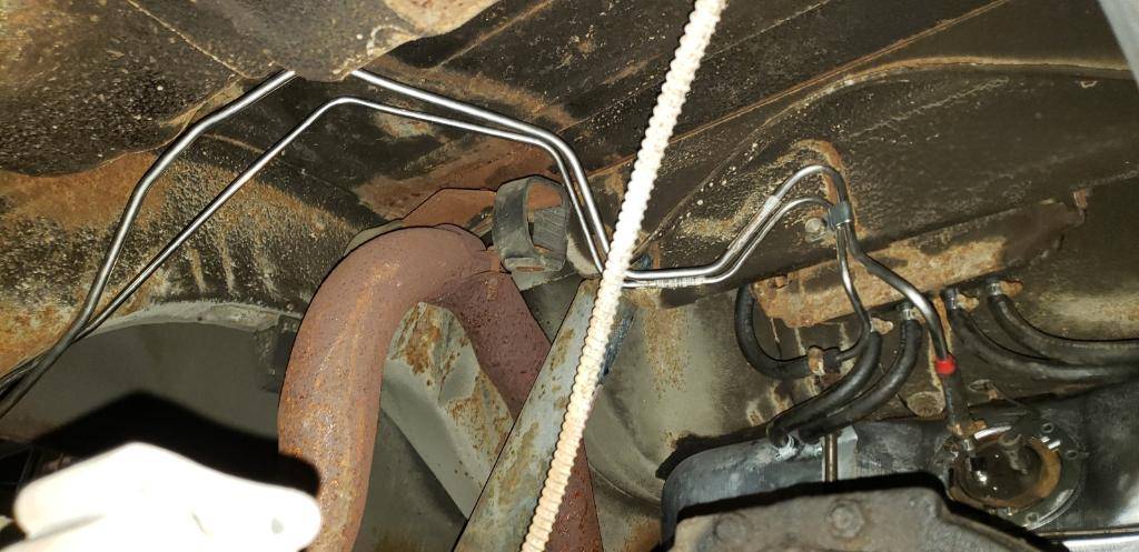

new fuel lines have been shipped
I bought fuel lines (both the 5/16" 2-piece HGL7301 main line & the 1/4" 2-piece HGL7302 return line) from Herb's back in February -- see details here, including rubber lines and clips.
They arrived within two weeks, as promised, and they have just been installed by @71Polara383 -- who tells me that they fit perfectly. That is good, because they were not cheap (and shipping was also expensive).

Indeed, and I’m happy to pay for that exactitude. They were the only vendor showing clearly that two sets of two lines were needed, and did not lump the different model years together (which would have been incorrect).
... and did not lump the different model years together (which would have been incorrect)...
So many people/vendors that do not realize how many differences there are in C-bodies.

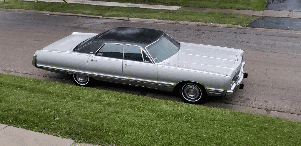

Well, @71Polara383 has done a lot of work and put Ming back on the road -- several hundred miles of driving to break in the rebuilt engine. Here are a couple of photos that he took last month (the second one shows Ming caught in a bit of rain). I will let him post about the work that was done.

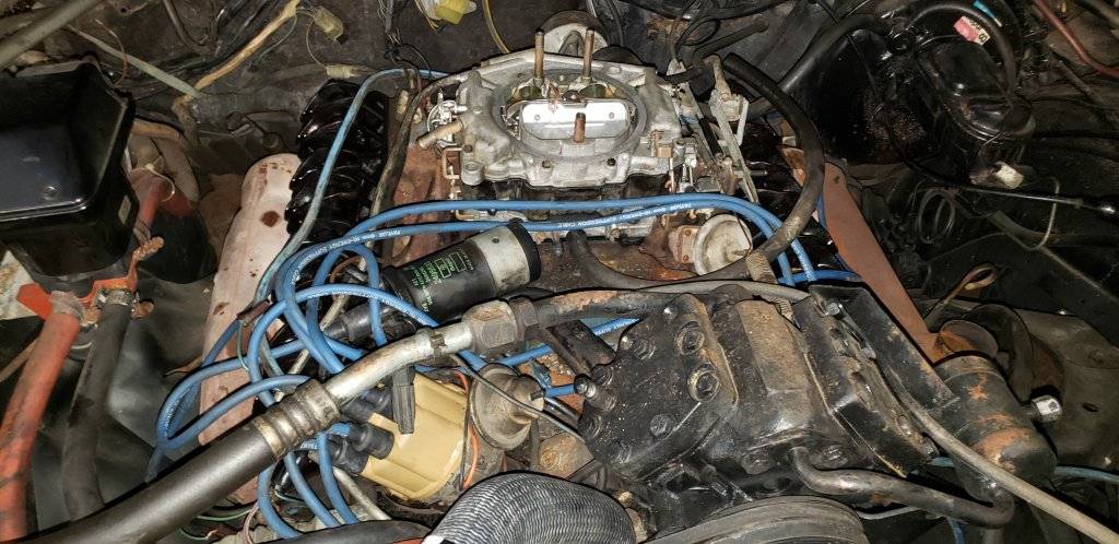

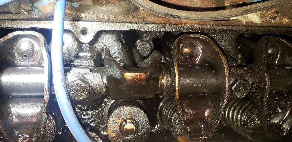

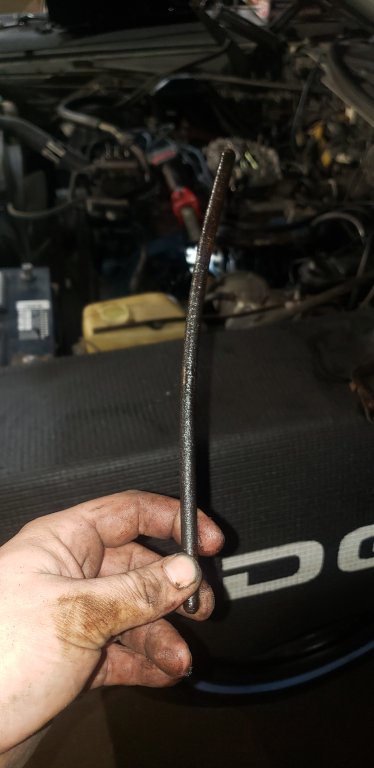

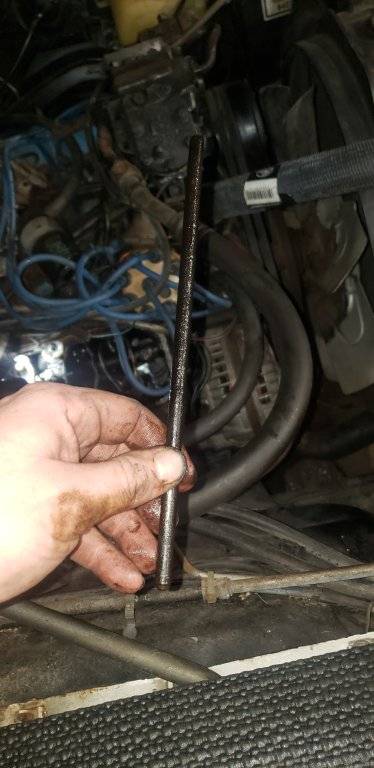

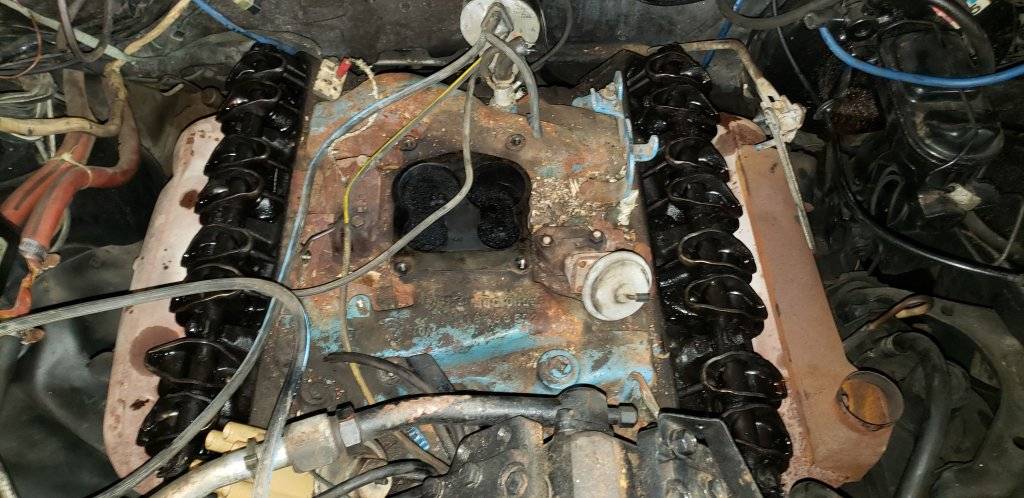

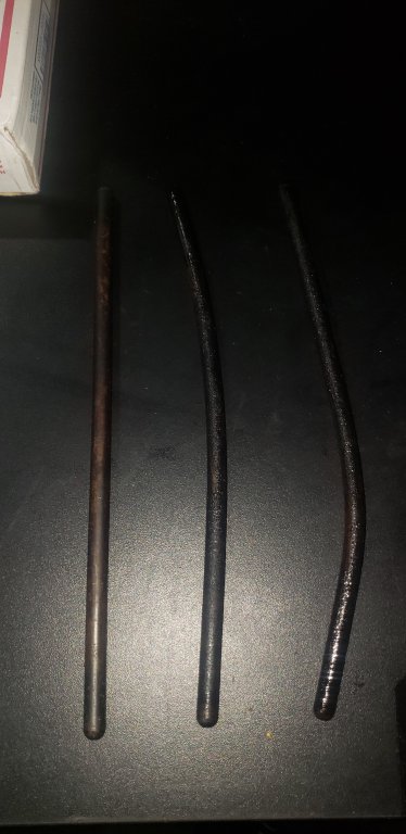

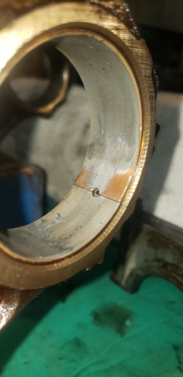

When Ming arrived in March of 2020. I believe the seller gave us the impression it ran good but had bad gas in the tank and could use a tune up. So we sent the Thermoquad to @Dana for a rebuild. I changed the oil with Brad Penn and a Wix filter. I also did plugs/wires/cap & rotor at this time. In addition to those things, I changed the fuel tank, sending unit, and rubber hoses to freshen up the fuel system. Once the carb returned and was re-installed, the engine still wouldn't run properly. We fixed all the things that it would have needed anyways, but now it was time to dig deeper than we were hoping. After observing the symptoms ming was experiencing and recalling the symptoms @sixpkrt had with his gold 71...it was time to pull the valve covers to have a look. Sure enough, we had a few bent pushrods and lifters popped up almost out of their bores.
I discussed the options we had with @ayilar
1. Replace the bent pushrods with good used ones I have on hand and cross our fingers.
2. Dig deeper and go through the engine completely and just be done.
We went with option #2.

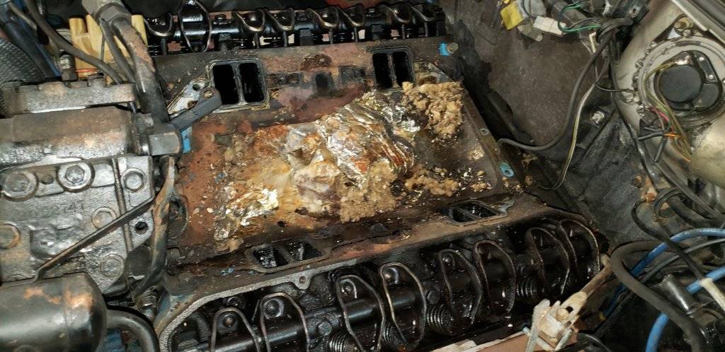

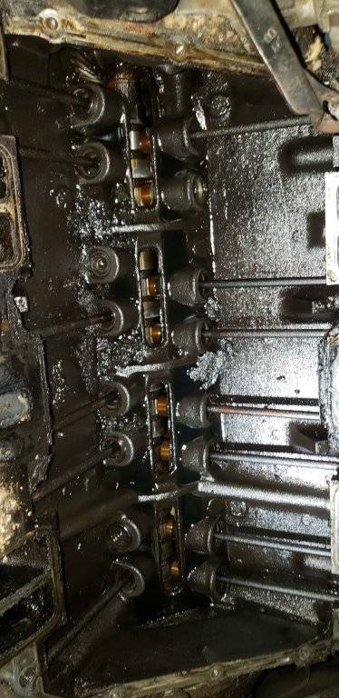

Off came the intake and I could tell quickly this was a good idea with some of the gunk in the lifter valley...

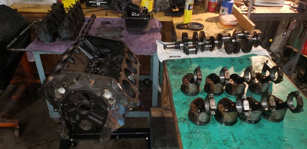

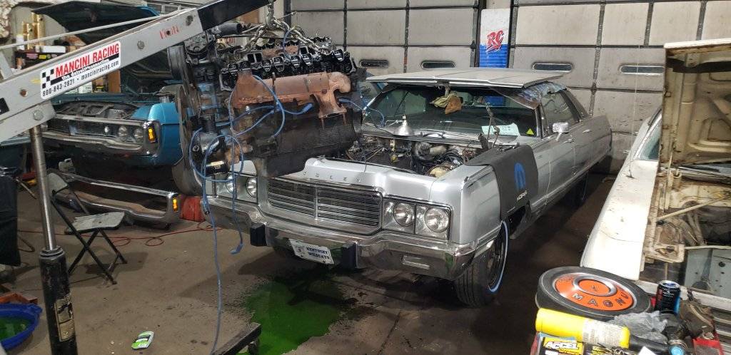

I pulled the engine out and got it on the stand for disassembly.

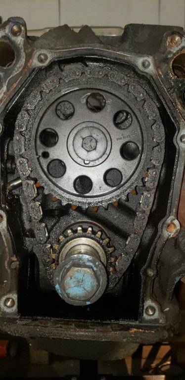

First thing I noticed was the slop in the timing chain.

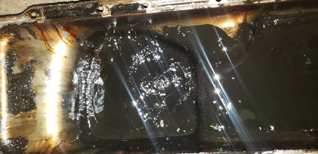

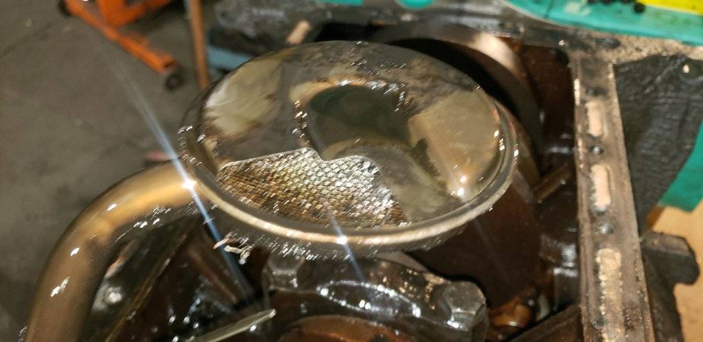

I removed the oil pan and found it had a layer of thick sludge on the bottom and certainly the pick-up wasn't getting too much oil.

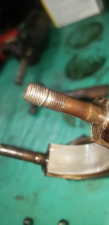

The bearings showed discoloration and wear as well. Also I found a damaged rod bolt.
All torn down, its ready for the machine shop.
