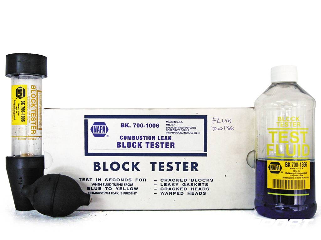

Unless you are 100% that it's a bad head gasket, and not trapped air from the boil... I have a couple kits similar, but prefer the second picture style as it makes it easier to prevent coolant from contaminating the fluid. If you buy the first style, drain off the top couple of inches of coolant from the radiator (the tool goes on instead of the cap) so you don't ruin the test fluid... if you do draw in coolant just toss the fluid and rinse the tester and start over.So I went to a restaurant today with the car, 10 miles there and what did it do? Got effing hot again of course. Spewed coolant after I stopped. Ugh, after the meal I decided to simply drive home and see how it would go. Damned thing cut out while driving along and the needle was hard over to the right. Anyway, got it started again and managed to get home, needle still hard over to the right. Put the thermo gun on it and it reads 220 at idle. Then I shut it down and I can hear coolant bubbling in the radiator hose. I let it cool for two hours then started it again with the cap off and looked, ah hah! It looks white! Is it oil in the coolant? I get a flashlight and look more closely, nope, that's a stream of bubbles in the coolant. DAMMIT! Looks like I'm pulling the heads.

Wouldn't do the job... those would be for HC's only... you would need one for CO2... I'd try the fluid test.
