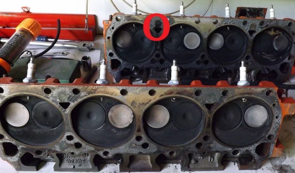

I think I found the problem, check the pic, you will see the red circled area shows a spot which correlates with a coolant channel, there is black carbon here which extends to the edge of the combustion chamber, the other three corresponding ones on both heads are light in color. So I'm thinking this is the spot where combustion gases are escaping into the coolant. I am also going to crack test the heads just to be safe though.

Oh crap! Well, at least you now appear to be on the right track. I guess yer headed back to the machine shop with those heads. Huh?
No I can crack test them myself, I just have to pick up the kit to do so. Once I get back some money on the purchase of the 73 NYB I will do so.
Mighty fine. Given the appearance of the way the gaskets were, it appears there is something not flat about your heads. Is there any way you can check that too?
The heads I checked before I rebuilt the motor, being that they were done in Massachusetts before i got the car I went over them myself. But yes i did take a steel ruler and checked diagonally, longitudinally and width wise in multiple locations, perfectly flat mating surface on the heads. I will double check the block too. I have my hands full at the moment though.
looks like the steel ring of the gasket was sealed to the head. the burn through could have occurred on the block deck side.
Yup I gave the block a close look as well, nothing showed up, I still have to check it for flatness though. That will come.

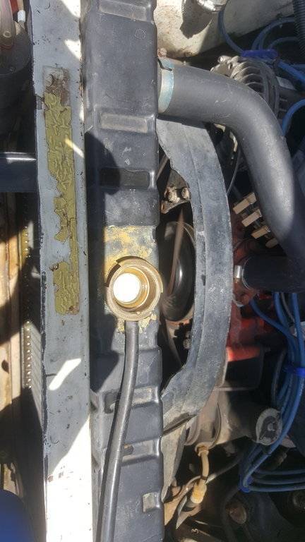

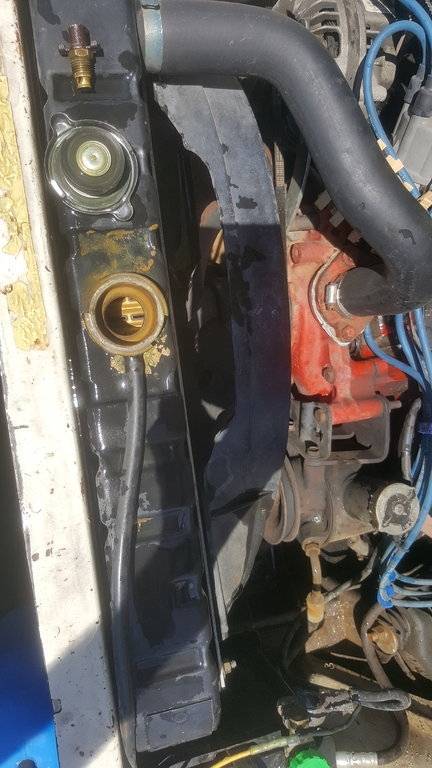

since i jumped into the middle of the thread with a totally different topic (thats how we do right?) about the snake oil radiator treatment (evapo rust thermocure from summit) I wanted to post a couple of pics about it:
when i drained and flushed with water, i thought i had milkshake, figured the treatment ate something and let motor oil in. i was pissed.
but then after a up to temp warm up to get the t stat open, the foam cleared up - i guess its just some flim flam left over from the additive.
so another drain, and another water flush:
that sukka is clean as a whistle in there.
