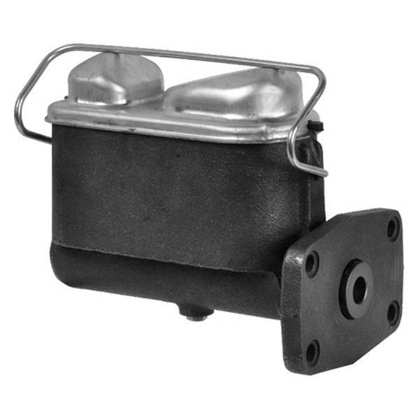

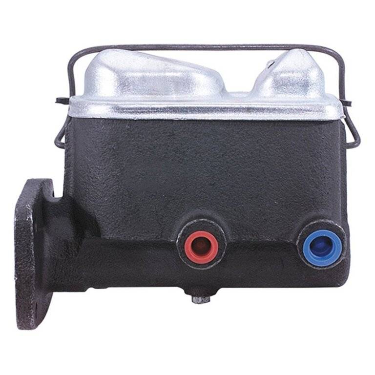

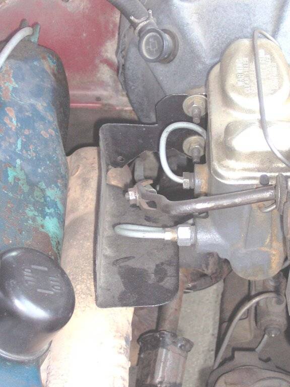

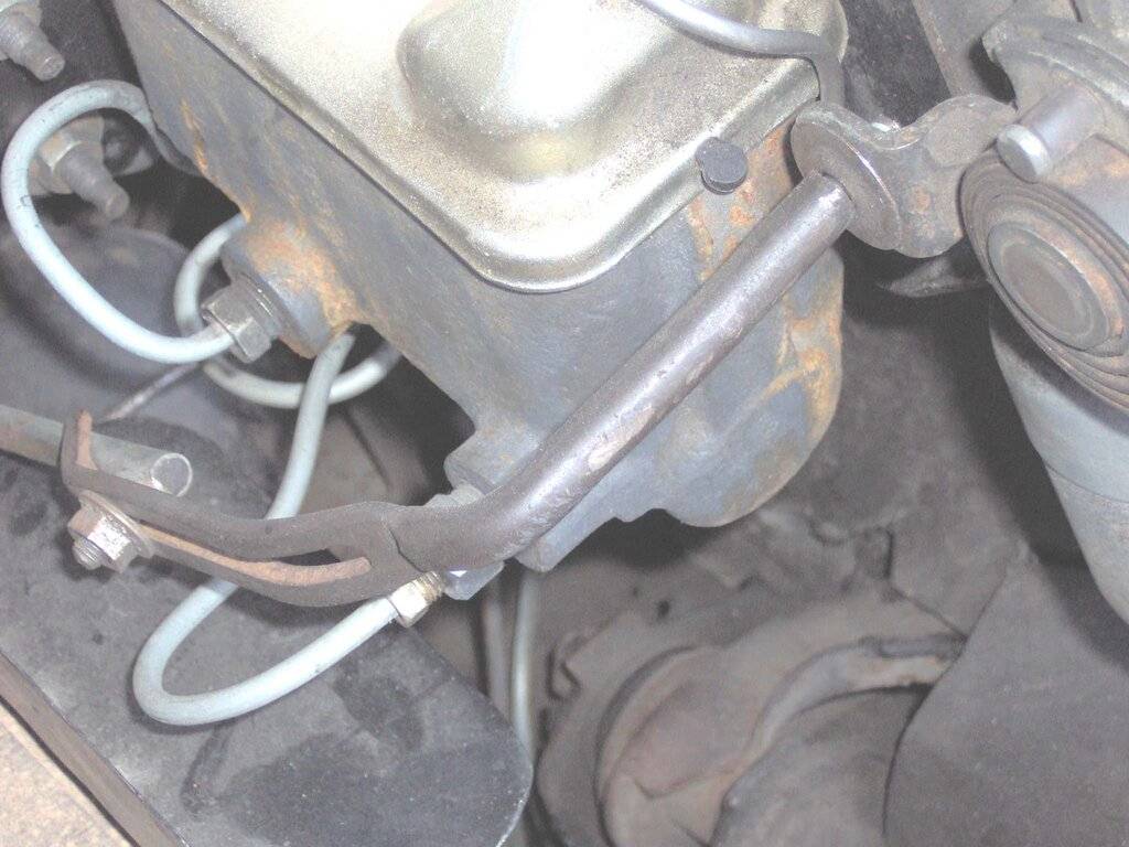

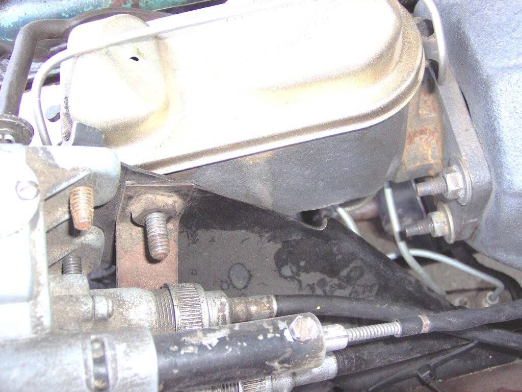

I convert all my cars to dual circuit brakes as a matter of course, due to that experience.
Of course, DOT 5 fluid will eliminate the hygroscopic thing, BUT, while unlikely, brake circuits can still fail for other reasons than a burst brake line due to internal corrosion. Fittings can let go. Wheel cylinders can let go. The dual circuit system is your fail safe. There are reasons it was mandated.
