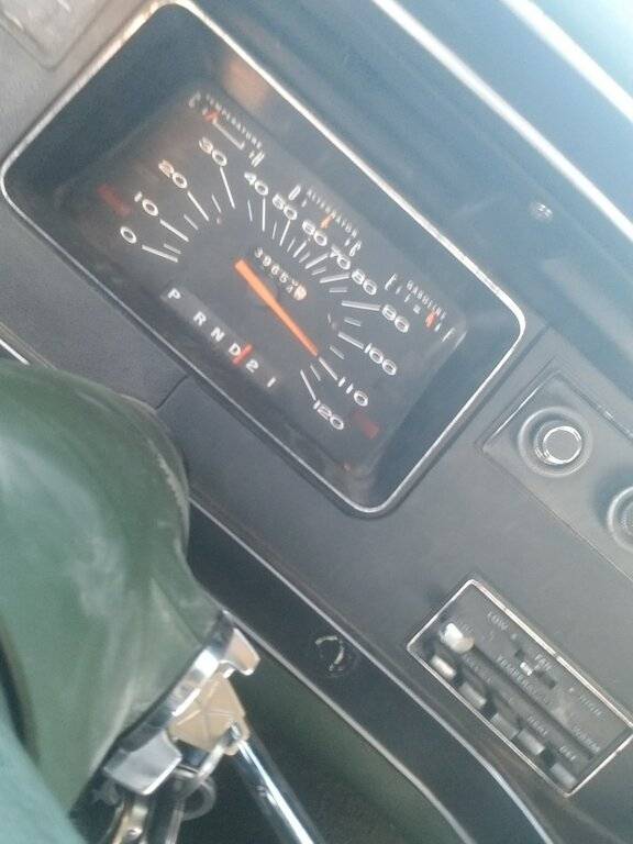

I replaced the temp sensor and checked my wiring for any damage. Didn't find any but I know something is still wrong because my gauge has always read extremely low since i got the car. I drive 90 miles to work every morning this is my temp after about 60 miles of my commute, it's not actually low. Something is wrong with the gauge or wiring, but it does respond to temp change. I changed my radiator cap last night just because I had one and topped off my coolant. Didn't have any spikes this morning.
