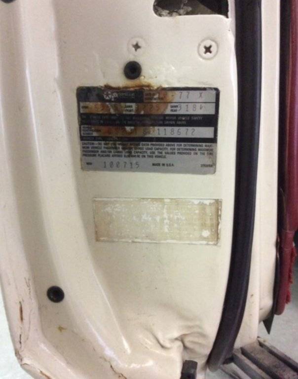

I have inquired from Chrysler Historical and they said that they have virtually no data on 1978 C-Body data at all. They can't tell me what the last C-Body produced was a NY'er or a Newport or even when the last day of production was. My 1978 data book original print has the txsm info as a non-lockup and there is a printed correction taped over it stating a lockup txsm but doesn't have any other data or date when it changed. Data plates on both of my 1978 NY'er and Newport just has the D34 code and there isn't any designation code on the build sheets either.
D34 is lockup or just 727?

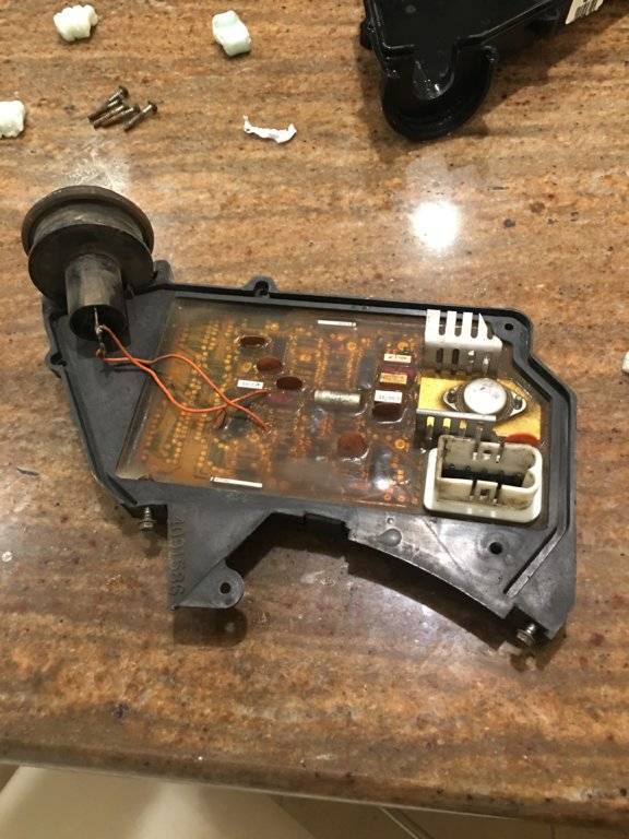

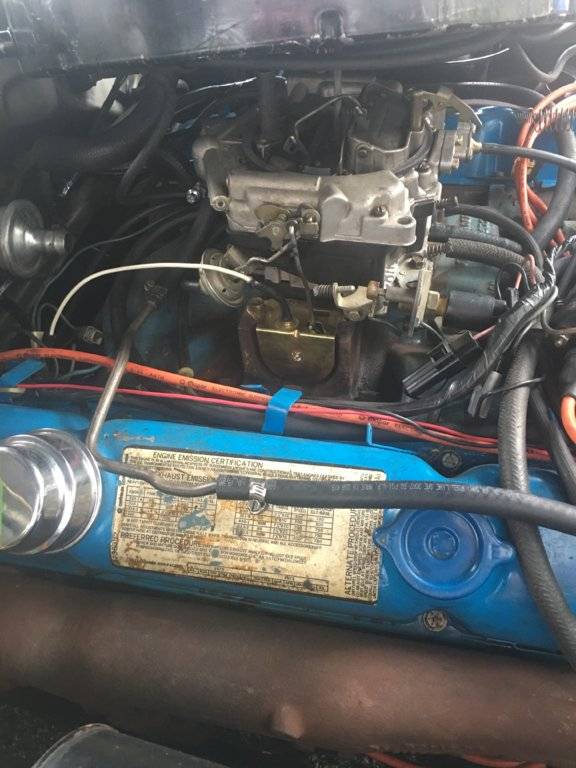

Just out of curiosity, I took one of the junker Spark control system computers apart
Looks pretty well made to me. Vacuum canister still holds vacuum well. Will test it tomorrow as to variable resistance under different vacuum levels.

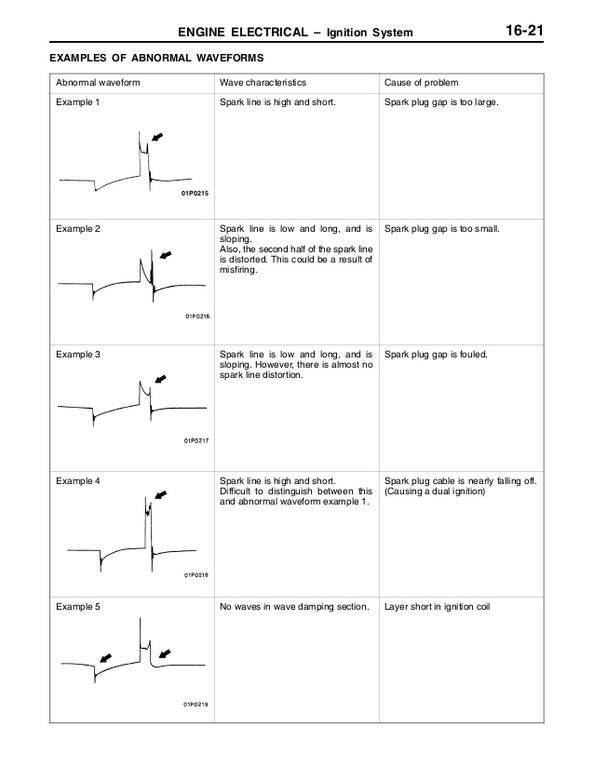

Nice even pattern at idle Javier :thumbsup:

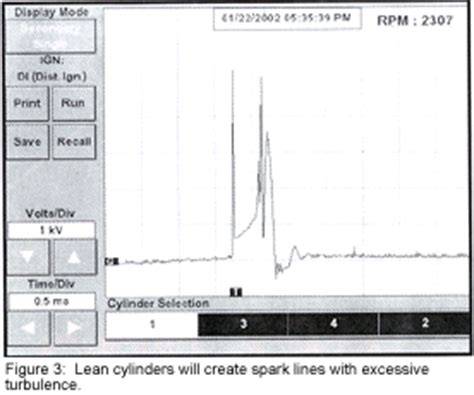

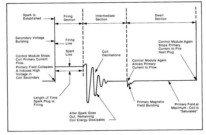

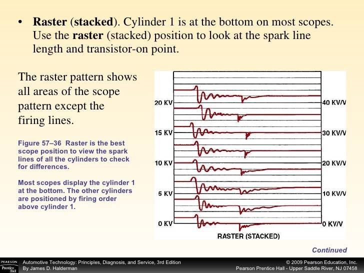

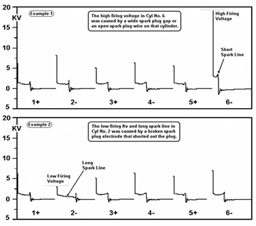

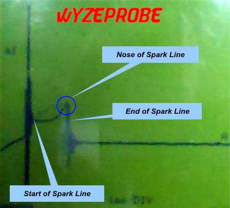

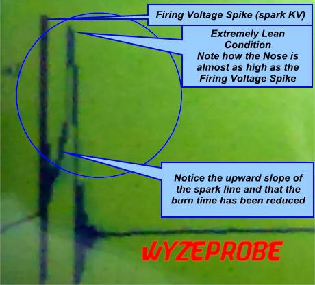

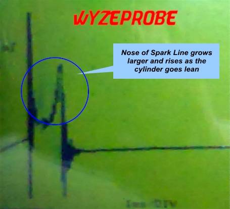

I would recommend that you take note of the intermediate coil oscillation... a good way to spot coil weakness early. I'd also put her under some load if I wanted to pick up weak cylinders better. That pattern you displayed looked really good to me as far as getting even fuel at idle.
All images stolen from the internet...
This would be a "normal" pattern... yours running a tad lean at idle was fine and the way it should be. I saw nothing I didn't like. At the operating condition you start to feel symptoms, the scope can tell a lot... but can be a little confusing to understand.
Basic things that increase KV and shorten duration are high compression, lean, large plug gap, more heat and load.
Basic things that decrease KV and lengthen duration are low compression, rich, small plug gap, and less heat.
The scope doesn't necessarily tell the exact component, but narrows down the search nicely.
IDK if I helped you, but maybe this was useful to others. OP feel free to add to this. I think @Carmine uses a scope almost everyday and may have some fun stuff to add.
View attachment 189975 View attachment 189976View attachment 189977View attachment 189978 View attachment 189979View attachment 189980
