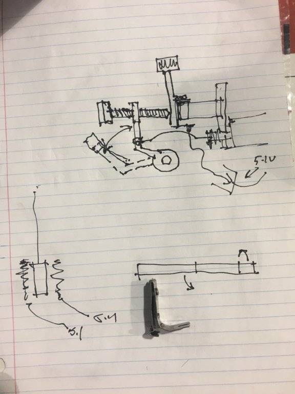

Off idle delay gizmo...

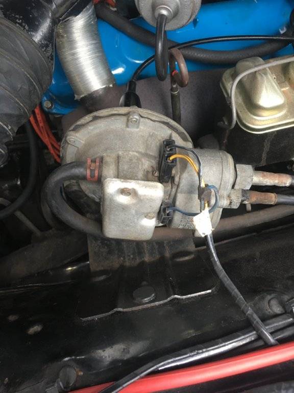

Part of the dead pedal/hesitation I feel may be coming from the instant drop in advance that comes the moment I begin moving the throttle. Aggressive movements are not a problem as much as slight ones.
My theory is that in a normal vacuum mechanical advance system there is a bit of delay that the electronic system may be missing.
To test that theory, I would need to maintain the switch closed for the briefest of moments (1/4-1/2 second) for the mild movements of the throttle that one makes pulling away normally from a stop.
Here’s a sketch of what I’m thinking.... with the stainless steel prototype I made.
The idea is that the contact remains even as the initial slight movement of the throttle is made.
Here is the prototype installed with a small hose clamp on the the contact
Road test seemed to show that the gizmo is working and appears to have solved the issue.
Now to make a less ghetto version of the gizmo.

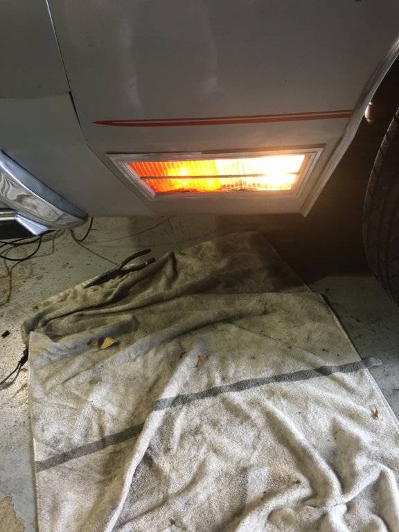

Drivers side marker light and lens clean up between above settings. And..... more road testing.

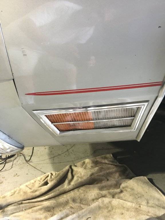

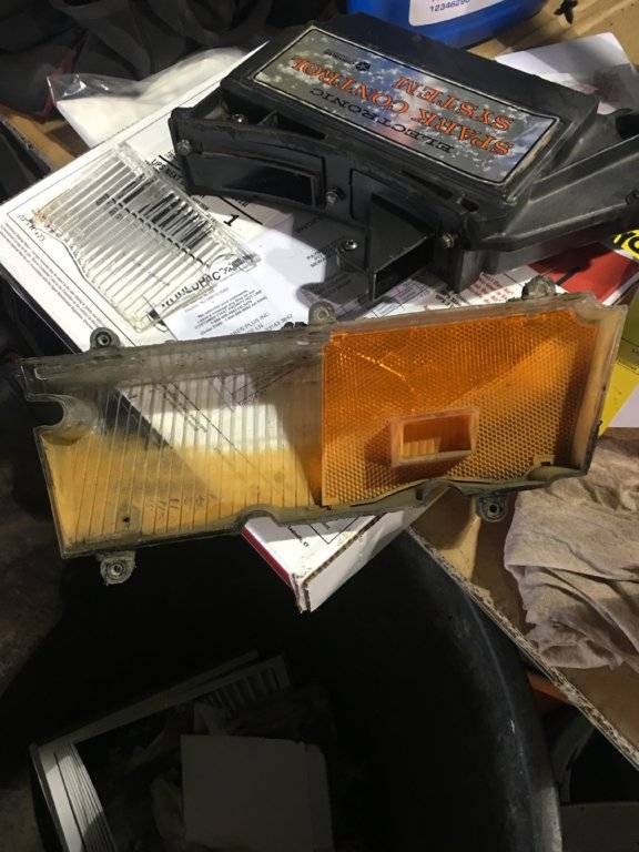

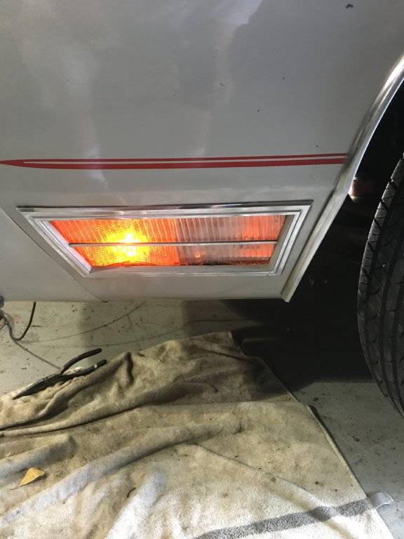

Drivers side running light and cornering light are one in the same. This one obviously held water for a long time and the cornering light metal screw in retainer rusted badly. Will need to get another one.
That’s my new $20 spark control computer which I took to test. Works fine. One more spare for the collection. I really like to keep them original as much as I can. But then again, maybe you guys new that. (Sorry Stan... looks like I’m keeping the ELB for now)

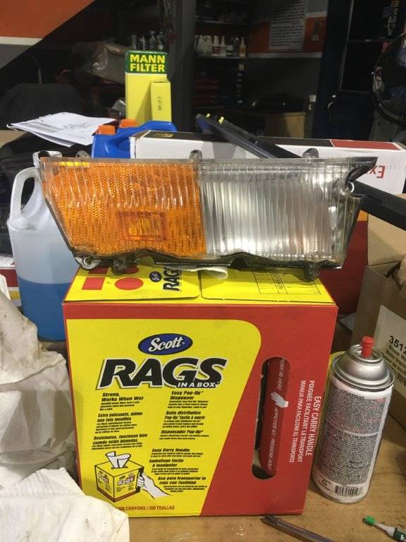

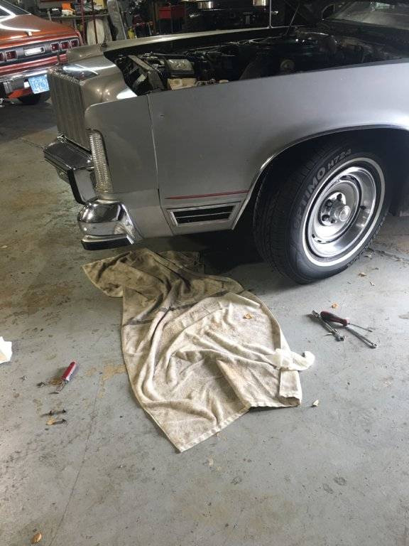

No lift today so it was back to old school work on the floor. It was a little difficult pulling the fixture out without breaking it but I managed.

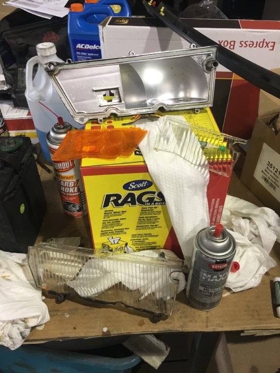

Took the inner lenses out carefully to be able to get at all of rust staining. The orange lens cracked in the fixture as I was pulling it out.
Shot the reflector with this wonderfully shinny alum paint. I recommend it. Most of the reflective surface was gone when I cleaned it.
All together with the help of a little bit of super glue to hold the inner lenses in place. Looks like I did it in a minute but I had to let the paint and parts dry. Polished the outer lens in the meantime. Final result was not NOS but very serviceable I think.
Managed to get it back in with no issues.
The marker light socket was corroded but it was mainly surface stuff. Was able to clean it enough to get good reliable contact with the bulb. This took a while and I had to gently squeeze the white rubber socket, in the end, to get it to make tight contact.
The cornering light works for now but is otherwise toast.

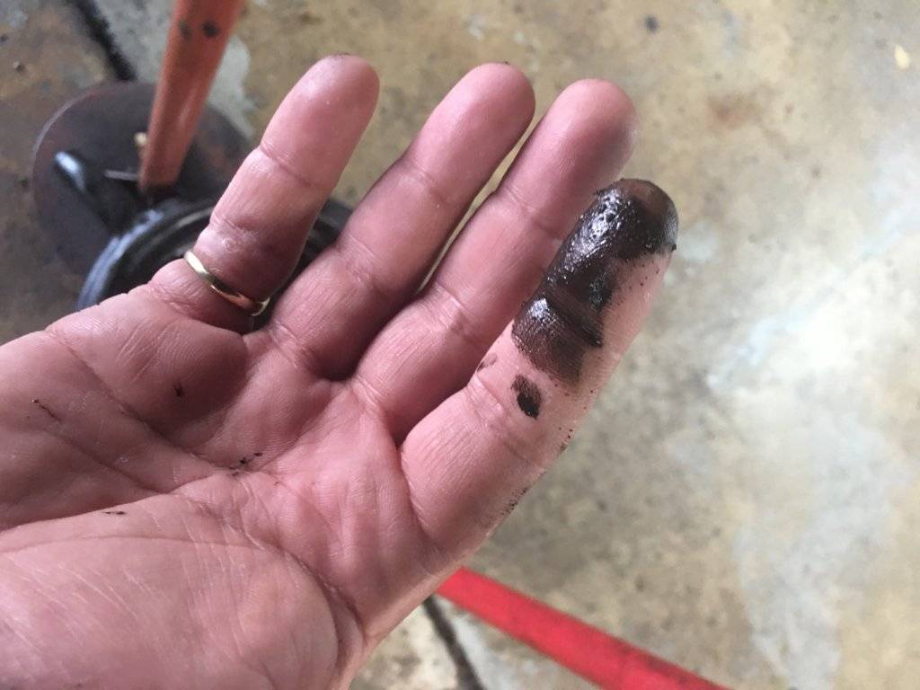

Coolant was totally contaminated with dissolved solids and god knows how many leak additives. This car sat for about 5 years prior to my ownership and was obviously leaking badly at the radiator when I got it. However, the initial flush and sounding of the plugs went well and easy. The freeze plugs themselves looked good and didn’t sound weak when tapped (probably because they were backed up with so much crud).
Up to just recently, the engine was brought to temp with little heat or load. As I began road testing and driving it more, it seems the crud started loosening and moving through the system. I was noticing it was running a bit warmer and heat soak was expelling more, hotter and crudier looking coolant.

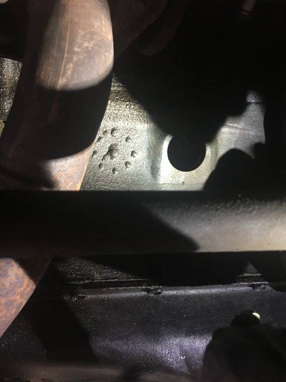

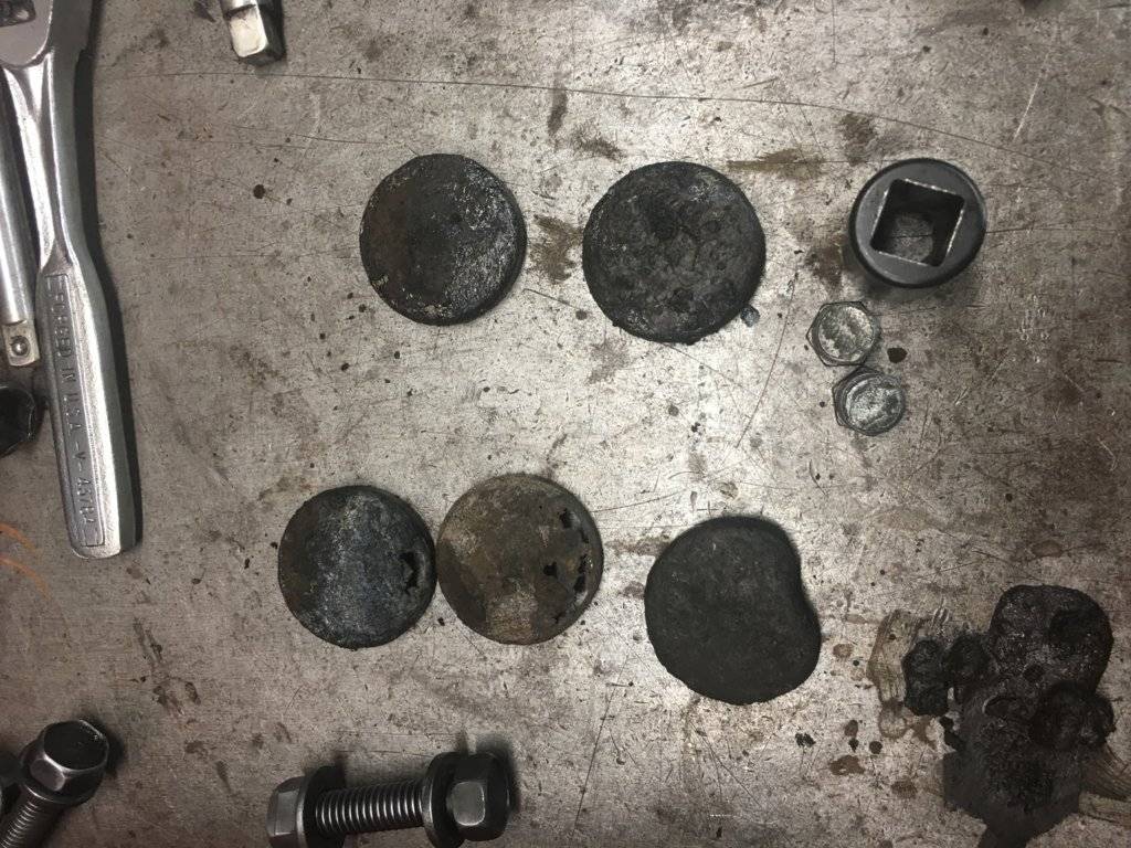

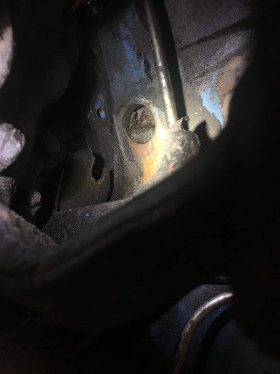

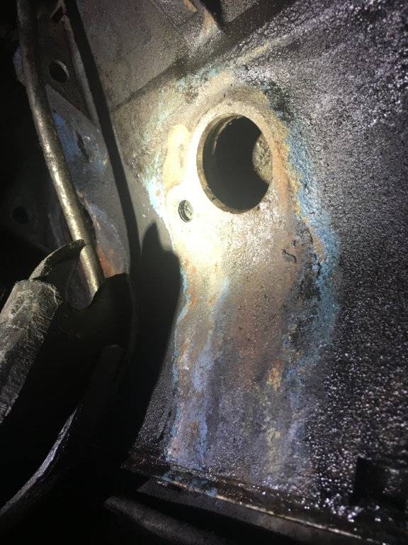

Bottom of rearmost two plugs were toast. Rest were varying degrees of bad. Block is/was full just past the drain plugs with crud. All lower block plugs and drains now pulled. The uppers seem to be good after some sounding to check them. More flushing of the open block, and radiator in progress now with system open prior to light pressure wash before installation of new plugs..... and more flushing. I see more frequent flushing in my future for this car’s cooling system.
The passenger side front was fairly clear
You can see the crud and a lot of non metallic black crud on just a quick wipe. Can somebody say BARR’s Stop leak!?

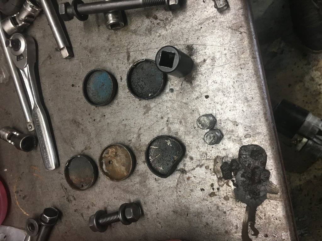

This is the outside view of the freeze plugs pulled before I got there. It looks like some of these may have been changed
The rear view of the freeze plugs shows the varying degrees of deterioration.
Drivers side plug hole showing level of solidified crud.
Crud up solid to block drains.
All getting loosened and flushed now.
As long as I had to pull the motor mounts, they will be changed as well now. Drivers side takes the most torque load and was looking a little iffy with deep stress cracks in the rubber but still not failed....just barely.
