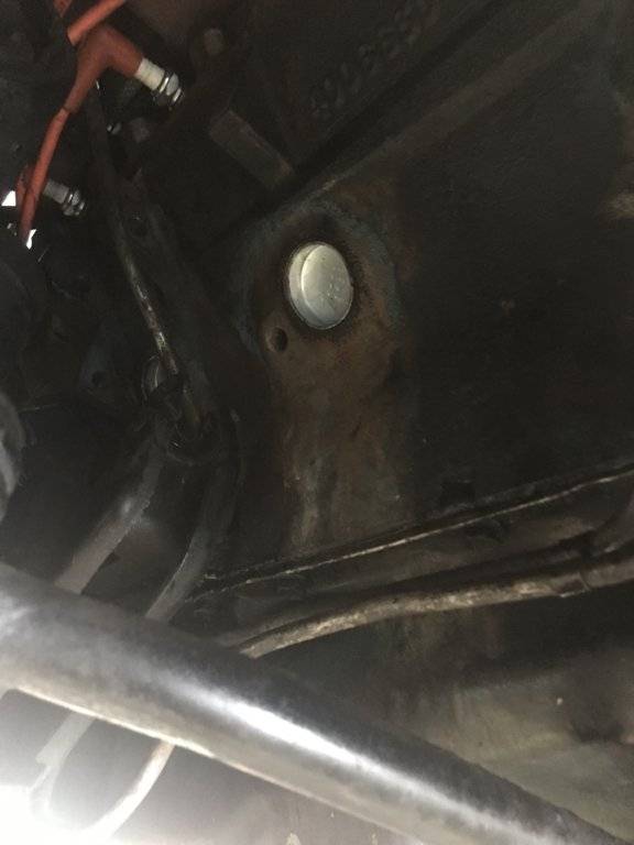

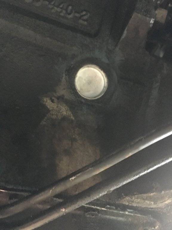

Checked that the new freeze plugs were all in.

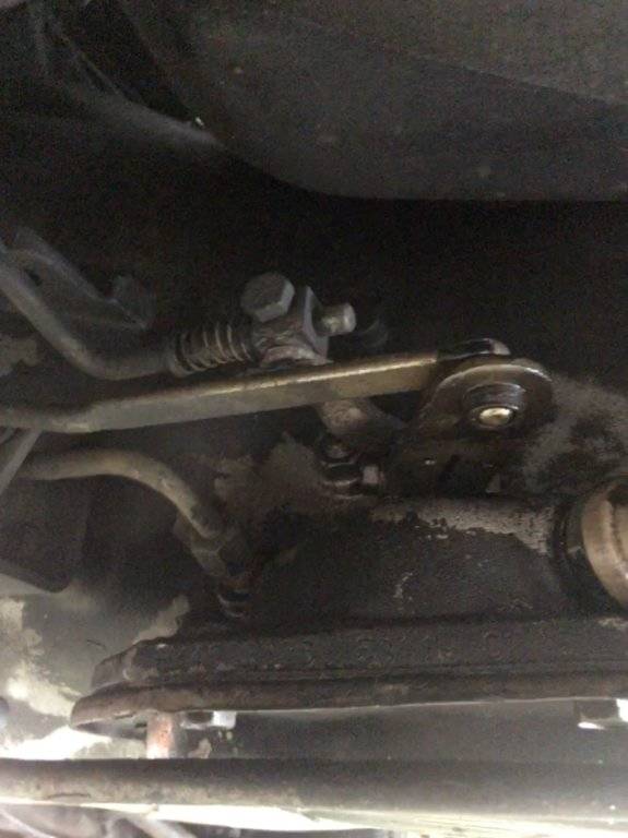

Also noticed where it was I could adjust the kick down linkage.

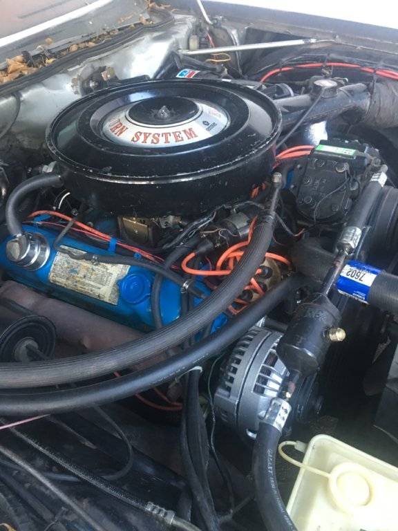

New alternator hung. Why? Because.... base line and ..... it’s shiny.
In and even

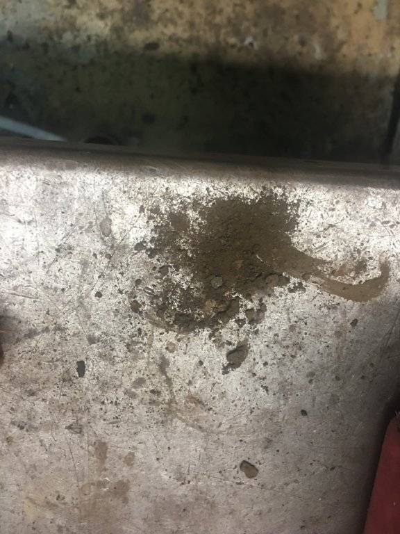

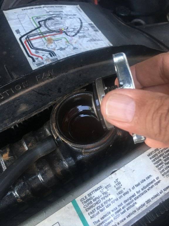

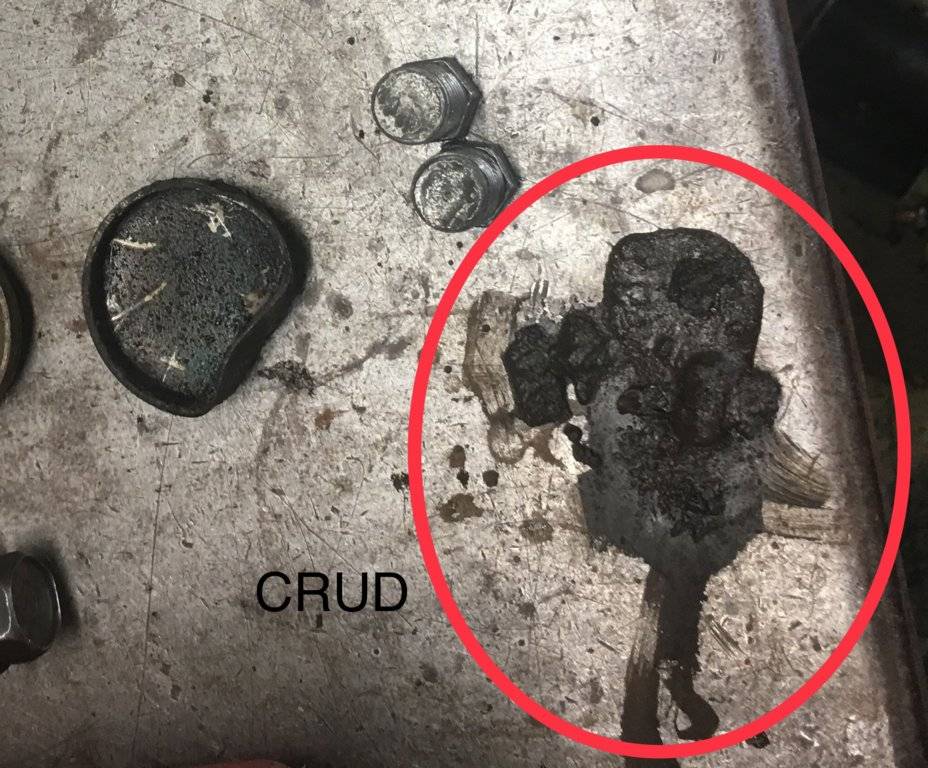

Here’s a sample of the crud we were getting out...
Kick-down linkage adjustment found at the tranny end and not a lot of room for making changes.
Adjusted out 1/8”..... let’s see how that goes.
Waiting on the belts and the motor mounts to come in.
The sludge dries to a fine rust colored dust.
Distilled water and flush is in it now and already almost black with three start and cool down cycles.

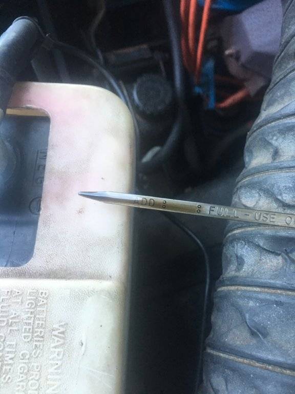

Checked the oil. No water, no foam.
Nice and clear.

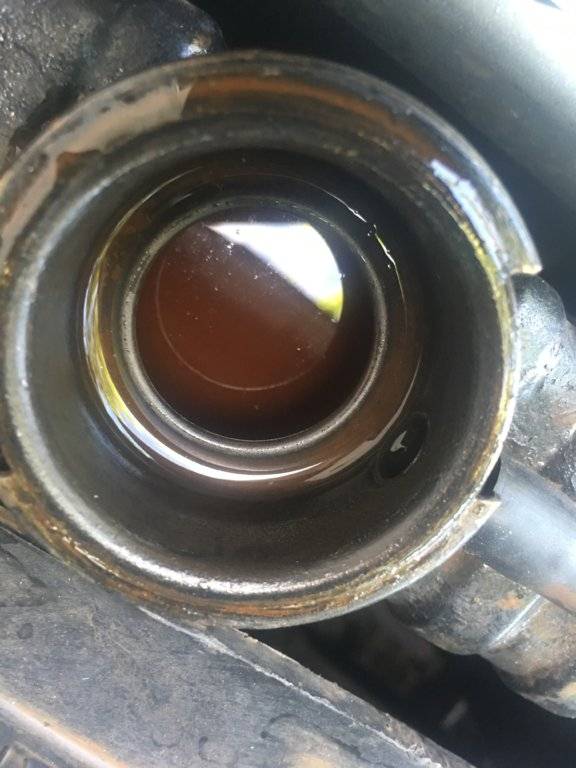

I had a thought as to why he had reported bubbles in the coolant and running really hot at the heads. I had this happen to me before.
I asked him if he filled it when this happened. He said yes. I asked him if it sucked up any coolant after the hot blow off after the heat soak. He said it did but very little. Ok then.
He hadn’t started the car since moving it this morning and filling it with the coolant. I asked how much it took this time. He said “same as before.... about 2-1/2 gallons.” Ok I said. (It takes 3-1/2 gallons btw) ......Astute readers will remember I bought precisely 7 gallons of distilled water for exactly two flushes just 5 days ago.
I then proceeded to remove the top hose and put the pressure testing cap on to it and pump it up a bit, leaving the cap off the radiator to observe the level. It was almost holding with just the slightest loss. Too slight. Ivan asked what I was doing.... I told him it was magic.
I released the pressure and just put my hand over the end of the hose and file d it almost to the top with coolant leaving about 4” and lowered it and raised it a few times giving it a squeeze to help move the slug of coolant in the hose. Held it up to see if I was finished and the hose started to slowly collapse as it slowly drained, finally, through the cleared vent hole in the closed thermostat.
Hooked up the top hose back on to the radiator and very slowly added another 1/2 gallon to the system... right to the rim to see and check for bubbles.
Then I asked Ivan to start it while I checked for bubbles. Sure enough.... a few started coming up but very small. More importantly, the level started dropping in the radiator and I had to keep adding coolant to keep it up to the rim. Then the coolant began to warm and it started to expand in little fits never going over the top and draining quickly to the overflow container. But.... no more bubbles.
Let it run with the A/C on high auto at 65 for about 20 min. to get good and hot and turned it off. Heat soak took the coolant in the reservoir from min to max and no boiling.
Heading back now to check if the system took back the coolant. But it looks like no head gasket issue.
I think he and I both forgot to check if it was really full..... And that the thermostat was allowing it to fill the block to the top and also fill the heads.

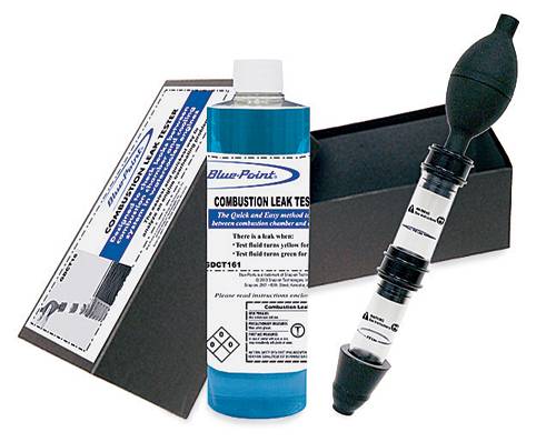

Snapon has a tool GDCT16 (looks a lot like a turkey baster) is a combustion leak tester, that allows you to "sniff" the head space in your radiator or recovery bottle. It uses a fluid that changes color to indicate whether there is burned gases in the cooling system or not.
Tester, Combustion Leak
I'm surprised you shop guy doesn't have one. They are very handy works on both gas and diesel engines.

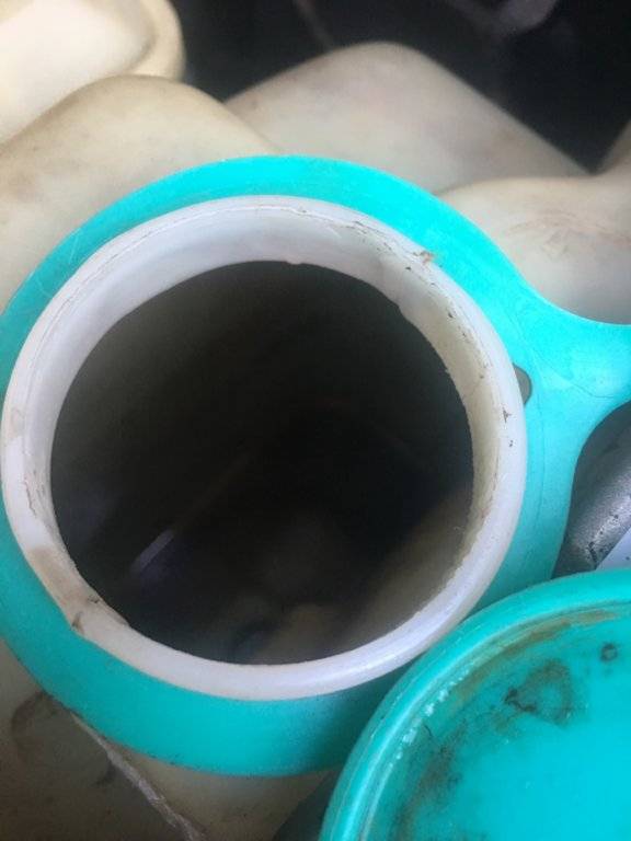

System sucked down the reservoir almost to the bottom...
Need to clean it out some more but also least it didn’t suck it down dry.
Still full.

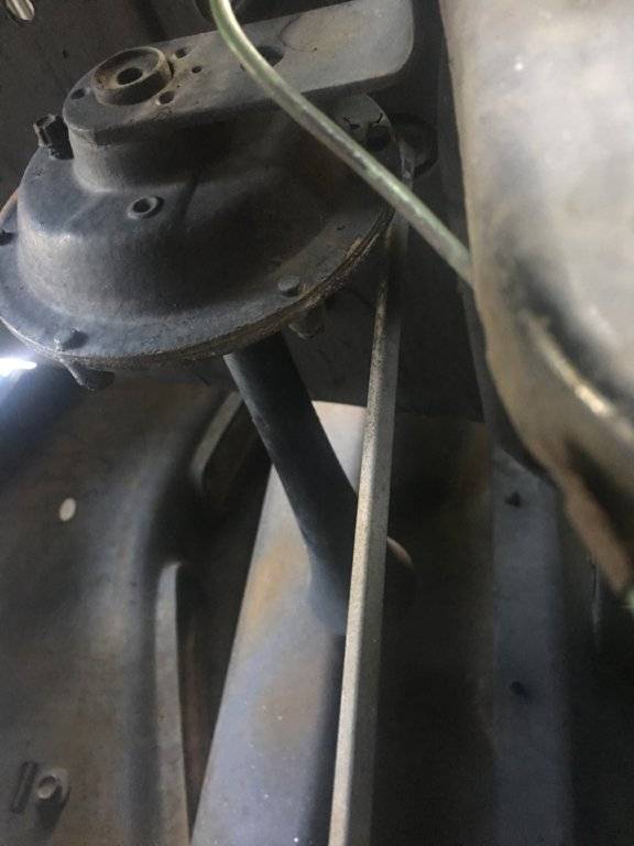

Always something new.... my car is horny.... it has this deep basso horn in the center that I don’t recall being stock. Does anyone know?

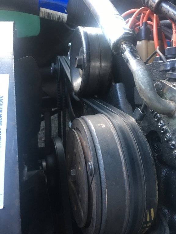

New belts in showing good deflection around the idler popping and dinging almost gone. Will confirm size from Ivan tomorrow but I think they are gates 4095
New alternator looking at home.

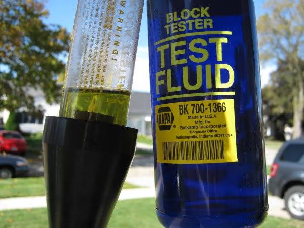

You can buy them almost anywhere... "Block tester" or "Combustion gas tester". Yes, Ivan should definitely have one if he's going to pronounce head gaskets have failed... Unless you have a huge crack or a completely torn out section of the gasket, The bubbles are usually either trapped air or localized boiling.
There are several styles of this tool on the market. They all use the same fluid, which MUST be kept from contamination... I prefer the multi chamber style like Kenny showed... that way if you draw any coolant into the tester, you can clean it out before it ruins the fluid.
The fluid turns from blue to yellow in the presence of high concentrations of CO2. Don't be fooled by anything other than a strong yellow reading... It's easy to see if you draw your breath (cup your hand and exhale) through the tool, once it has color changed to yellow, draw fresh air through it and it will go back to blue. The fluid can be reused, but if contaminated, it will ruin the entire bottle.
Single chamber tools like I've shown are on the shelf at the parts store... their downside is how easily the fluid can be contaminated. The multi chamber tools are very common too.
TECH HINT: on a car with a minor head gasket or hairline crack... you must run until the thermostat opens and enough combustion gas has seeped through to the radiator... you would NEVER see bubbles from this leak, but the tester will show the CO2... It has taken me an hour to PROVE a minor head gasket failure with this tool. It would be faster without a thermostat or even without coolant... but you'd risk creating more problems.
