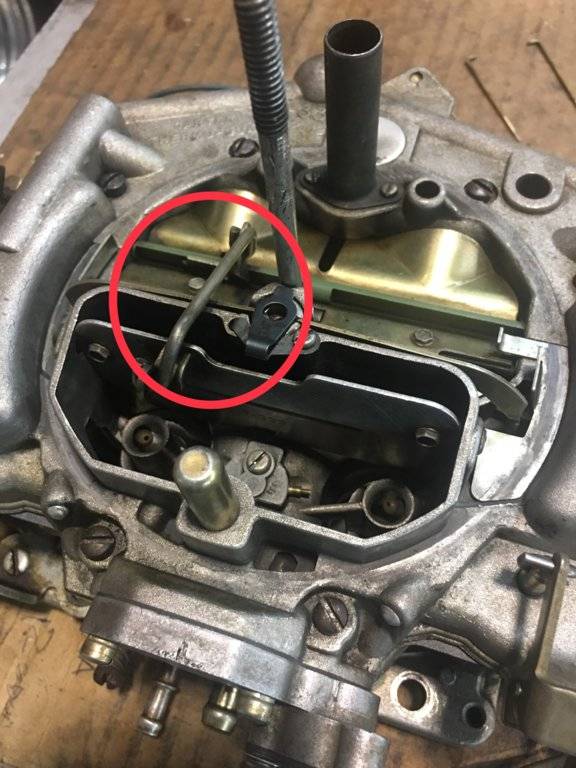

Morning drive good so far. I’m thinking choke may just be coming off too early.
Top link controls closure of choke full on and was good when I checked it. Will start by checking that again. Carb height has effect.
Full off should allow choke to be completely vertical like shown here.
Full on choke should be almost fully closed with 3/16” open at leading edge... with vacuum pull-off fully engaged.... i believe.... need to check that first.
My memory is no good which is why I keep books!

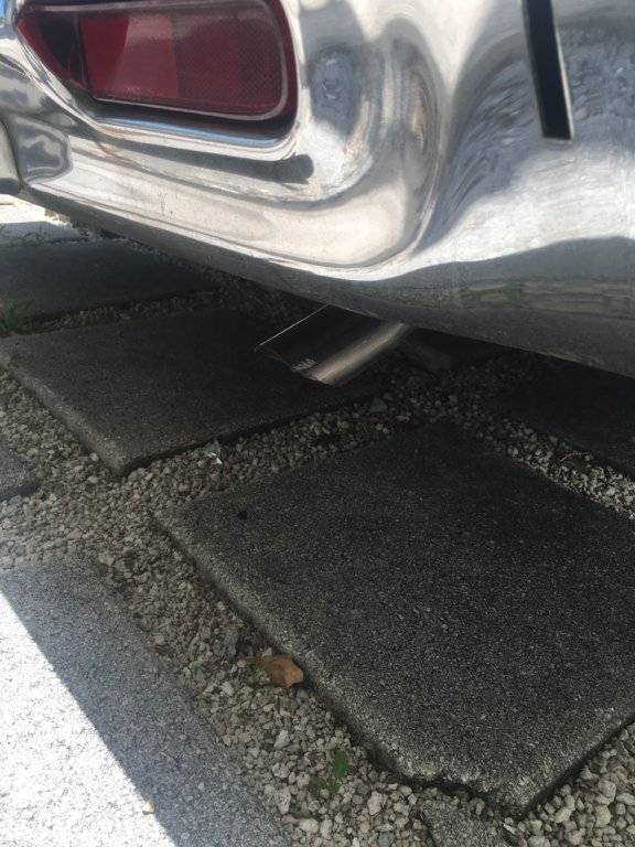

Sexy new tail pipe..... opted out of the chrome tip option.

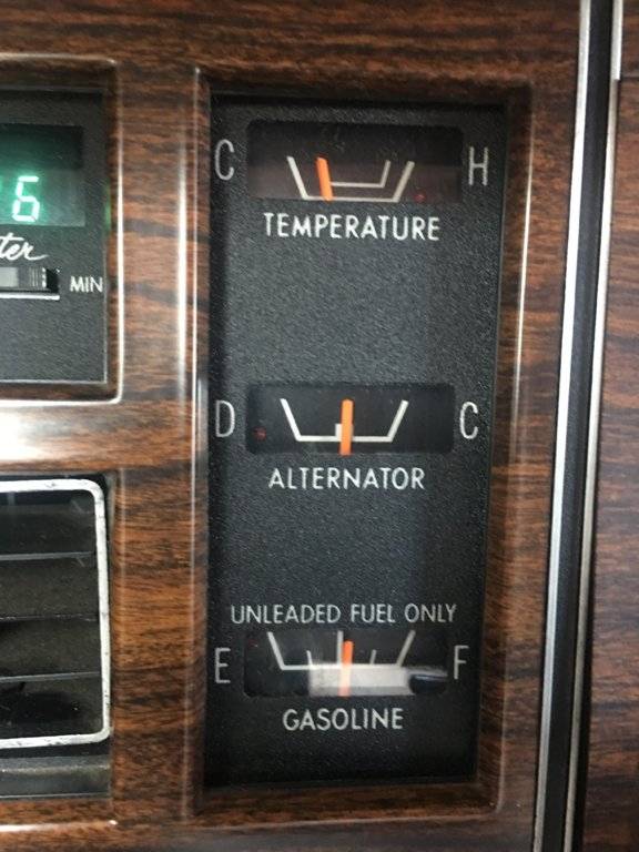

15 miles later.... at the office awaiting the end of the day. No bubbling or blow off and it was lunchtime traffic all the way. Needle on temp gauge went just into the lower normal temp range marked area on the gauge. Had my eye glued to it the whole way.

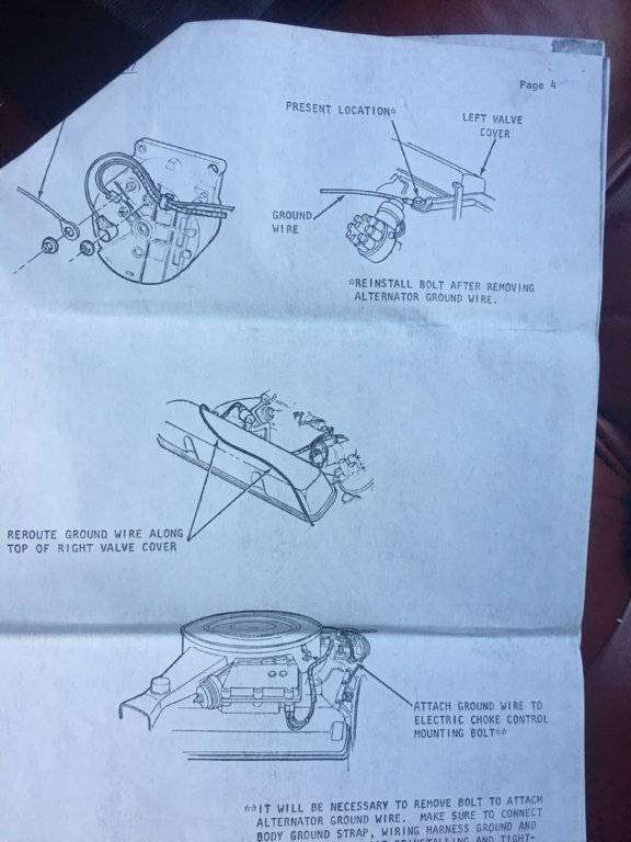

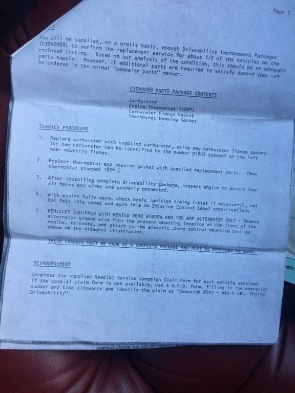

Found some old paperwork under the spare tonight as i was cleaning out the trunk of spares before showering to go to dinner.
Seems that the 78’s were recalled for “hesitation”. That called for a carb swap among other things. Figured I’d post them for posterity. Enjoy!

BTW... the car has the 9180s carb on it. So it was done. It’s an odd number on the master list of carbs.
http://www.retrorarities.com/images/CarterThermoquadInformation.pdf
