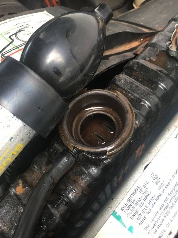

Leak test initial results.... no leak in head gasket.
Got the Napa kit and tested it after shut down and heat soak movement of coolant into the reserve tank... pumped the bulb for over a minute and saw no change in color.
This tester does a good job of aeration of the testing fluid with the sample air.
Tomorrow I will drop some of the coolant out to get a good “sniff” directly from the unpressurized radiator.
This is the first time I’ve used this system of testing for head gasket leaks.....so any advice is much appreciated.
But... so far so good.

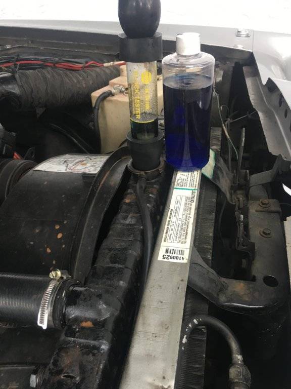

You're only going to catch it that way if you're lucky (unlucky)...
Think like this... A minor head gasket leak or hairline crack will usually only give a tiny bubble every so often, cylinder pressures multiply dramatically as the engine is put under load and heat moves metal enough that during a casual drive you could generate a good sized pocket of CO2 and if driving long enough could push enough coolant out with the pressure to cause an overheat.
A moderate head gasket leak can over pressurize the cooling system and will sometimes cause parts to break... a burst hose or sudden loss of coolant from something (like your heater core) could be caused by this, but also could have been the cause of the head failure.
The best test for you would be to run the car to temperature with the coolant level lowered enough to prevent it from spilling over. As soon as the thermostat opens, see if you have detectable pocket of CO2. After that, you can run the car at idle or take a quick run around the block with cap on to the first position only (it shouldn't build pressure, but use precautions removing it anyway) then execute the test again immediately... do not shut off the engine during all of this, it will only generate CO2 while running and you are trying to get it to produce a big enough pocket of the gas to set off the color change.
If after some effort to produce a failed result, nothing happens... you are probably safe. The only thing you could do after that is to send a coolant or oil sample in for lab analysis at your next service interval. That's more common for a heavy fleet to do, and IDK how common it is even then... but oil analysis could pick up traces of coolant if a very minor problem exists.

The two part or two stage system, however you want to call it, that we have is just more accurate. You'll be fine, just proceed the way Jeff described and I think you'll be ok.
From the instruction manual...
"Combustion gas, when it enters the cooling system through any leak, accumulates in the air cushion above the radiator coolant level (in sealed coolant systems, this air cushion must be created by lowering the coolant level about an inch and a half). The Leak Tester analyzes this air: The blue fluid turns yellow when CO2 gas is detected in gasoline engines and green in diesel engines. The double-chamber feature of the Leak Tester assures a high level of accuracy. Conventional detection methods often give incorrect readings because alkaline particles present in the air cushion can cause false indications of a combustion leak. Alkaline particles are absorbed by the Leak Tester's first chamber, which acts as a filter, allowing only air and CO2 to reach the second, upper chamber. If the blue fluid in this upper chamber turns yellow or green, it is proof positive that there is a combustion gas (CO2) leak into the coolant."

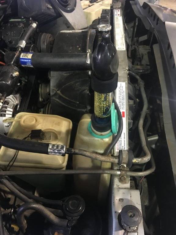

Thanks 78 Brougham! Here’s what the single chamber test looked like when I did it.
Brought the coolant level down to just under the level of the tubes in the radiator. I wanted to make sure not to draw in any of the coolant into the tester
Made sure I had a good seal and tested it by putting it under a little bit of vacuum. Released the vacuum and reinserted the tester.

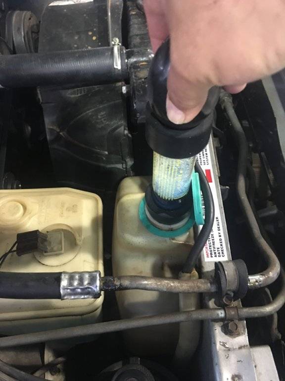

Started the car to watch and allow any gas in the system to have to go through the tester as the system warmed up. As soon as the thermostat opened I was rewarded with a good bit of gas going through the tester.
After the test it looked ever so slightly green but still dark to me. I’m thinking this is a possible false positive and will get the two chambered tester to make sure.
One thing for sure is that head gasket leaks don’t tend to get better. I think I’m safe in driving it around town for a few hundred miles. Keep a close eye on the coolant level in the reservoir, check the radiator to make sure it’s completely topping itself off in the morning and then.... flush out the system as I try to get the system clean.

You did good. The green meant nothing, unless you happened to draw in a little coolant... which ruins the fluid. If in doubt, draw your breath through the tool (exhales) and the color should change before you pass out...
I rewatched you video, and as much bubbling as she did, nothing said head failure... you could continue to pump air through it for quite a while before proving one, but I would say you look good. Drive her, watch the coolant level religiously and if you see any loss of coolant... retest for the head gaskets.

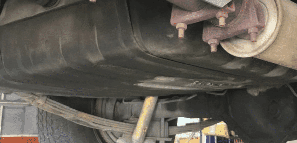

Your car is absolutely gorgeous!
Just in case no one else mentioned it, the shiny spot under the gas tank, with no undercoating, appears to be a repair. The undercoating may have been removed by leaking gasoline, as it did on my 1977. It's probably not leaking now. Just keep an eye on it.
