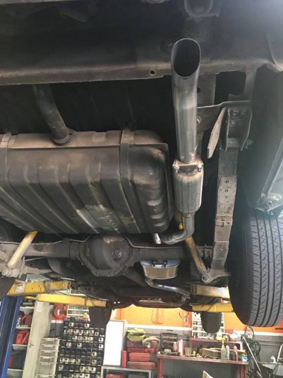

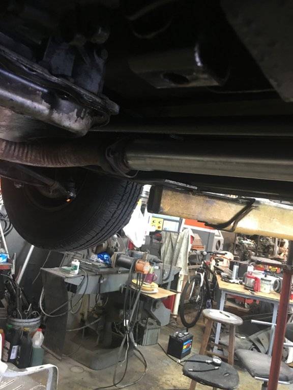

New exhaust.....
From the front Y to the tail pipe.... $440 all in. I liked that number....

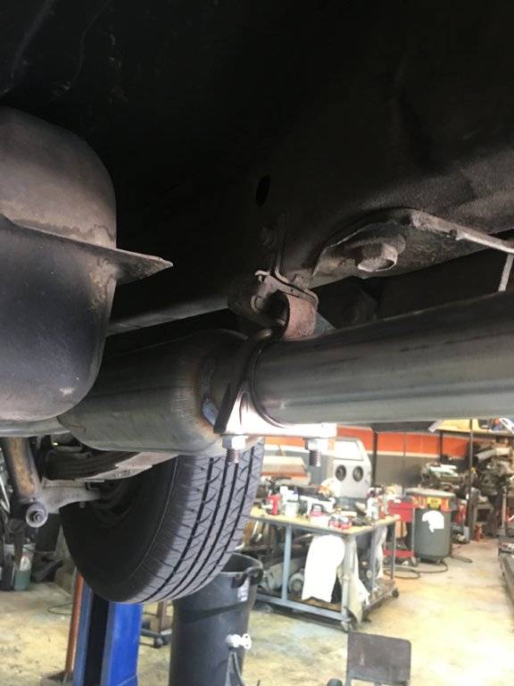

Just one clamp (not three) at the tail pipe. Dig the cherry bomb resonator but it may be a little too sporty sounding.
Catalytic comberters? We don’t need no steenking catalytic comberters....

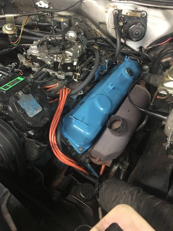

valve covers getting a respray without the sticker this time.
Checked the compression and all 8 were +/-5 lbs around 165... no outliers either way.

Looks good, but isn't it a bit close to the fuel tank? I don't know these things so I (respectfully) ask.

In answer to your first question. No, I don’t think it’s too close. I have about 1-3/4” clearance which is a little more than what I had with the original resonator.
Ok, wasn't sure how close one can get before it's an issue.
