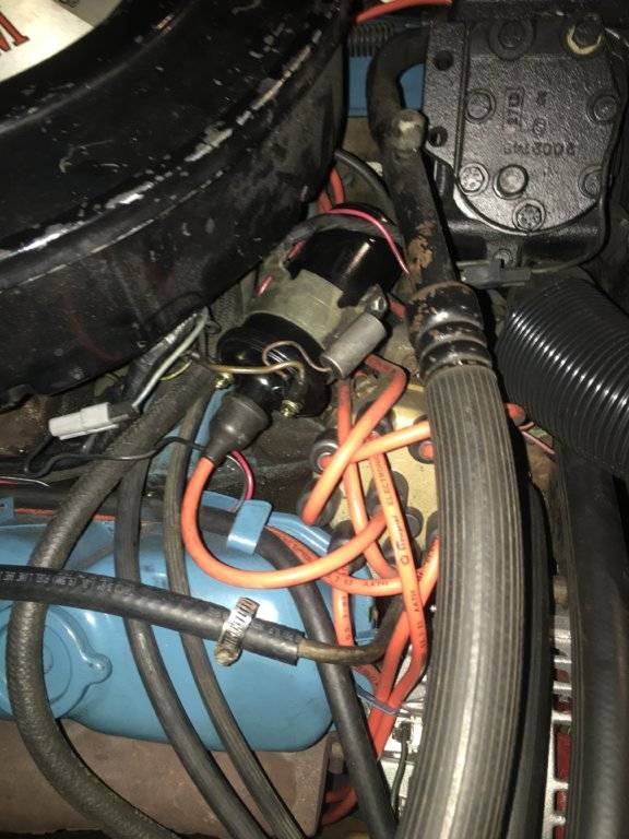

Re-sorted the ignition wires on the passenger side.... Antonio ran them inboard of the alternator when he changed it out for me. No biggie.
Swapped out the coil as the one in there was original and was on my list of suspects for my rough idle. Idle now smooth..... but I’ll need to pull the plugs as they are surely fouled. I’ll have to wait on that until Saturday when I can put it on a lift for the drivers side 5 & 7 plugs.

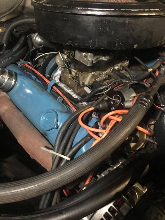

Ghetto gas line gone!
New insulated line in! Put an insulating reflective sleeve over the line I got from Summit.

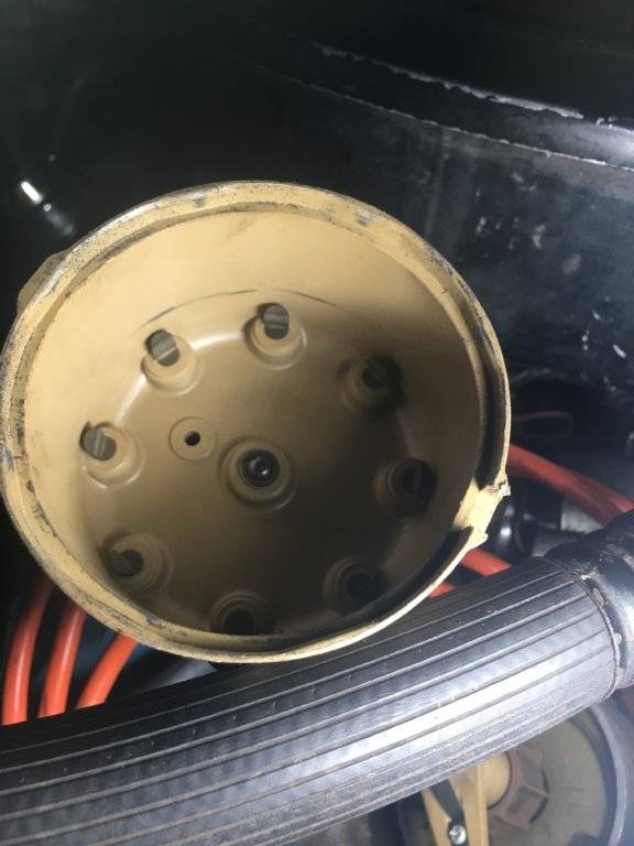

Found a carbon track on the inside of the distributor cap. There was a scratch on the inside that had collected carbon dust.
Sanded/ polished the scratch out with some 500 to 1000 to 2000 grit passes.
New cap ordered. Accel mopar cap.

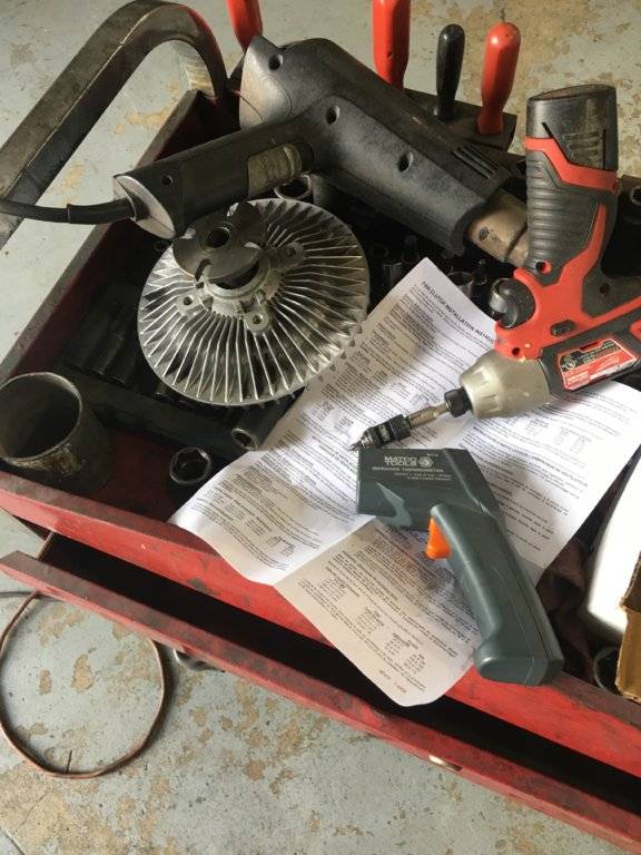

Fan clutch was pre-tested prior to and after. installation as follows:

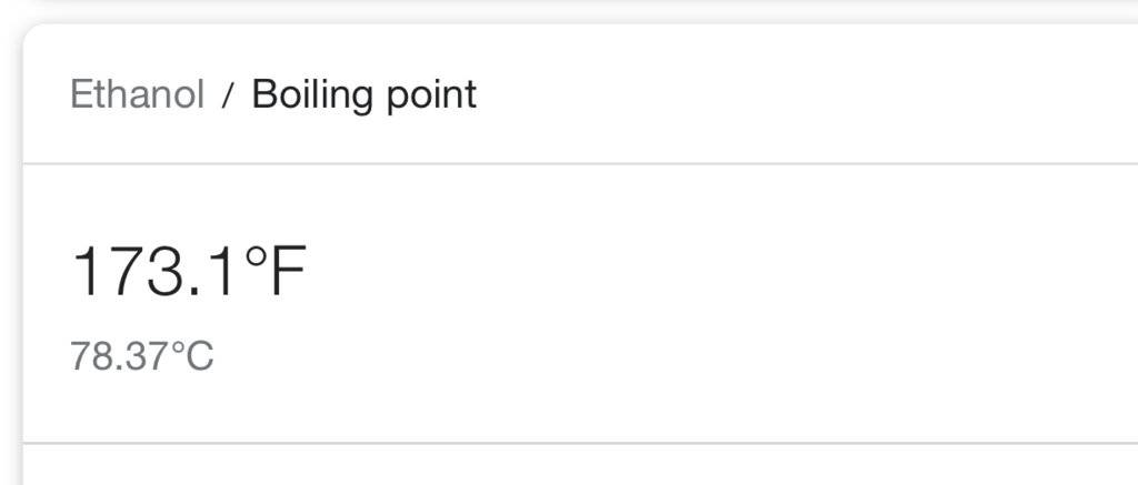

Then thought... bad gas issue from boiling ethanol... went to non ethanol. (Had similar issue with Citroën). Better but still. Went and changed ghetto fuel line. Last vestige of PO “fixes”.

The heat gun is used to heat the bi-metallic coil to see if it turns the valve on the front approximately 90 degrees or so when the thermometer reads that the bi-metallic coil is at a temp 20 degrees above your thermostat. If it does, and it turns the valve at the center of the coil, you turn it a few times to see if it starts to build resistance as the silicon fluid is released. If it does, you’ll be able to feel it pretty quickly.
Here’s the best video I’ve seen regarding thermostatically controlled fluid drive fan clutches:

Valve on old fanclutch found defective. Stuck.

One tech hint, having looked at your video... those cheap IR temp guns shoot a 6" circle when held 12" from an object. The laser is plain ridiculous when you think about it... your readings will have more accuracy when you hold it 1/2" from whatever you want to check.
BTW, pre-testing a fan clutch... very creative, and I did like the idea... for checking an old one. I'm sure its not anal at all to test the new one :rofl::rofl::rofl:

I tested the new one because I didn’t test the old one when it was new less than 4 months ago!!! Crap!
