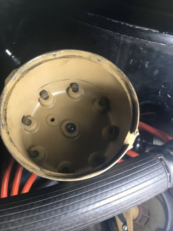

Found a carbon track on the inside of the distributor cap. There was a scratch on the inside that had collected carbon dust.
Sanded/ polished the scratch out with some 500 to 1000 to 2000 grit passes.

Javier: Sorry for such a late reply to this posting, but this picture has been bothering me ever since I first saw it. That scratch on the inside of your distributor cap indicates a potentially worn distributor shaft bushing. There appears to be too much run-out which is causing the tip of the rotor to make contact with the inside of the cap. This is not good. I know its a pain, but I think you should pull that distributor and check run-out on the shaft with a dial indicator. If you already did this. . . Never mind. . .
Awe jeeze. Now you've got him thinking...
Good point to check. It does have a little more runout than it should. But from what I saw, it was scratched at the time of installation by the tip. Ivan put it on when it arrived and apparently it was not set down and secured by the inboard clip that may have caused the hairline scratch. It may have also come that way from the factory. Either way.... NFG.
The cap electrodes, with the cap fully and correctly set and secured, extend about 1/8” past the rotating end of the rotor. If the runout was excessive, the rotor would be striking the inside of the machined electrodes. I saw no evidence of that.

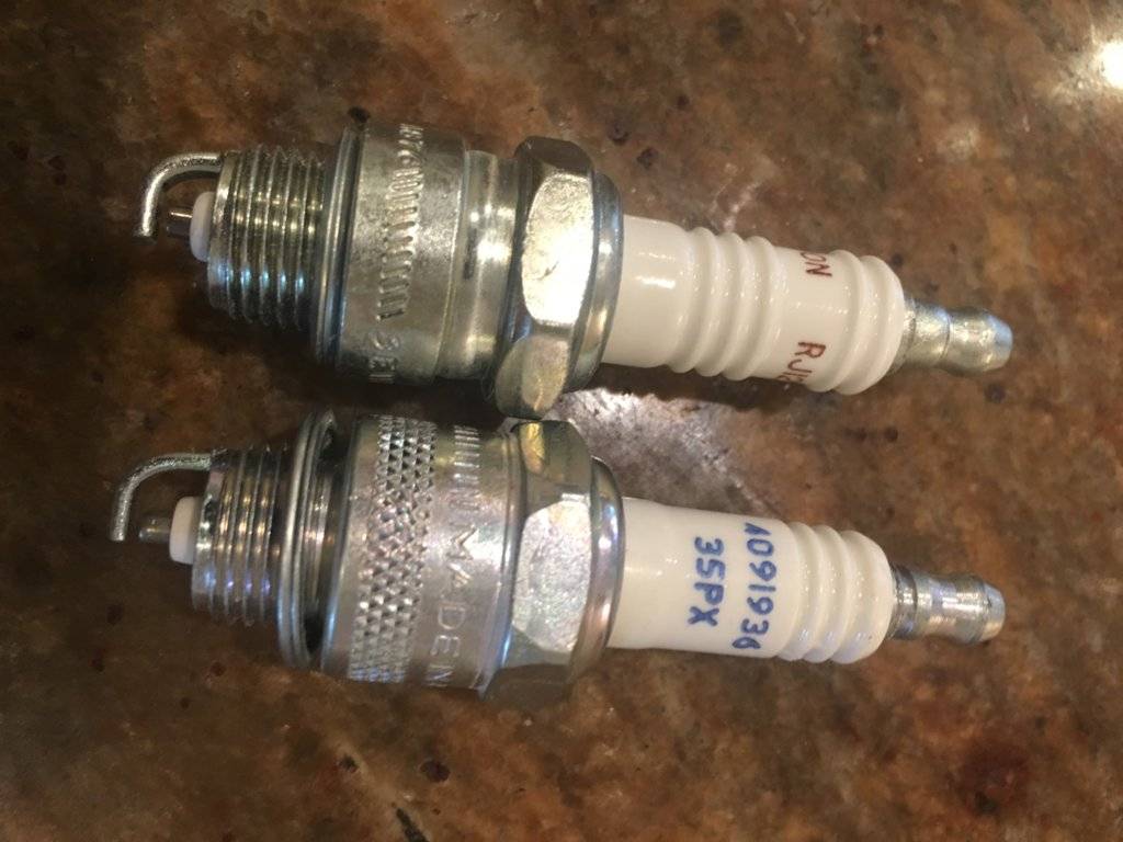

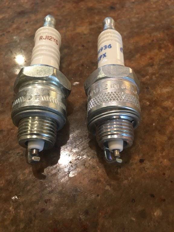

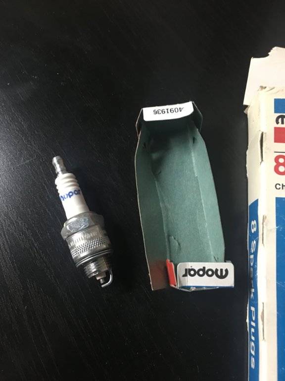

And, I also got a set of NOS correct plugs.
Correct for 1978 400 and 440 lean burn engines.....
See line 5... designed to run hotter to help resist fouling at low rpm.
35PX plug.
Champion RJ12YC resistor plug with copper core....

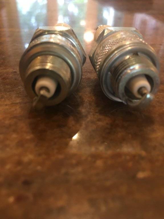

Side by side.... OEM and Champion
OEM plug looks to be a bit hotter than Champion RJ12YC. OEM plug is also showing more of the electrode.
You can see that the OEM plug (35PX) has a thinner ceramic surround on the electrode.

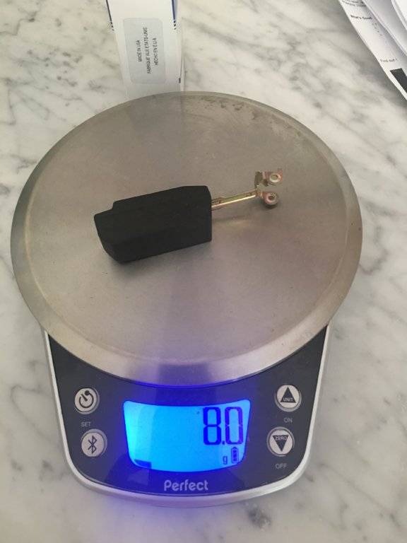

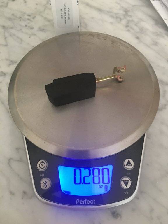

How much does the float weigh.....
It’s my “perfect drink” mixing scale............. 101 Uses!!!!
