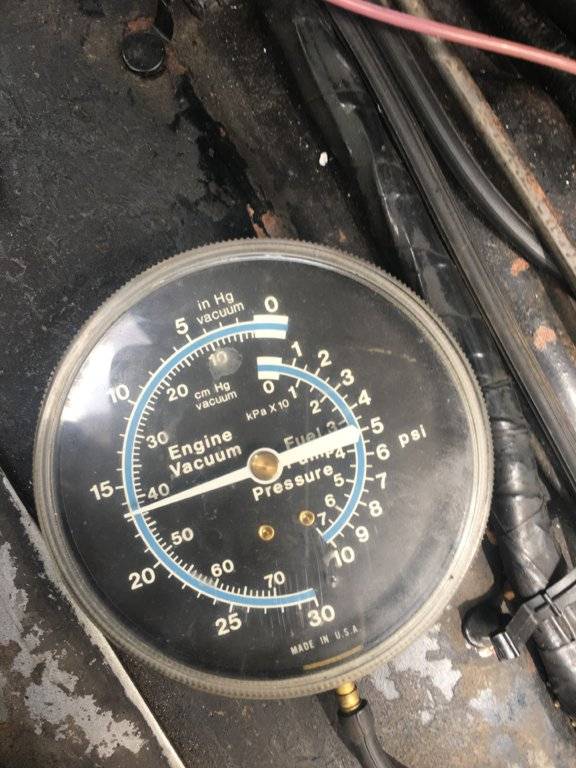

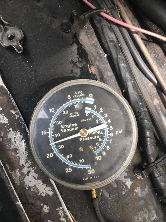

Engine vacuum:
Engine produces just under 17 in.Hg in neutral with A/C load.
And just over 17 in. With no load. Needle is very steady. In gear it drops to 12-13 and a little wavering. Accelerated from a standing start, engine vacuum drops to 6 but pops up when you get to speed. (I used a Very long vacuum hose) And again down to 10 or less at throttle tip in (depending on amount you tip)

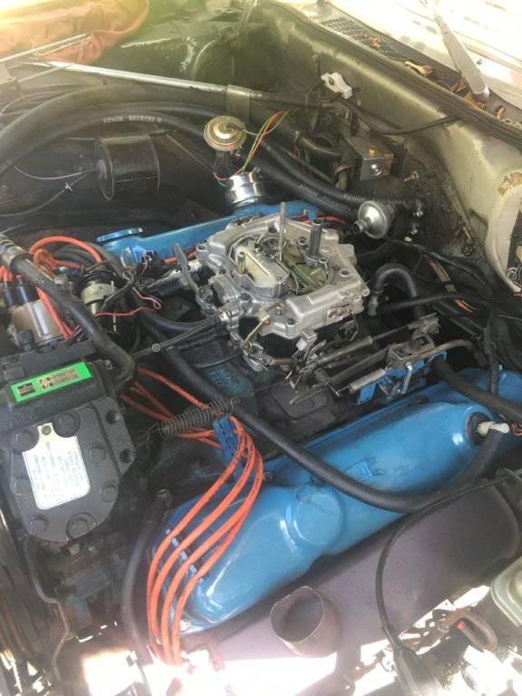

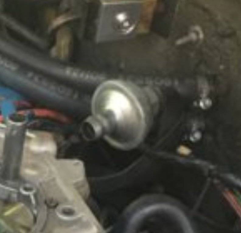

What the hell is up with that long hose from the PCV?
Where is it going to?
And what the hell is this?
First.. PVC line is a little long. So sorry Will trim accordingly.
Second, its the air valve aspirator for the exhaust. It’s connect to the back of the exhaust manifolds to introduce air into the exhaust stream. Helps light off the catalytic converter and raise the exhaust temp.
My catalytic is gone. It draws no power so I left it. It’s working fine.
PVC hose is too long... my apologies. Replaced the carbonized original and left it too long. Will trim accordingly.
No air pump. The shiny thing is the exhaust Check valve to allow air intake that is connected to the back of the intake manifold. It’s meant to introduce air into the exhaust stream to help light off the catalytic converter. It raises the exhaust temp.
I don’t have a catalytic converter but this draws no power so I left it.

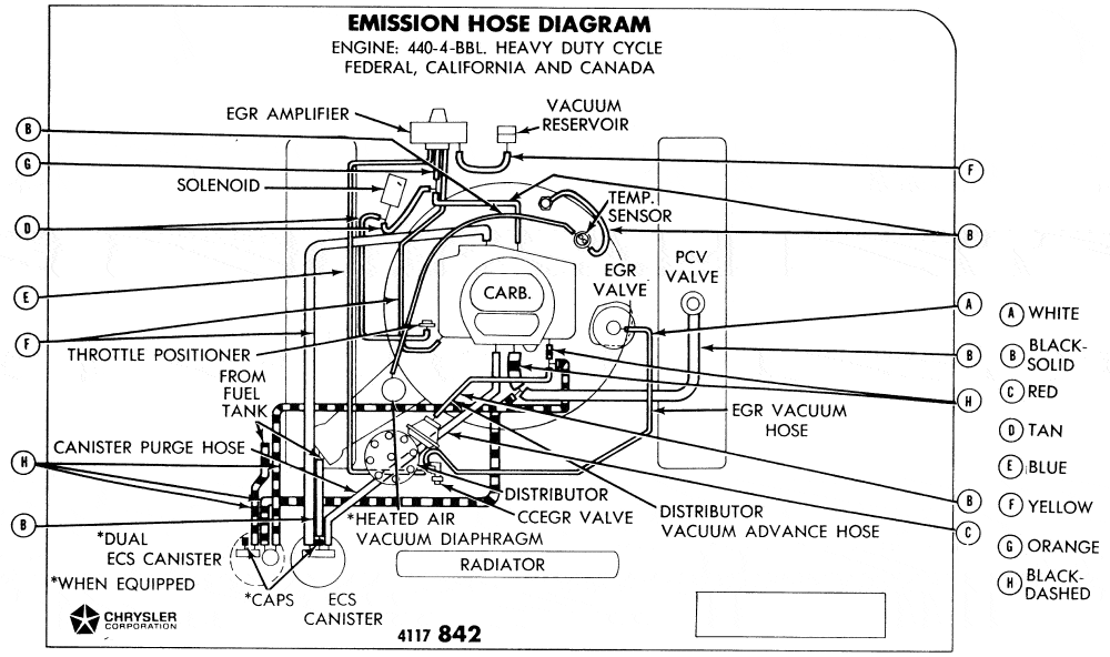

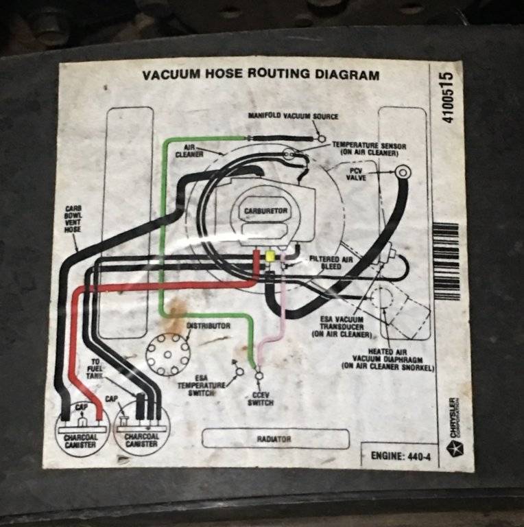

Here’s the emission control diagram....
No air pump on this car and no EGR....
