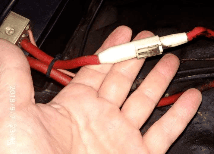

Thanks Stan....Halt. Put away the DMM fefore you have half the car torn apart,
I already know the problem.
Just a bad connection due to age. Clean it up and make sure the connection stays tight.Thanks Stan....
Describe it please....what is the repair?
The P.O. had that connection with an external wire tie that I took off just before the problem started... I guess I’m the cause this time.
But I don’t understand why that big connector would fail due to engine heat.
OK, I was wrong.Did it again today
So how do you take off the reluctor Mr smarty pants?OK, I was wrong.
But that connector needed to be cleaned, anyway.![]()
