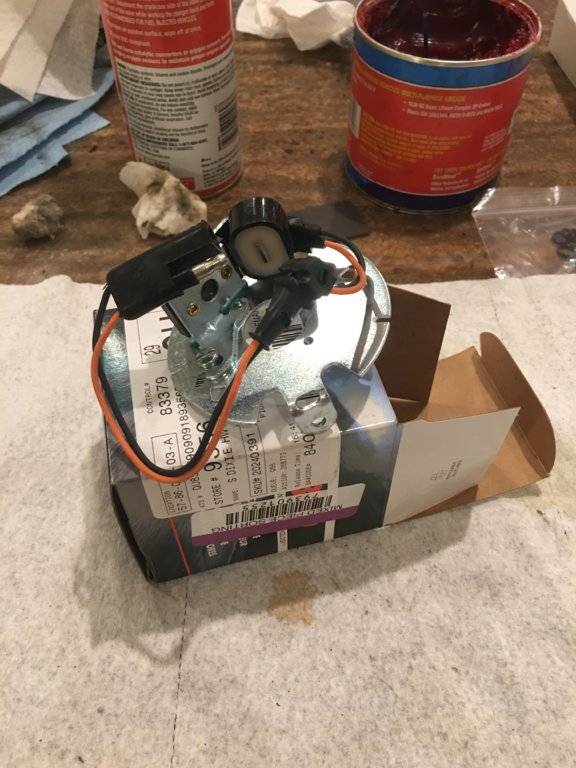

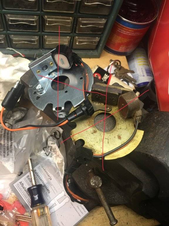

Bummer, those reluctors will go on either way (upside down ) sometimes it helps with the rotor to cap phasing. Maybe that was why yours was off.
Nope, the pick up coils are different.
Forgive the crude lines... fingered it.
Coils and pivot points are rotated clockwise about 12 degrees. Advanced!

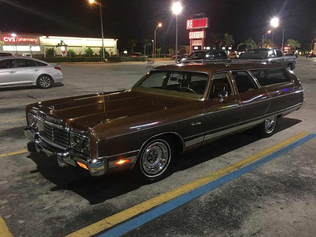

She’s still in the corner. I said a few days and I meant it!
I think I’ll park the newly washed wagon next to her so she can see what a good girl gets when she behaves.
Here she is looking spiffy. She’s working so nicely that I just bought her an NOS grille.

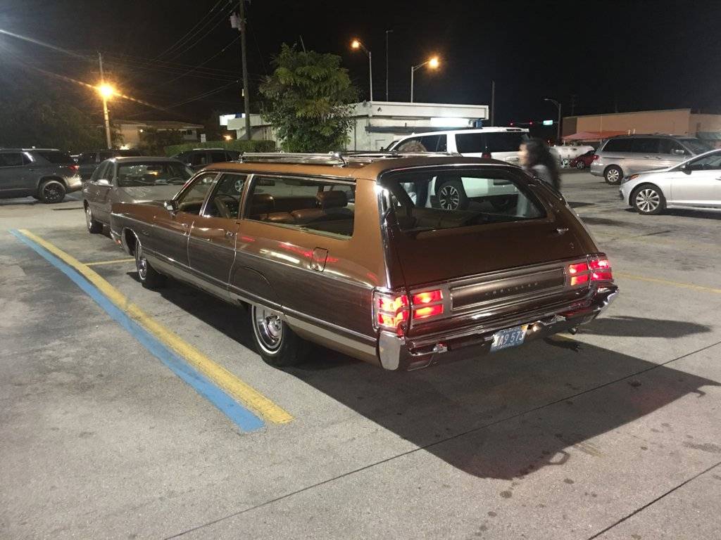

Ahhhh what a caboose!
My other good girls. Out for a ride to buy some Cuban coffee for our morning café con leche.

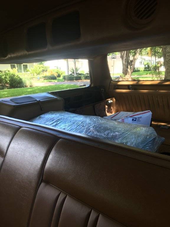

Any interior pictures?
Jeez! That wagon is outstanding!
Just for you Bob!!!!!
The rear A/C unit is the correct unit but not original. Usually, they were bone white to match the headliner. As this car did not come with this badly needed option for FLORIDA, it had a tan headliner (car originally from Illinois). When I overhauled it, the vinyl was badly stained (some kid with a bic pen did it, could hardly see it ... but still) so I recovered it to match the headliner with elk grain vinyl and painted the grilled and vents to match. Looks very good but is not strictly “correct”.
Also added were the towing option trans cooler and larger three row radiator.... It’s that FLORIDA thing again. Power antenna was also transferred as well (from its predecessor prior to its sale).... A nostalgic reminder of its service to me in building my house.
Other than adding that option, it is original and correct. The car came loaded and in great condition.

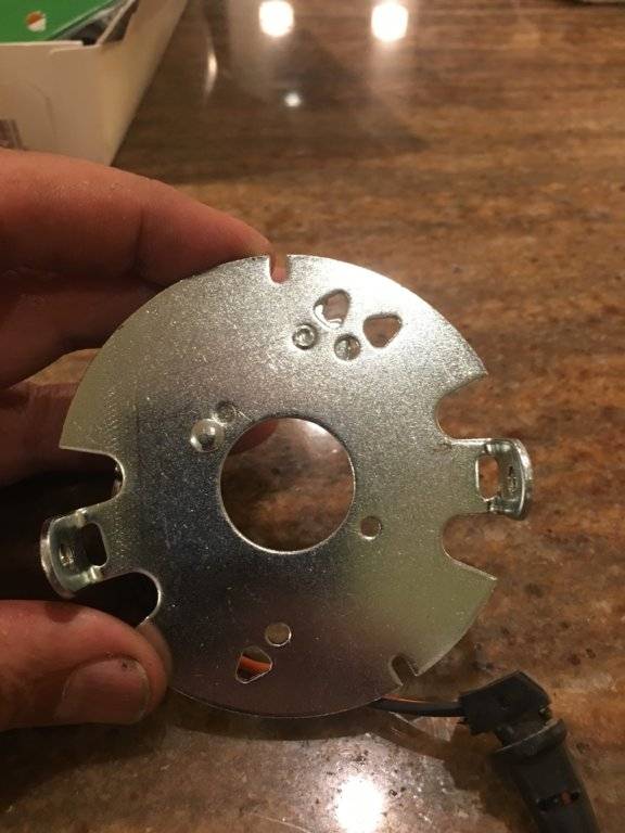

So.... I finished the carb and put it back in. Started it and same as before it’s still backfiring and running like ****.
I loosened the distributor enough to turn it but with enough drag to hold it. To check and adjust the timing.
Put the timing light on it and it’s flashing intermittently...... not a regular pulse.
“No”... I said.... “it can’t be! It just can’t be”.
Check the resistance on new pickup coil and.... 350 ohms....perfect!
Check the gap.... it’s a tight .008”
Nothing to do... but; pull the distributor check it, and if inop put the old pickup back in to confirm. (Btw, I’m getting going at pulling it out even hot)
Put the distributor on my bench vise and hooked the multi meter on continuity to listen for the pulse and there it was just like Morse code not a continuous buzz...
Put the old one back in (checked it; it buzzed) to move the car while I get another pickup coil. Set it to the picture I still had and turned the key. The engine fired on the first turn and as smooth as before.
F—k me!
That damned bad pickup cost me a brand new muffler.
Pissed.

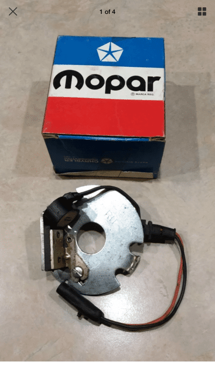

Doing a little research on the pickup coil.
Seems there is a right hand and left hand for them or a separate part number I’m not finding.
Part number I can find is 4091147.

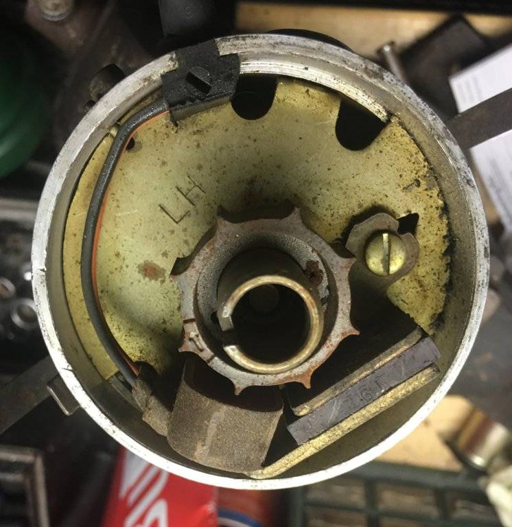

Look:
This is the one out of the car that I just put back in. On this shot, you can more clearly see that the coil lines up exactly with the mounting screws. It’s clearly marked LH.
This is part number 4091147 it’s marked RH and the alignment is off or just different.
No way to set the timing because it’s still indexed to the cap differently from what I have.
From the back you can see it has two places it can be assembled... ok so I’m not crazy.
Easy option would now be to get a good pickup coil and install it on the old base with a rivet.
LH vs RH..... where have I seen that before????
Why would Chrysler make two differently indexed pickup coils?
Dave? Could it be different spark control computer timing settings? Curious.
