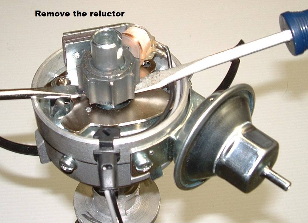

Pulled the distributor.... no problem.
Reluctor came right out.
Removed the pickup coil
Installed new pickup coil set the gap to .008
Reinstalled the reluctor
Cleaned the outside of the distributor

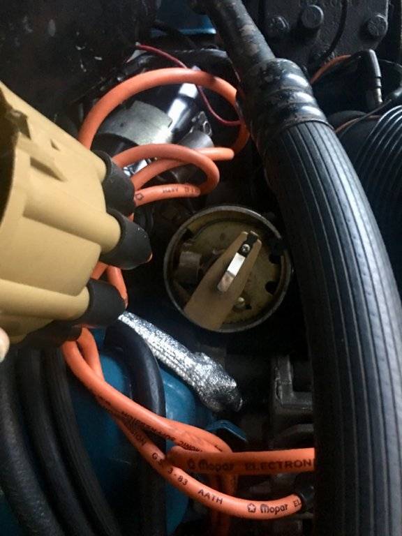

Reinstalled the distributor against photo I took to make sure to put it back the same way.

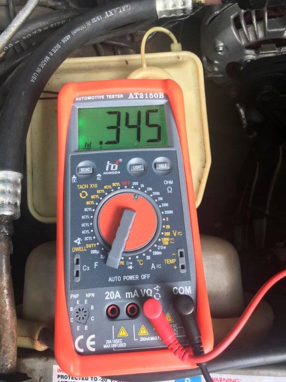

Checked the new coil... 350ohms.... perfect
Checked the gap.. good

Took the old pickup to see if it was exactly the same..... nope.
It was indexed about 15 retarded in comparison to old pickup
DAMN!

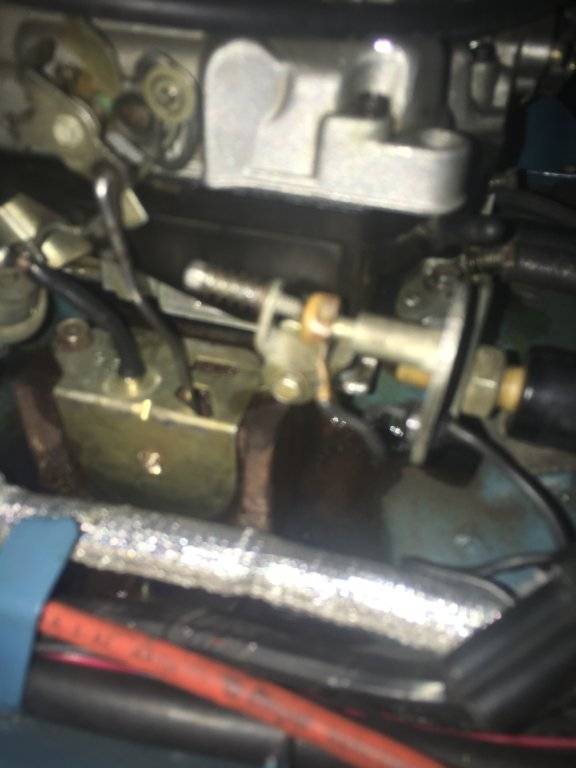

Ran like **** and and I was still smelling gas. Moved my light and gas was pouring out the passenger side of the carb from the bottom. Main well on that side must have completely let go. Should have pulled them both and reset them in new epoxy.

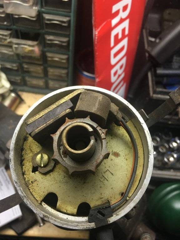

Reference picture to set back up.

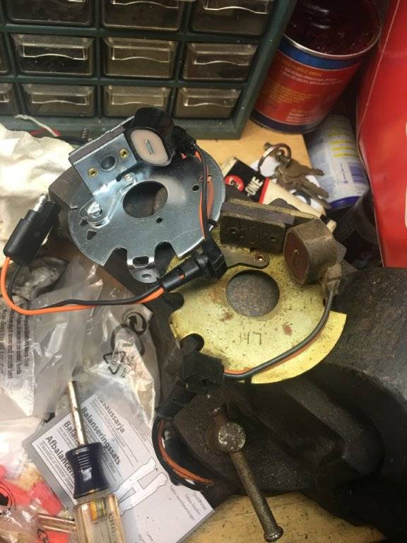

New vs old pick up.... you can see the difference in the indexing if you look closely. I didn’t even notice.... Damn!
Fuel pouring out the vent for the well. On the older carbs, there is no vent so the wells can leak and you’d never know.

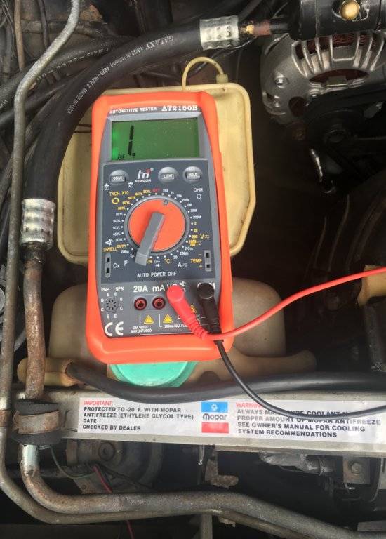

The old pickup worked fine until it got hot.
Here’s s the proof....
After a good run and about 1/2 hour after shut down and good heat soak.
After it cools off for about an hour and a half.

Bummer, those reluctors will go on either way (upside down ) sometimes it helps with the rotor to cap phasing. Maybe that was why yours was off.
