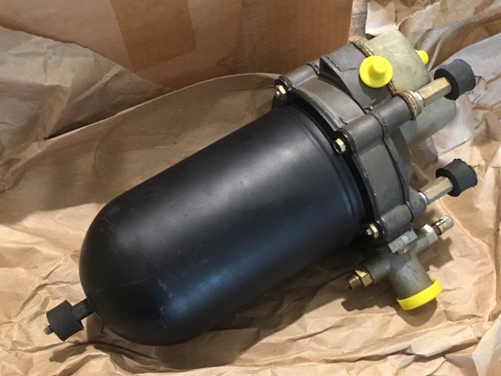

New to me 78 NYB on its way but please Don't tell my wife
I won't tell your wife, lol.
On a more serious note, weren't you concerned the NOS unit would have a dried out diaphragm?
Yes.
Which was why I kept the silicone diaphragm I got to repair the original unit. But, it turns out the diaphragm was fine.

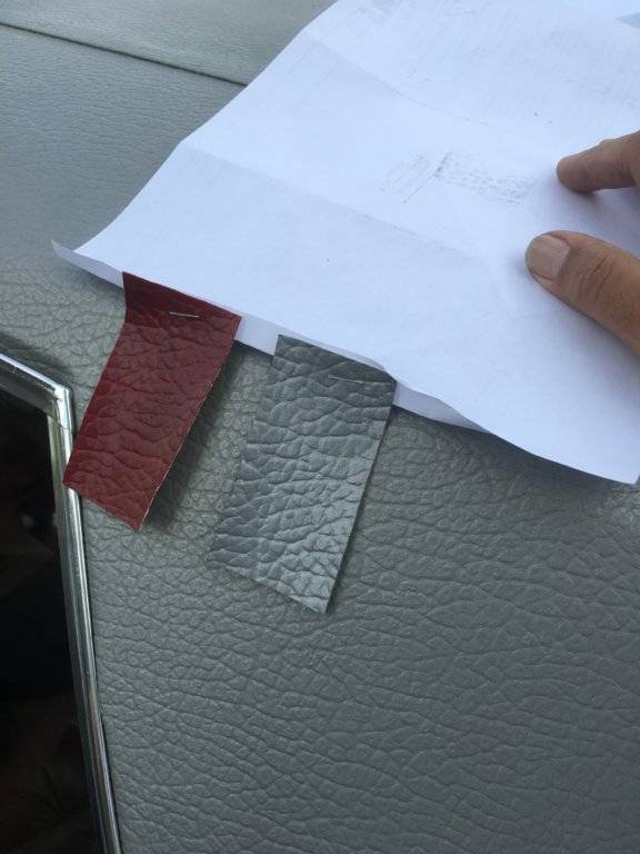

Top material selected and on the way.
5 yards of the silver ordered.
Daily quiz.... can you name this just arrived part?
Hint: not a mopar part. But it will be part of the “enhancements” planned for the Old Girl.

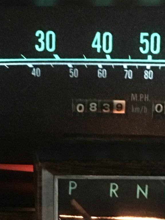

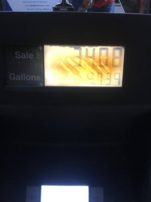

MPG today as I fill up with 90 octane non ethanol and also put in an octane booster for a few extra points and to test a theory.
83.9miles divided by 9.739 gallons = precisely=
8.61484752 miles to the gallon
or 45,486.39490707465 feet per gallon.
Seriously......raising the octane to assess the effect on engine vibration. Thinking that I may have a partially burned leaking exhaust valve that is getting hot and preigniting a cylinder causing the slight roughness under slight load I’ve been able to narrow down. More throttle (and greater volume cooling charge diminishes the problem. If not that then something else like a bad ring or cam, lifter, pushrod, rocker not doing a complete job. Could also be a blockage in the head that is limiting cooling. Hoping it’s just in the heads.
