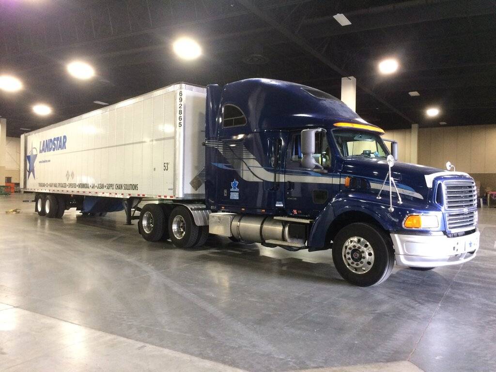

Here's some happy pictures.
My delivery from Carlisle to home yesterday, and one of my favorite parts of trucking. Flying J pizza.
