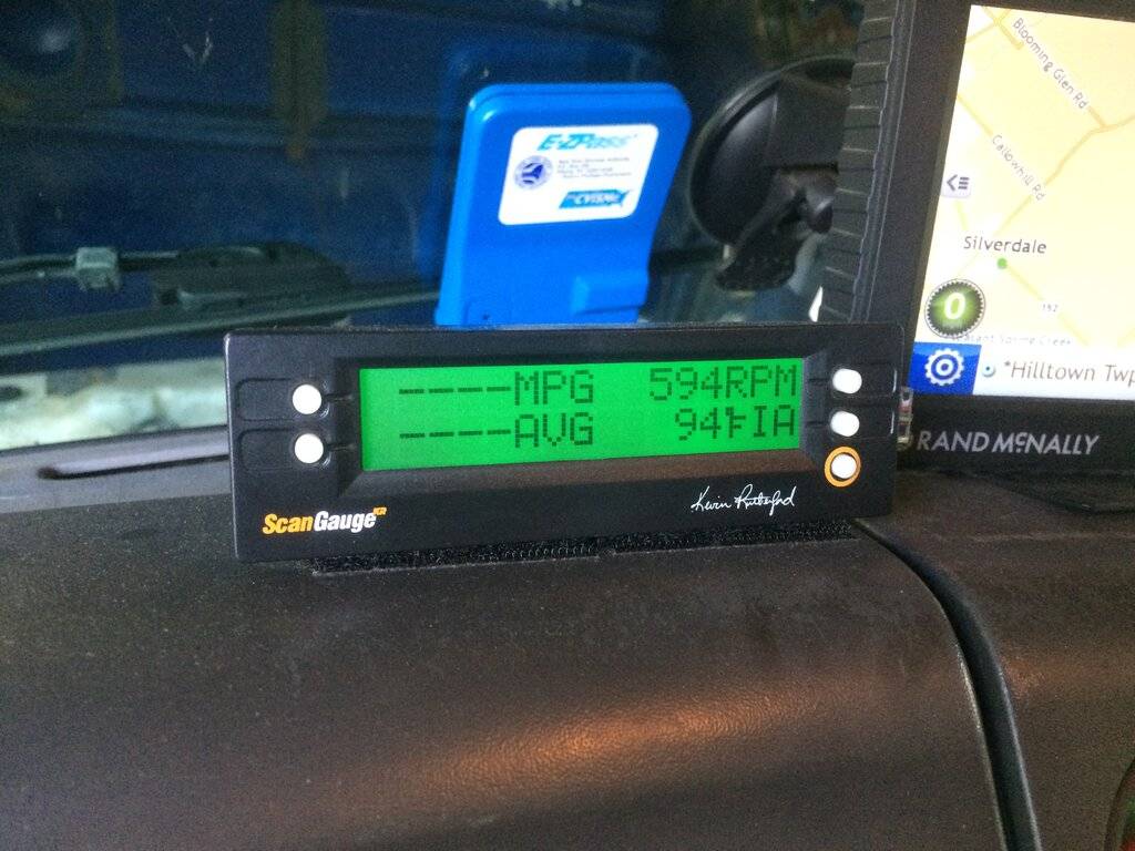

I bet that it’s the injector seat.When this problem first showed up, I think I checked every available readout on my scan gauge while it was acting up and none of them were abnormal, but I'll double check the air intake temp during this week's trip.

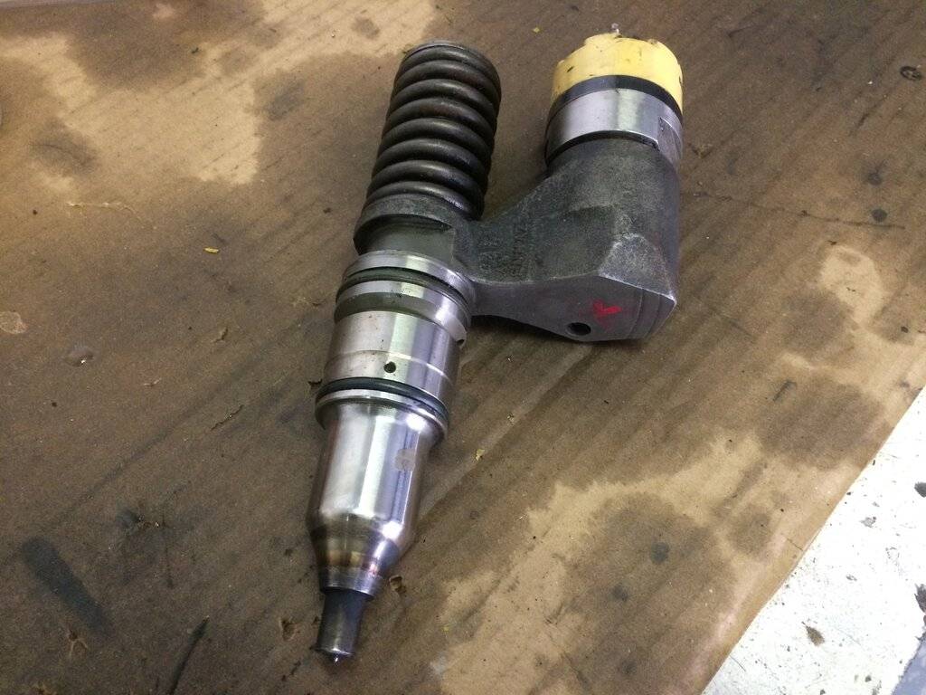

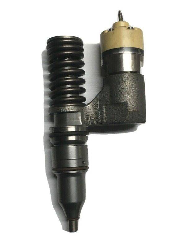

The injector that I bought off eBay that was described as likely to be remanned is crap. It's as used as used can be, plus it sat somewhere dirty for at least a decade. It's going back where it came.
eBay listing photo:
Actual part:

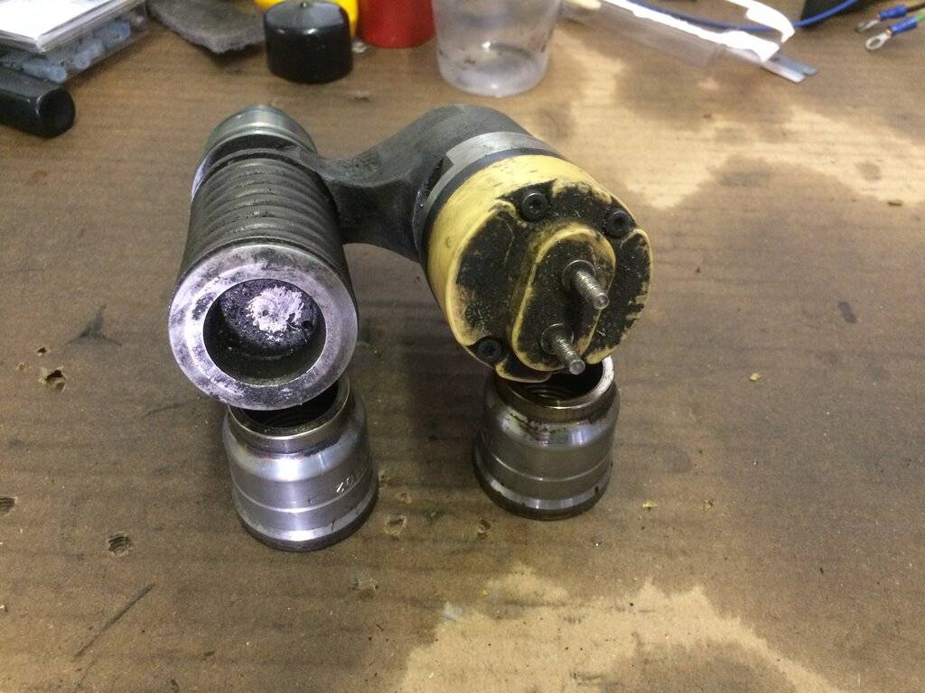

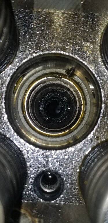

This is what a bad one looks like. The injector itself will also be eroded where it contacts the seat if everything started out new together.
You said something about missing or mangled Orings too. Make sure they are all Genuine Cat. I've seen aftermarket ones that don't stand up and they can cause no end of problems.

My seats looked pretty decent. I couldn't find a seat cleaning brush specific for the big CATs, so I rigged up a few different size wire brushes to get everything cleaned up nice. There were no signs of damage on the seats of the injectors, just the small, bottom o-rings were MIA.
I didn't spend the big bucks on CAT o-rings, since this thing won't ever see more than another 20K miles. I bought a set of US made o-rings on ebay. They looked to be good quality and actually had part numbers printed on the two larger size rings.
