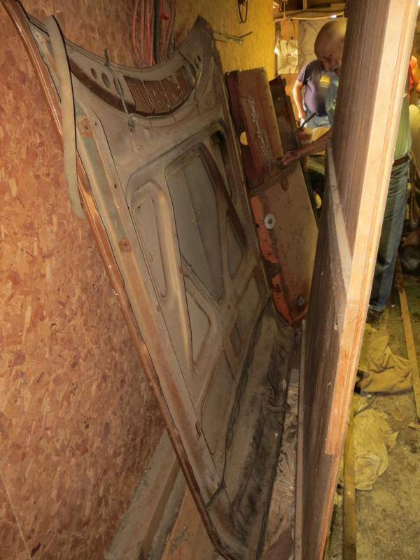

It is all one piece Mark which means yours is broken. That part is like the A arm shields and is/was reproduced
If you look close you can see the one on this hood and its from the same car....
Never mind. I thought you were talking about the front splash shield that covers the gap between the bumper and the lower radiator support.
so did I.........i don't see any air dam there Matt!
