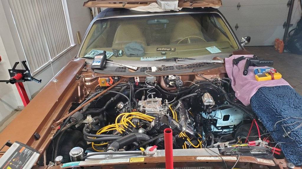

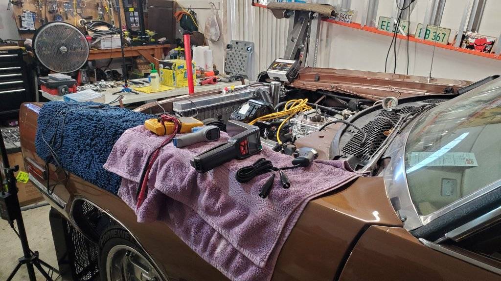

Getting closer! It should be ready tomorrow but I am trying to wait till this weekend to fire it up.

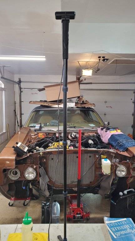

Well tomorrow is the day. I think I am all set to try and get her fired up. I will be filming this as well and will post the video after.
HOOORRRRAAAYYYY! After a stressful start up, the break in process has been completed. Here is a quick video of the first start after the break was done.

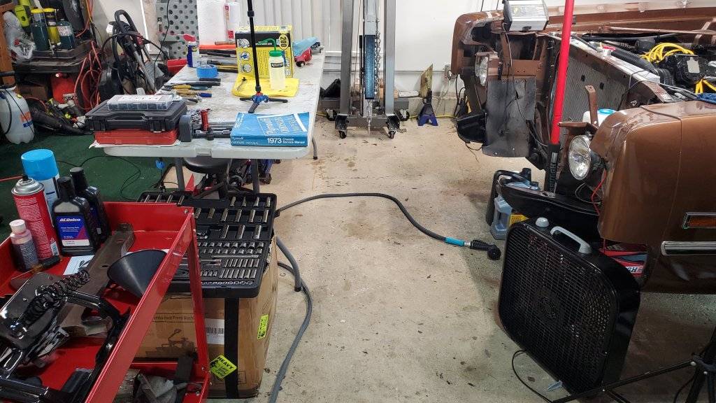

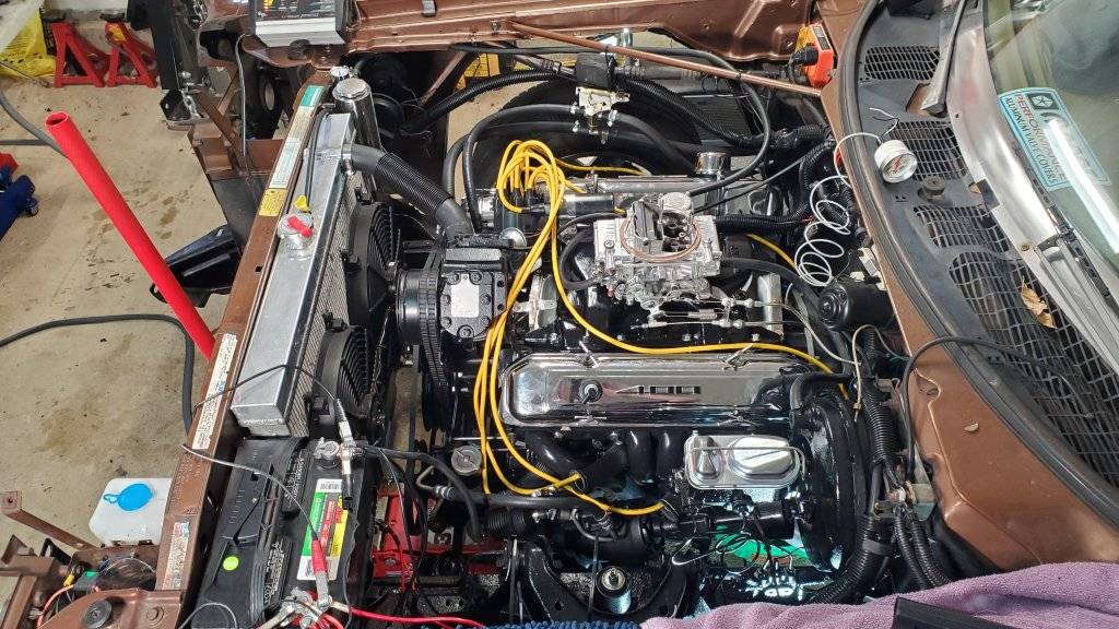

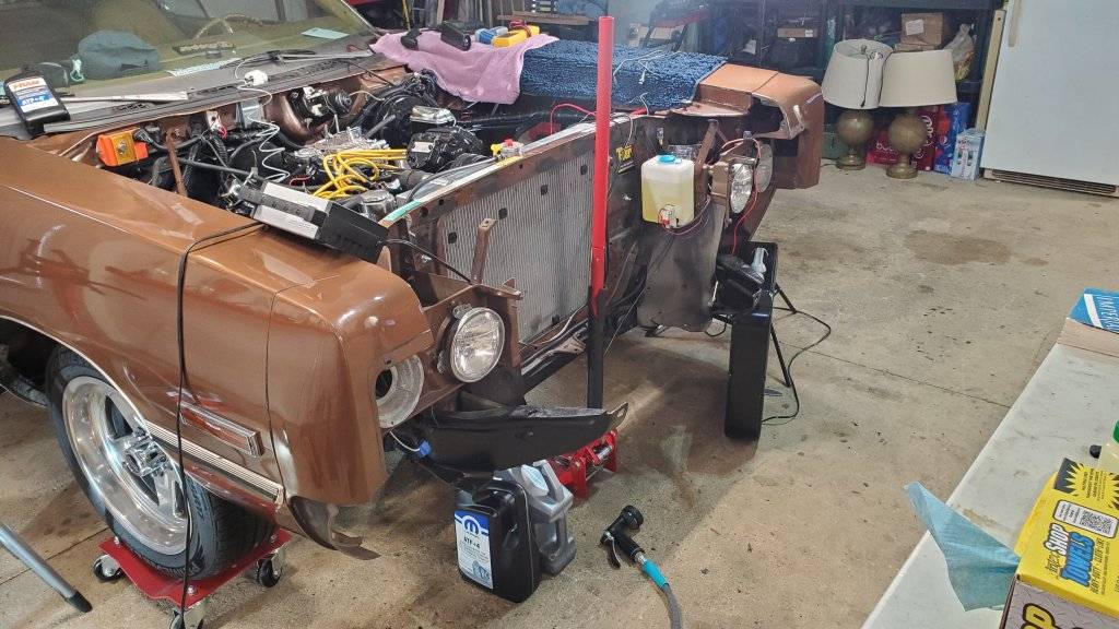

I have to wait to Wednesday to speak to my trans shop so until then, I am getting things buttoned up in case I need to tow it.

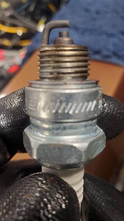

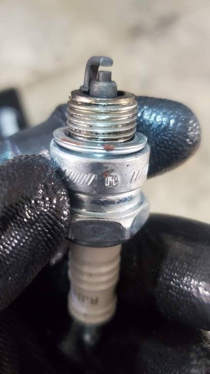

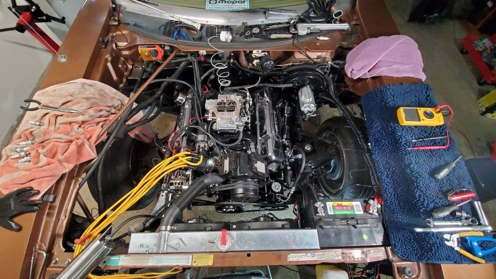

I remove the filter and pulled a couple plugs to see what everything looks like. The darker of the 2 plugs is piston #1 and the other is #4. I have only completed break in and started it a few times. How do these look?

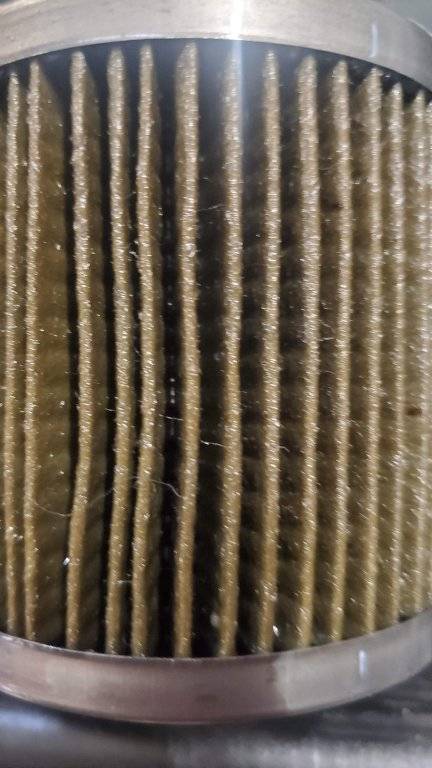

I also opened up the oil filter to see how it looked inside. There was some sparkles but not as bad as I would have thought. I assume this is good as well.

To me those plugs looked like it was running rich, I do a have fuel pressure regulator on it and turned it down from 7.5ish to 5psi. Im running a Holley 650
I ended up having the car towed to another shop, they already pulled the trans and checking it out. While it was up on the rack, I took a look at a leak I have at the back of the engine, I guess I should have filled up the rear main seal cap screws holes with silicone as you can see that the pan gasket is finding its way inside there? Weird.. However, while looking at this picture, I noticed a crack on that right side....... I went back through my pictures of when I put it together, which is like one page back in this post and you will see the same crack! I know its only on the outside of the cap but WTH!. Im not sure how I missed that. However, its not leaking from the seal or from that crack. I am debating on dropping the pan some and cleaning off any oil from those cap holes, then fill each hole up with silicone.
I bought a new cap from 440 source and while its up on a rack, I am just going to replace the cap and bottom part of the seal to be on the safe side.
