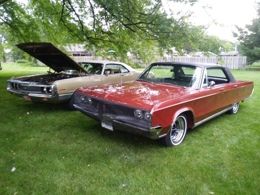

2.94 behind a warmed over 383 bored .40 over 268 Comp cam shift kit and light stall..
Tons of highway at 70-80 MPH all day.
My point is the 440 will have more than enough torque to turn the highway gears.
As long as you do not run out of highway and how big your balls are you just might find top end!! LOL!!
750 miles 15 hours is just one of the "normal" drives the BoaB does,LOL!!
(From the FCBO show last summer Volo IL) Tim's NYer is now under construction..

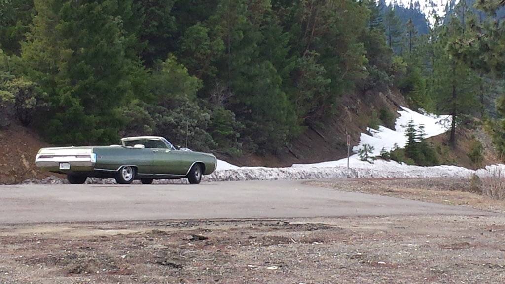

Oh yes. Drove to Dunsmuir, CA, to have lunch with Dave (Carmann) last Spring. Car runs well. With the 440 though, it will never get good MPG. Best I've ever seen is 15. Average is 12 on the highway.
I put 3.23s in it for a short while. Went back to the 2.76 gears, only dropped in a SG unit instead of the original one-legger. Other than a slightly quicker acceleration I saw no advantage to the 23s.
Picture is from a drive I took in March, '17. Drove over 300 mile round-trip one Friday. Had a ball!
