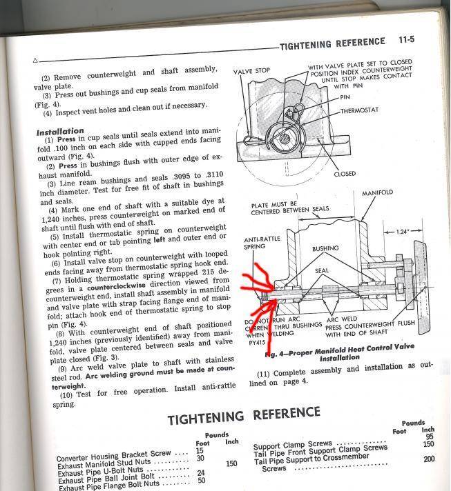

Spent the morning at an exhaust shop with the car up in the air and found this......there is a leak at the buttery fly valve in the bottom of the pass side exhaust manifold. It appears the bushing/seal(?) around the shaft where it comes out has deteriorated enough to allow fumes to escape and that's what's making all the racket and smell. Now that there is something I've NEVER seen happen. Seen those valves stuck in one position but never letting fumes escape through the shaft hole. Got some decisions to make. Open to suggestions.
That's what I should have and still need to do on my Imp.. It would have been much easier to do while I had it off....
Tell me about. I had both manifolds off just a week ago. Finagling the pass side manifold to come off and out is a B-I-T-C-H.
Tapping the holes and using a NPT plug is a good idea. I'd stake the threads to keep them from loosening. Loctite won't work well where it gets hot like an exhaust manifold.
IMHO, you don't want the valve. Today's crap gas really doesn't seem to like the additional heat in the intake crossover.
