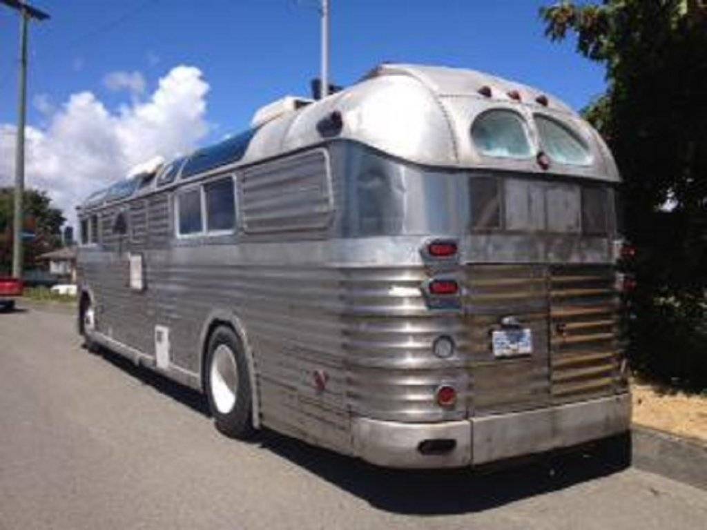

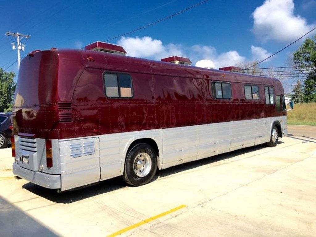

Then it became more important to understand the history of that coach to determine the extent to which it was structurally overhauled in the decades since it was retired.

What is raising my eyebrows, is can I really ascertain whats going on in the "bones" of these old coachs WITHOUT doing the equivalent of a "frame-off" inspection? My feeling is YES, but all the fatigue issues may NOT be evident.
I am comforted by their "million mile" body designs .. but they coulda be REALLY hard miles. I am gonna look into what the airplane guys do .. the folks flying WWII fighters, DC-3's, Lockheed Electras -- with this issue. Do they rebuilt the airframe?
