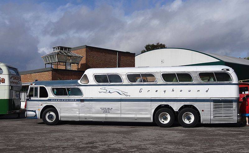

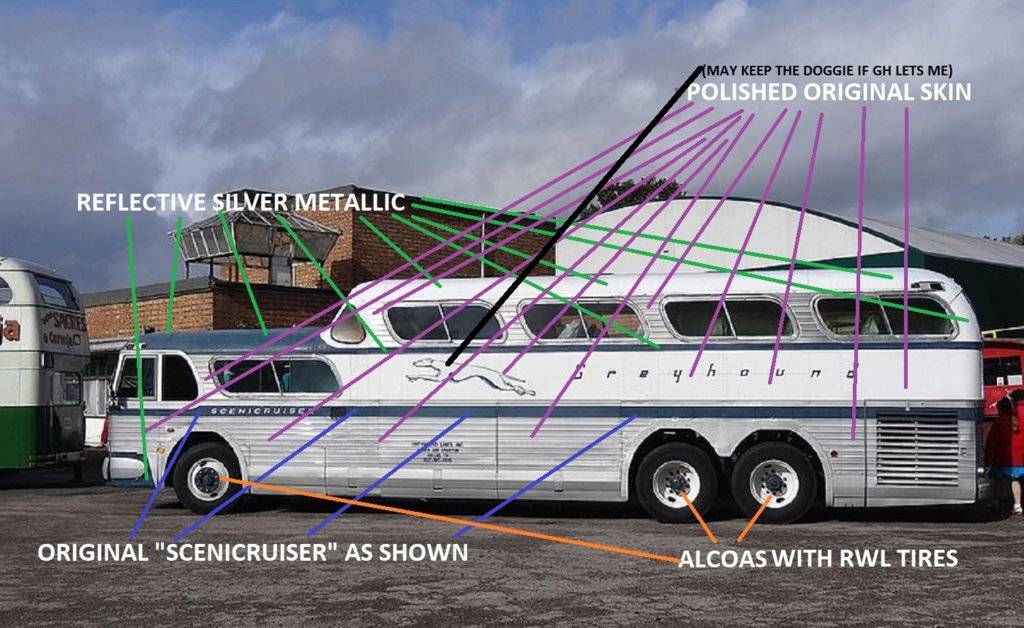

Here's the look I am after .. like a "silver bullet".
May change mind in 2 years, but I also wanna go with grey/"greyhound blue" accents interior (Whisperer's wife has neat ideas cuz I dont know crap about that really). Lobbying the Whisperer hard to let me keep ALL windows - gotta get "creative" tho ... sometime late next year/early 2020 after mechanicals get done.
Hoping to keep a clean roof look .. no AC units roof mounted. Whisperer frowns at that idea ... :(
Comment away, but EZ with the "rocks" ok? :)

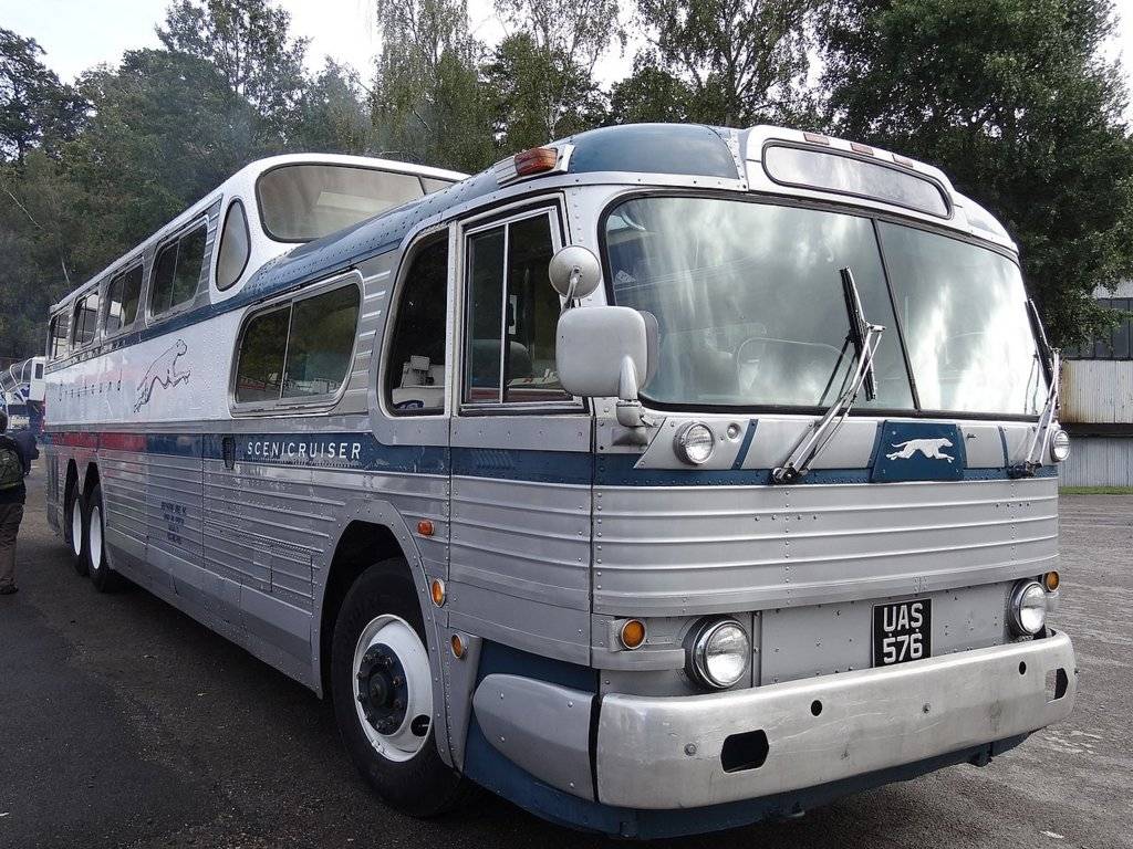

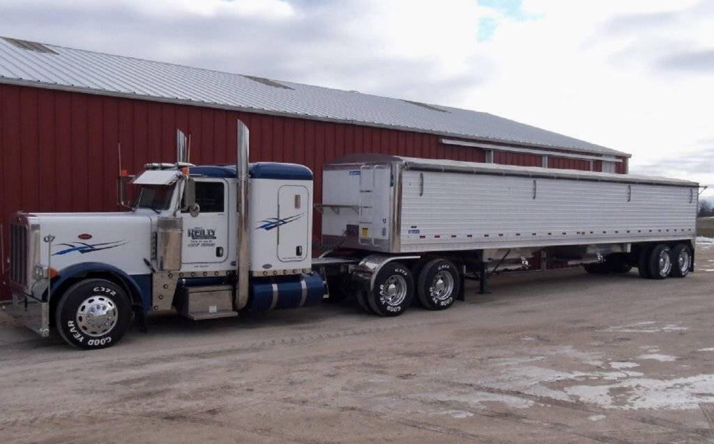

The older bus in second photo for my inspiration - I like "Silverside" cousins/contemporaries of PD-4501. Yes, RWL tires on a big truck (i know, just ticked everybody off but if i dont like it as much as I think, i'll flip 'em around and keep on bussin') :)

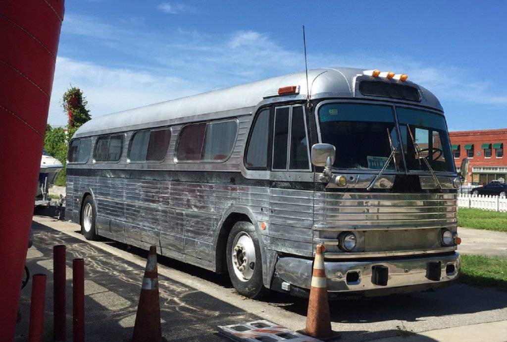

yeah man ... shell is all stainless steel tho even under the paint, i believe it'll clean up NOT to a driver distracting mirror finish but shiny enough, then cleared to fight off oxidation/etc.
