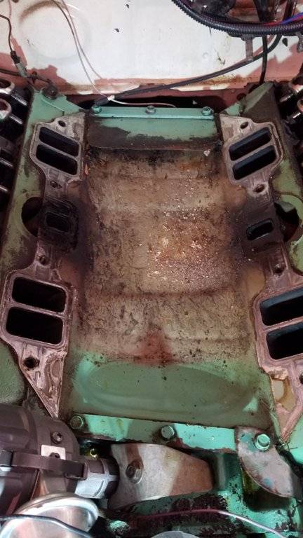

Very true, If I remember correctly didn't they also not use exhaust manifold gaskets as well, or was that pre 60's? From this pic, it appears they didn't have any gaskets on the intake manifold either. It was 4 degrees with the garage door open, so once I got the manifold off it went right on the floor and I went inside lol.
Yes to all the above, no gaskets.
There were no exhaust manifold gaskets, intake and heads used the embossed steel as seen on the above valley pan gasket. No paper or fiber gaskets were used, if that was your meaning.
Yes kinda, I would have thought by now with 128k miles someone would have rebuilt her and placed gaskets which leads me to believe that she hasn't been touch for the very first time ~ Madonna like a virgin lol
