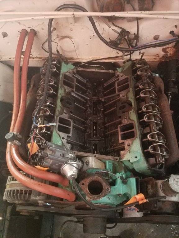

So far got into the rockers etc.. only evidence that the motor has ever been touch was a found a lifter upside down lol
Did you mean pushrod instead of lifter? When I tear down an engine, I use ziplock bags to put the parts into and tag them for later reassembly, ie intake bolts, water pump bolts, etc.. Saves you some grief later especially if reassembly is done months (or years) later. I also take a lot of photos which can be helpful with things like bracket positioning, wiring, or if something gets installed a certain way.
Yep I have tag/bag the stuff;) one of the push rods were upside down on cylinder 8 is what I was getting at.

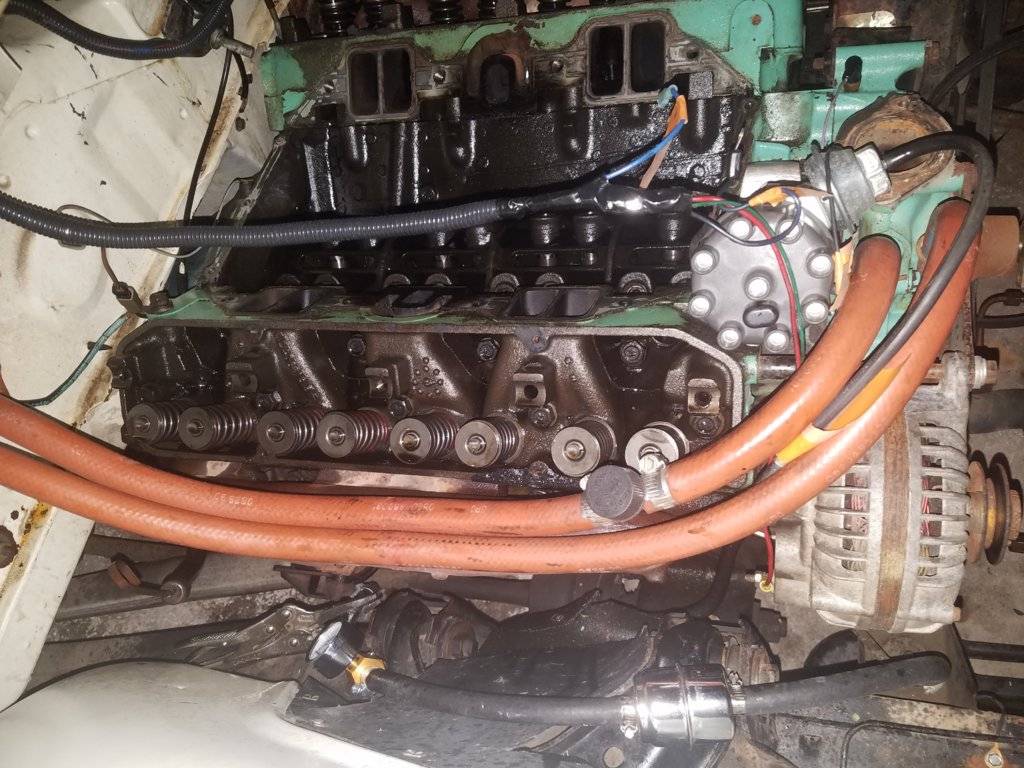

I know some may laugh bc you wrench all day or have been for years but it's been at least 24 yrs since I've done so. What a feeling to help teach my son as we go along. I so appreciate all the help that I've gotten from you guys. We're down to removing the bolts from the heads which will be this week;) Got the exhaust dropped and I even sprayed liquid wrench to help try and get them a little looser ;) I've forgotten how many bolts there are lol

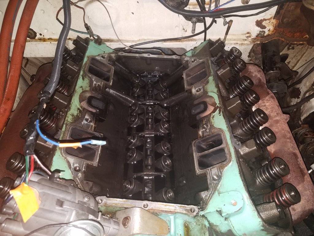

Hey guys quick question... when I got down to the heads, the oil on the heads and in the (bucket) of the block under the intake and between the heads was dark oil black. If I had a head gasket leak, would i see chocolate color oil? The reason I ask is when I drained the rad the antifreeze was that color and I assumed the engine oil would be the same .
Normally yes. Right now you are trying to find where the oil and antifreeze are mixing. Again, take the heads in and have them checked for cracks and warpage. This is cheaper than the engine block. If the heads are good, time to decide on the next engine. At this point find out what the problem is BEFORE you spend a lot of money.
Agree, I was planning on pulling them tomorrow and posting some photos as well. I also plan on checking the warpage on the block as well.
