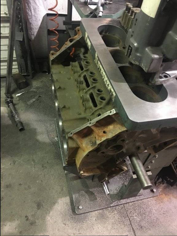

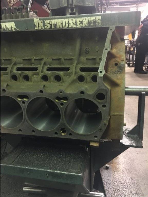

Well I thought I had a forged crank 440, but the block had a couple of bores pitted so bad they needed sleeved. What the shop DID have was a few 400 blocks laying around. So, that 440 crank and rods are going into a 400 block and I'll have a 451. Machine shop will dyno and tune it for me, and recurve the dizzy as needed. 3500-4000 in cost.
